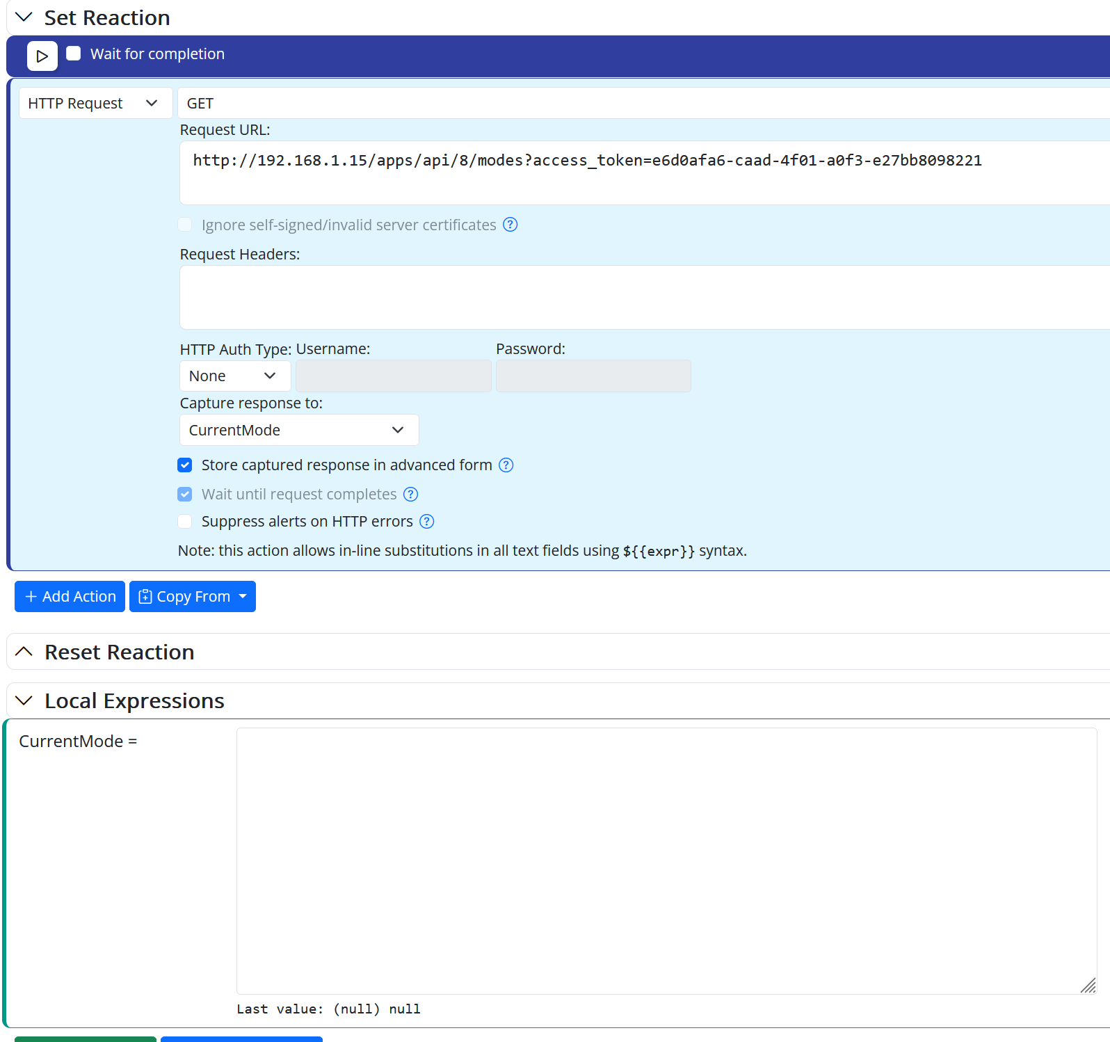

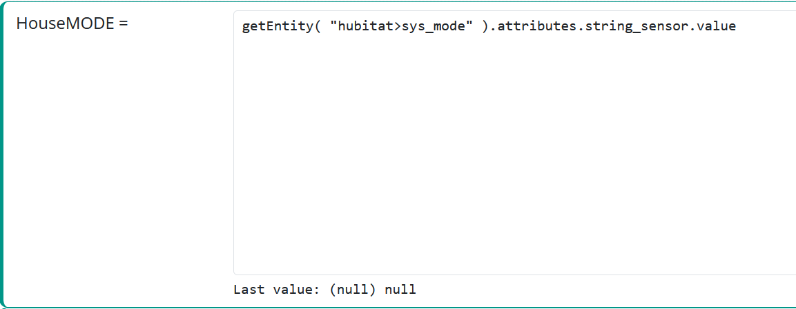

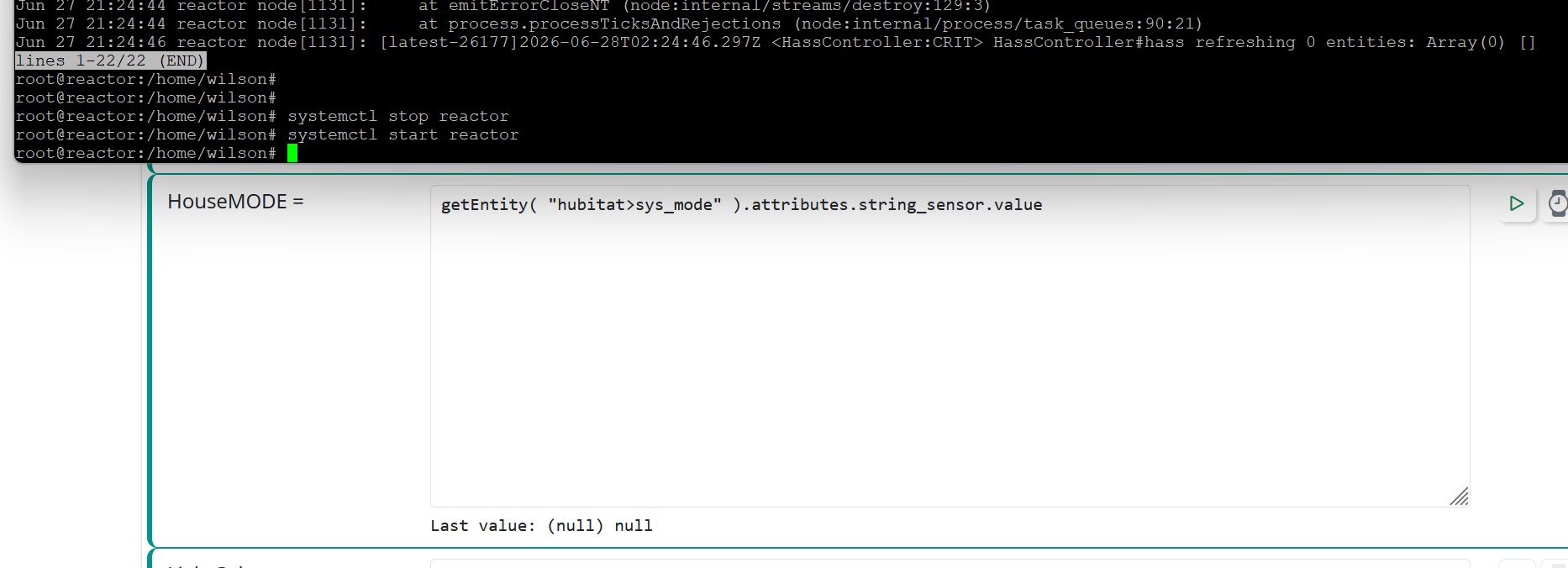

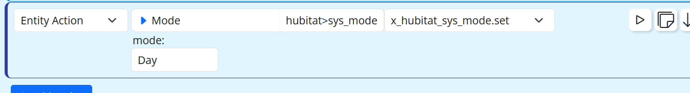

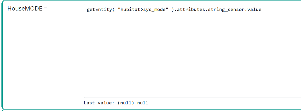

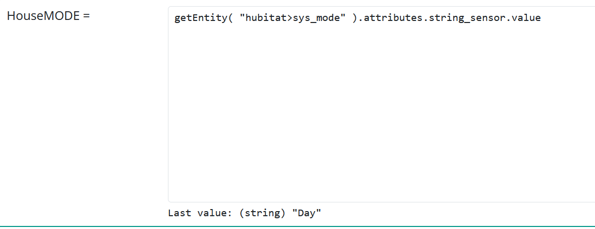

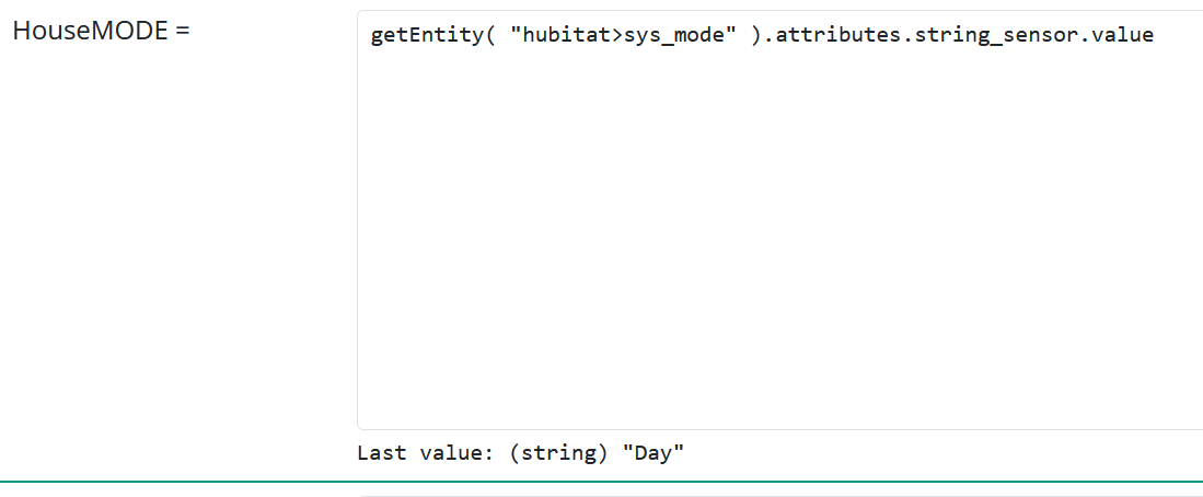

    Hi @toggledbits
    Up to version 26130, this statement worked perfectly to update the global variable.
    It used to assign the mode correctly to the variable.
    However, now, when I restart the system—which is already on version 26174—I see that the value reverts to null, forcing me to change the mode so that the status is updated.
    If it is NULL, this action also has no effect.
    Thanks.
