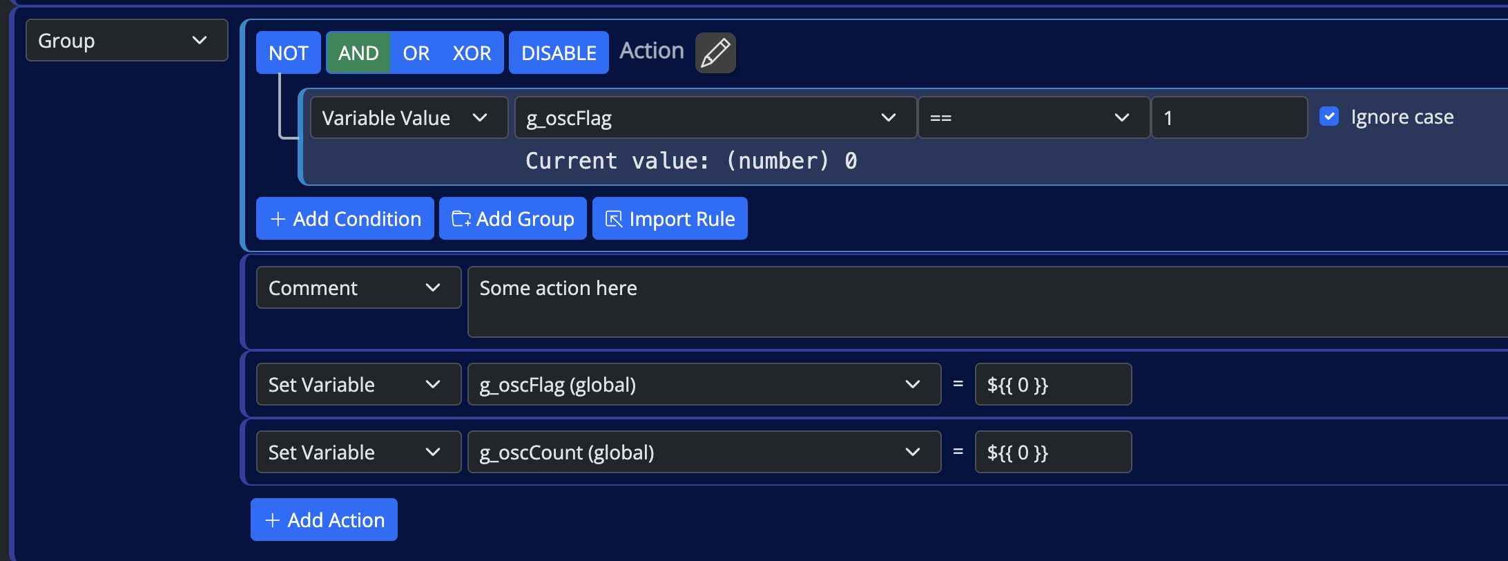

    One local variable called osc_timer_armed and two global variables (g_oscCount, g_oscFlag), these are all expressionless. Originally all of these were local, but that didn't work so now trying with globals as well.
    The logic is that if there are at least 6 "pulses" (0 or 5.8 Hz) within a 30 minute time window, rule would then execute desired action (e.g. a notification).

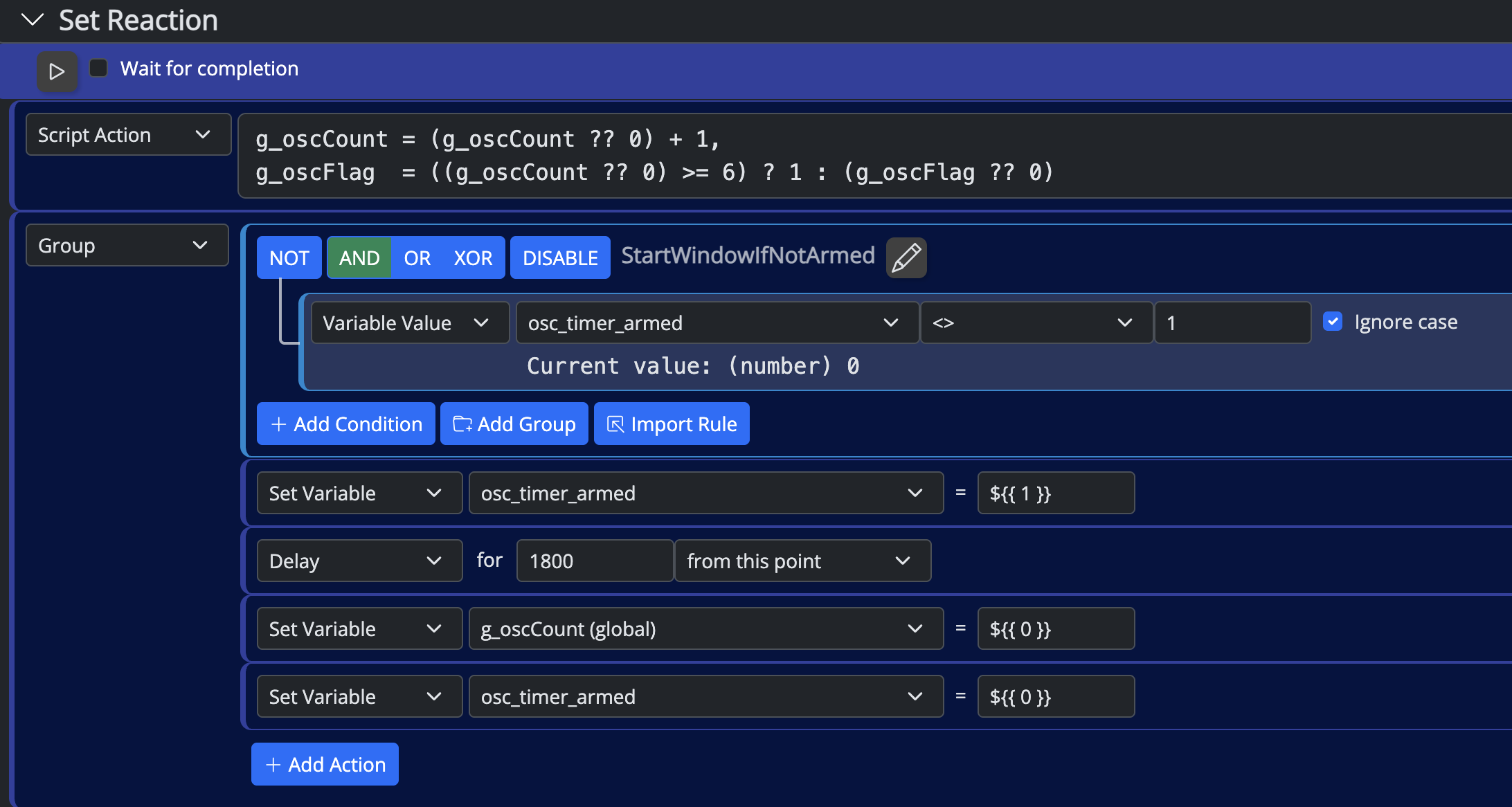

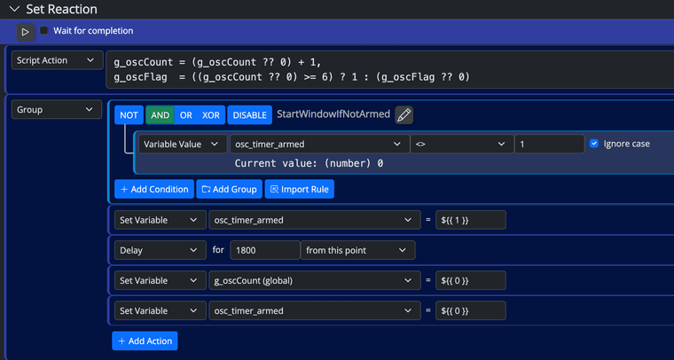

    Set reaction is:

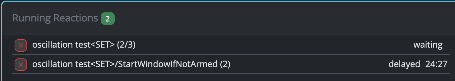

    The problem is that I'm never getting to the action part (group called "Action"), as g_oscCount is not updating past 1 (and therefore g_oscFlag is not set either). First "instance" of this rule is running for 30 minutes, but g_oscCount does not increase in subsequent runs.
    If I'm manually running the set reaction during this waiting (delay) time, I get the following runtime error on UI:
    Error: Command timeout (1398 start_reaction)
        at _ClientAPI._commandTimeout (http://192.*.*.*:8111/client/ClientAPI.js:546:201)
    My hypothesis is that the first instance of the rule (running reaction) is locking these variables and other instances cannot modify them? Although could this even happen with global variables?

          Ahhh... I see what you're getting at...
          Move the actions in StartWindowNotArmed to an independent Reaction (in the same Rule Set), and have StartWindowNotArmed start that Reaction without waiting for completion. That will allow the Set Reaction for the rule to keep executing and find the Action group on each pulse. That will also require osc_timer_armed to be global, since an independent Reaction can't touch local variables inside a Rule.
          Make sure your Reset Reaction is completely empty, not even a comment. This is important, because if it contains anything at all, the reset caused by the pulse will interrupt/cancel the Set Reaction.

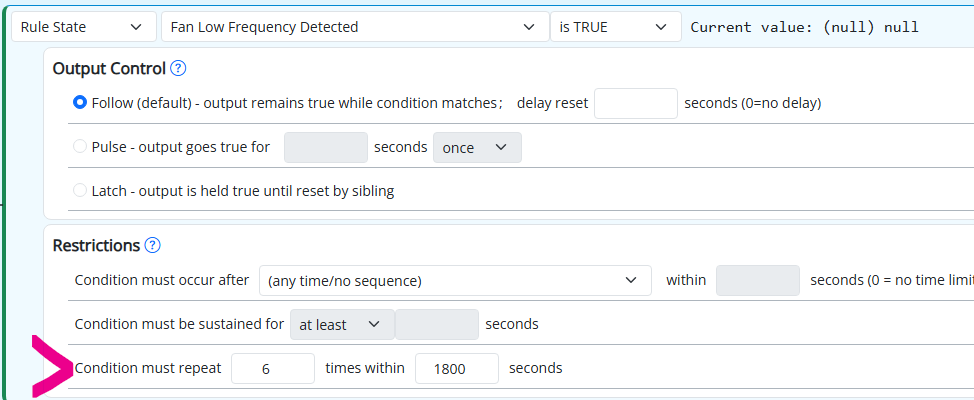

          And you are correct! My error... in the case of Rule Reactions, the Engine already knows the Rule's Set Reaction is running, so it won't stop it, and it won't run it again until the Rule itself goes through the Reset state. The UI error message cause is still the same regardless (the running Reaction doesn't finish within the UI's waiting period for a response.
          Of couse, you might be able to avoid all of this complexity by simply having a Rule to detect the low-frequency oscillation (pulse output -- the conditions as you have them will probably work) with no actions at all, and a second rule with a Ruie State condition looking at the former and using the "must repeat 6 times within 1800 seconds" condition option...
          Edit: I think you can just do it in one rule, too, if you group the two conditions and apply the pulse on the group rather than the conditions individually.
