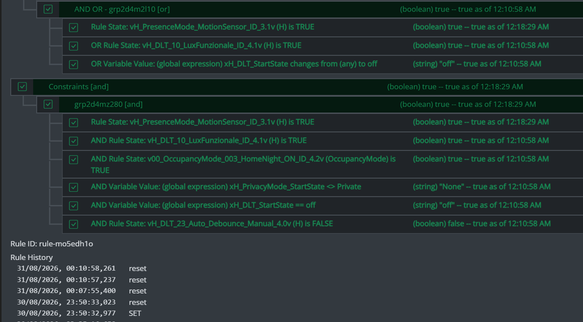

          A couple of things here...
          • Editing the rule will cause re-evaluation, which is likely why you have repeated RESETs in the history with no SETs between.
          • As hard as I try, and I keep looking, finding, and fixing, the UI can get out of sync with the running engine/service, so always hard-refresh when the UI isn't making sense.
          • If a Rule has been edited, especially multiple times, and it's not performing as expected, reset the Rule. There's button for that: 43f46006-5e40-4dd8-a7a3-82fffc3e5849-image.png Even restarting Reactor doesn't do what this button does.
          • Beyond that, it would also be handy to see the top part of the screen shot that has been cut off (the Triggers group heading and stuff above it).

            Thanks for the reply. I tried again, the rules driving DLT have the same logical structure in every room and no one is working.
            Tried the Reset Rule button specifically (not just re-editing conditions), plus a hard refresh (F5) beforehand, plus Reset Rule on every rule this one depends on (the Motion/PresenceMode rule, the Lux rule, the OccupancyMode rule, the Debounce rule) — not just the affected rule itself.
            Clicked Reset Rule, got a fresh reset entry in Rule History, then a genuine motion event ~10s later. The condition tree updated correctly in the UI (Trigger OR-group and Constraints both show true, timestamped at the motion event). The rule's SET action turns lights on directly. That light did not physically turn on. Also if the UI can be out of sync with the display, a physical device action should be executed. Rule History still shows no SET after the reset entry.

              In the first image, the triggers show true as of 9:42:09. The constraints show true 10 seconds later. That's a not pass. The constraints have to be true at the instant the triggers are also true (or before), or the rule does not SET. If the constraints become true later, that doesn't matter, the rule does not SET.
              Your third image shows the same. Triggers true at 10:31:53, but constraints didn't go true until 10:32:12 (19 seconds later).
              From the docs:
              N 1 Reply Last reply

                  @toggledbits Trigger OR was the problem and not identical internal condition/group ID as I suspected. AND is the fix. With the old OR setup, the problem was that the trigger had already fired, registering as "true" for a different reason (Lux), minutes earlier. So the photo captured by the trigger was outdated.
                  Thanks again for the push in the right direction!
