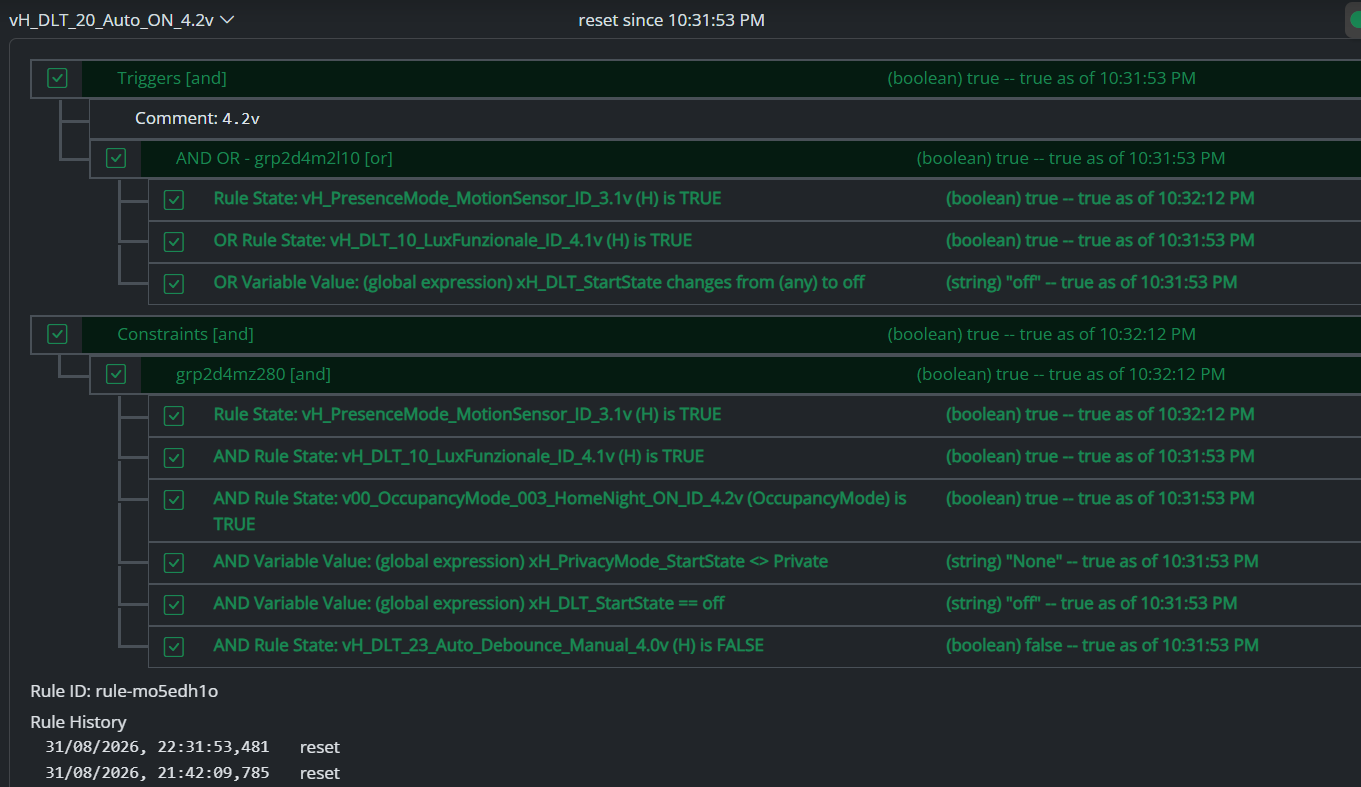

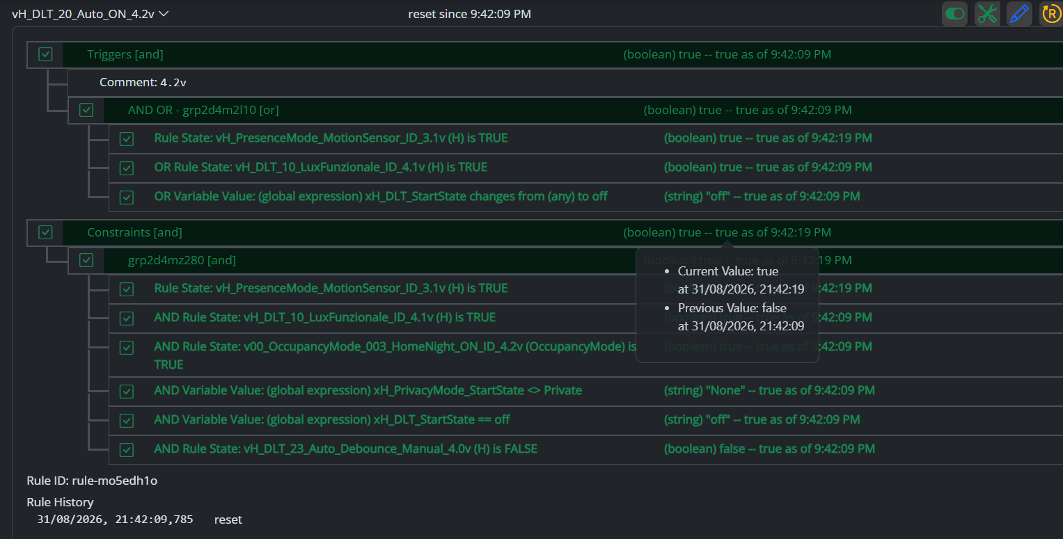

              In the first image, the triggers show true as of 9:42:09. The constraints show true 10 seconds later. That's a not pass. The constraints have to be true at the instant the triggers are also true (or before), or the rule does not SET. If the constraints become true later, that doesn't matter, the rule does not SET.
              Your third image shows the same. Triggers true at 10:31:53, but constraints didn't go true until 10:32:12 (19 seconds later).

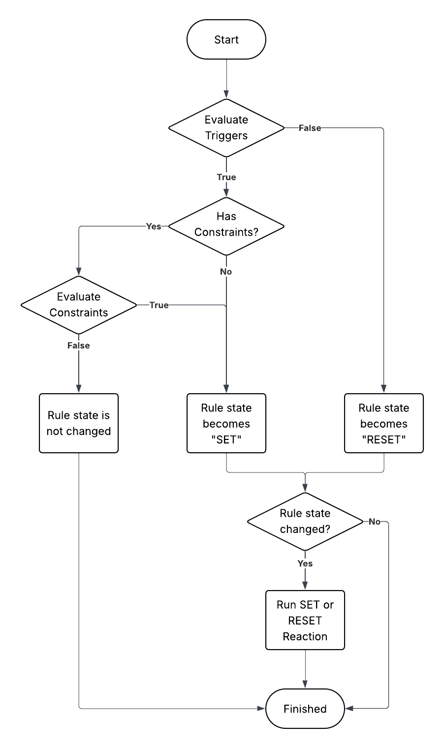

              From the docs:
              N 1 Reply Last reply

                  From the docs:

                  wrote last edited by
                  @toggledbits Trigger OR was the problem and not identical internal condition/group ID as I suspected. AND is the fix. With the old OR setup, the problem was that the trigger had already fired, registering as "true" for a different reason (Lux), minutes earlier. So the photo captured by the trigger was outdated.
                  Thanks again for the push in the right direction!
