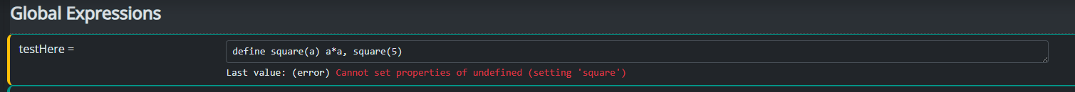

        It's all in the attached image.

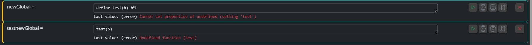

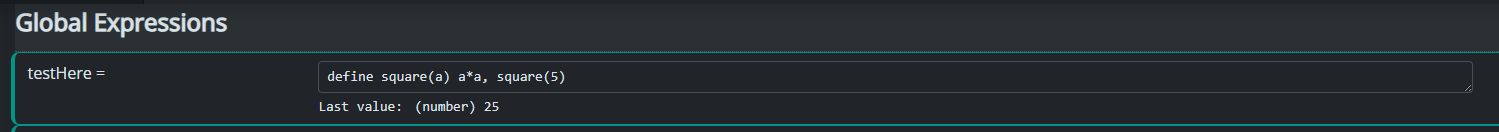

            This is the behavior between the the versions
            25208:
            25208.PNG 25304:
            This is a test in 25304 I created just now with new variables never existed before.
