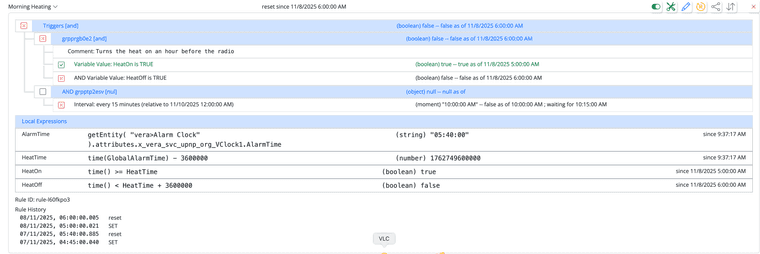

    Current set up: Bare metal (virtualised) on Debian 10.2
    MSR 25310
    Updated over the weekend and two reactions that have worked for literally years have changed. I'm pretty sure it was due to the 'nuances' in previous versions of evaluating global variables, so just looking for some help to 'fix'?
    I have two reactions that are dependant in large part on the global variable GlobalAlarmTime This is set in the Alarm Clock plugin of Openluup.
    One reaction turns the heating on one hour before the alarm goes off. The other turns the outside lights on one hour before the alarm goes off.
    Typically I change GlobalAlarmTime depending on the day of the week and the plans of the day ahead.
    GlobalAlarmTime is a string, current value (string) "05:40:00"
    Local variable HeatTime is calculated:
    time(GlobalAlarmTime) - 3600000
    Currently that has a value of 1762749600000
    Which is (quite correctly) 04:40:00 GMT 10th November. It's this because I changed the value of GlobalAlarmTime checking stuff out this morning, and HeatTime was re-evaluated at 09:37:17
    The challenge that I'm facing is that prior to the upgrade, HeatTime would be re-evaluated every 15 minutes (triggered by the 'Interval' function and come midnight (or at worst 00:15:00) HeatTime would re-evaluate to time(GlobalAlarmTime) - 3600000 today (if you get my point)
    That update to 'today' no longer happens. So the heating never comes on.

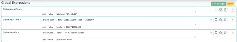

    I'm going to guess I need to use the new alarm function.
    I'm further guessing that I'd set up a new global variable to replace HeatTime and have something like
    GlobalHeatTime = alarm ( 900) , time(GlobalAlarmTime) - 3600000 ?
    Am I on the right lines?
    TIA
      TIA
      @CatmanV2 said in Help resolve change in behaviour post update:
      You're on the right track. If I understand your description, something like this should work (all globals):
      gAlarmTime = getEntity( ... )
      gHeatTime = time(gAlarmTime) - 3600000
      gHeatOn = alarm(900), time() >= gHeatTime
      gAlarmTime will be updated any time the dependent entity changes. gHeatTime will change any time gAlarmTime changes (reference to another variable creates a dependency on that variable). gHeatOn will be updated by the periodic alarm() tripping.
        Super. I think I can understand that. Will I see it updating in the logs?
          Yes, and on the Expressions page.

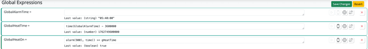

            @toggledbits Thanks so much
            I've now got this
            With GlobalHeatOn as one of my conditions in the reaction.

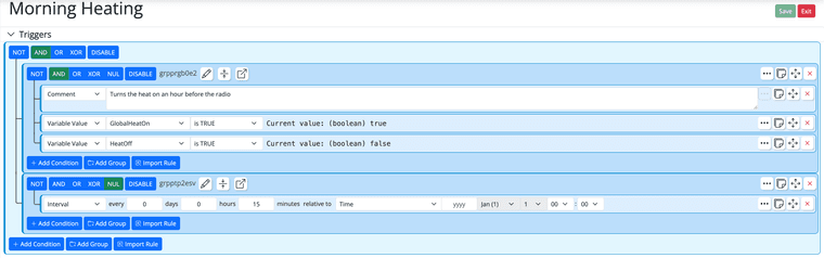

            My assumption is it will go false at, or immediately after midnight?
            I'm guessing I can lose the Interval statement as well?
            Cheers
              No. If your GlobalAlarmTime will always show time only (no date components), then you can safely add an alarm() call to GlobalHeatTime as well.
                wrote on last edited by CatmanV2
                @toggledbits Ahh super
                GlobalAlarmTime is never date (or I guess we'd not have this issue!)
                I do appreciate you thinking down to my level 🙂
                  I'm working for you. You also gave me an idea that I think could create a very useful alternative way to get to where you want to go. More to come...
                    Very grateful as ever. Looks like this is mostly working (although I also need to change HeatOff to a global variable to update. Expectation for tomorrow morning is good...
                    ... which is just as well as I will be away and Mrs C will be 'displeased' 🙂
                      Very happy that everything worked correctly this morning. At least for the heating. Just need to sort the outside lights, but that will be simple as the globals are in place.
                      Thanks again! More drams required 🙂
                        You should be able to go back to something similar to what you were doing originally, just in Script conditions. Give it a try!
                          I shall have a play!
