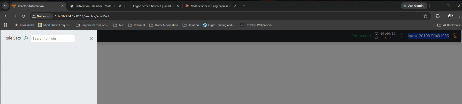

    Hello All -
    I was running an embarrassingly old version of MSR (26011) and just upgraded to latest-26193-50401535 bare metal.
    I've read the change logs and do see considerable drift so I kind of expected a few issues. I did run "npm run deps" prior to restart and have since ran it again just in case.
    Currently running node 22.2.0
    My rules apparently are running in the background. However, the UI doesn't show any of my "rooms", rules, reactions, or anything on the status screen. Thoughts?
