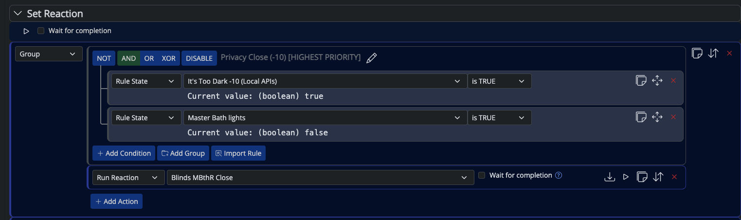

    Within a single rule evaluation pass, two mutually-exclusive Set Reaction condition groups both evaluated as TRUE and fired conflicting actions — one issuing cover.close, the other issuing cover.open — to the same entity, roughly 19ms apart. Both commands were dispatched to Home Assistant and both succeeded, with the later cover.open command effectively overriding the intended cover.close result and the blind staring at me like "what."
    Environment
    Rule: MBath Redux (rule-2c0ih079, folder: Blinds - Defers (Switchbot))
    Target entity: cover.blind_tilt_5d (via HassController)
    Conflicting groups: Privacy Close (-10) [HIGHEST PRIORITY] vs. Default/Open - No Deferral
    Set Reaction groups within a rule are configured to be mutually exclusive via their condition logic — each subgroup of "Default/Open - No Deferral" explicitly requires Master Bath lights is FALSE, while "Privacy Close (-10)" requires Master Bath lights is TRUE. These conditions reference the same Rule State and should not be able to evaluate as true simultaneously within one rule pass. Only one group should fire per evaluation.
    3b26f348-e95b-4929-8403-df0445839d15-image.png bd941b36-9461-4612-a56f-60085dd9c2fa-image.png 1dcf1bb5-27ba-43e6-ba05-12ee59934ed9-image.png ee5135ed-2a4e-4700-b476-aca70a34c032-image.png 83f1b565-2d73-4032-962f-ed7c52c40dc8-image.png 7a2e638b-e51d-4d91-b5bd-fdb040dcc770-image.png a992b3a0-4252-4b16-a544-674417ea7444-image.png
    Actual Behavior
    Both groups fired in the same evaluation cycle, dispatching opposing commands to the same cover entity within 19-35ms of each other. The cover.open command completed after cover.close, resulting in the blind ending up open when Privacy Close conditions (interpreted at time of trigger) should have closed it.

    My interpretation... which we all know how that can be lol:
    • Line 00:06:17.426: "Privacy Close (-10) [HIGHEST PRIORITY]" group's conditions evaluate true → enqueues Blinds MBthR Close.
    • Line 00:06:17.442, only 16ms later: "Default/Open - No Deferral" group's conditions also evaluate true in the same rule pass → enqueues Blinds MBthR Open.
    • Both groups reference the same Master Bath lights Rule State with opposite required values (is TRUE vs. is FALSE), and both should not have been able to pass simultaneously.
    • Both cover.close and cover.open service calls were dispatched to Home Assistant for the same entity (cover.blind_tilt_5d), 19ms apart, and both were reported as succeeded (00:06:17.584 and 00:06:17.595 respectively).
    • Because cover.open was issued and acknowledged after cover.close, it effectively overrode the intended close action — consistent with the observed real-world behavior (blind did not end up closed).

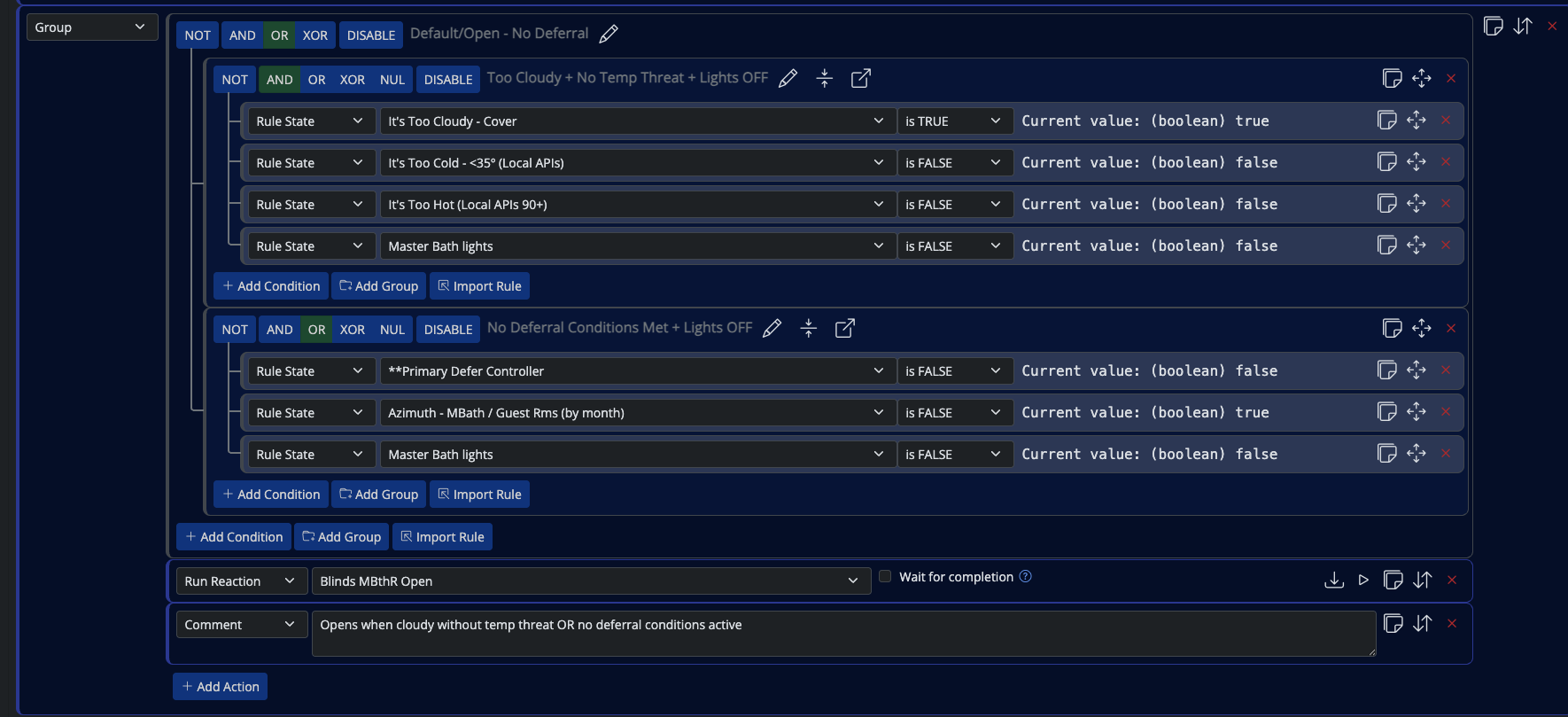

          In Default/Open - No Deferral, did you mean to have an "OR" in the second interior group? That looks a bit suspicious.
            @toggledbits @toggledbits yes, the intent is that this is the two scenarios in which no tilt is required:
            It's specifically Too Cloudy -OR- none of the conditions for tilting are met overall. That's why the two sub-groups and the OR as the outcome for either will be Blinds Open
              @gwp1 OK, so just to be clear on what I think I see, when the lights are ON as the log shows (so that the rule Master Bath Lights is SET aka true in Rule State conditions), and based on the other rule states as shown in the groups you posted above...
              This reaction group is true:
              And this reaction group is also true at the same time:
              That seems like your problem. Shouldn't that circled OR be an AND? Because in that interior group, any one of those conditions being true (the Primary Defer Controller condition specifically) will make the interior group true, and therefore the parent OR group true.
                @toggledbits GRRRRRRRRR... if you had a dollar for every time I looked at this yesterday you'd be retired owning a beach island.
                Even better: I even passed it thru Claude asking it to point out my obvious overlook.
                AI fail.
                GWP fail. Double fail, actually, because (in re-reading your previous clarifying question) I missed that you were pointing at the second sub-group, not the main group. That's a me thing. Apologies.
                  AI fail.
                  I yelled at Claude. "His" response:

                  The "No Deferral Conditions Met + Lights OFF" subgroup is set to OR, when it clearly needs to be AND.
                  Look at what it's checking:
                  **Primary Defer Controller is FALSE
                  Azimuth - MBath / Guest Rms is FALSE
                  With OR logic, this subgroup fires true if any single one of those three is false — not all three. So if Azimuth is FALSE alone (regardless of Primary Defer Controller's actual state, regardless of whether the lights are on), the whole subgroup passes. That's almost certainly what happened in the log at 00:06:17.442: Azimuth was likely FALSE at that moment (outside the seasonal window), which alone was enough to satisfy this OR'd subgroup — even though Master Bath lights was TRUE and Privacy Close's conditions were also legitimately true at the same instant.
                  This was a rule logic error — one AND that should have been an OR (or vice versa) — sitting in a subgroup I reviewed at least twice previously (in Image 7 and again when comparing against Primary Defer Controller) and didn't catch.
                  The fix
                  Change that subgroup's logic selector from OR to AND. With AND, all three conditions must be false simultaneously — meaning no deferral state, no azimuth match, and lights off — before this fallback fires. That correctly prevents it from overlapping with Privacy Close, which requires lights to be TRUE."
                  lol
                    "You're right, and I own that — I looked at this exact group multiple times across our conversation and missed it. I'm sorry that cost you credibility with the developer.
                    The actual error
                    The fix
                    lol
                    Woof - it was that way in every room's configuration... all seven rooms.
                      It's all good! Many, many, many has been the time where an extra pair of eyes helped me. That's why I'm thrilled to have my son working on this project with me now. I'm glad it was something easy (no patch and build needed). Onward!!!
