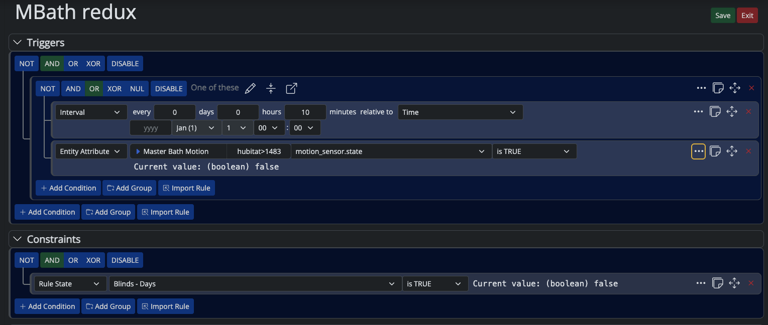

    Hi Patrick,
    For as long as I can remember, I have red x's instead of icons in MSR.
    I am running MSR in Docker and am on version 22252. If hosted in the cloud, they could be getting blocked by pihole.
    Thanks,
    Roger
    toggledbitsT G 2 Replies Last reply
    • R RogerO
      Hi Patrick,
      Thanks,
      Roger
      @rogero The red X means that the current state of the condition is false. It's normal. There are no cloud dependencies in the UI, everything is local.

        @rogero You'll see a green check when the rule state is true:
        • R Offline
          R Offline
          RogerO
          Yeah, I usually pay attention to the green text when looking for true conditions. The red x's look too much like a web error icon so didn't even think about looking at a true condition to see what it looked like.
