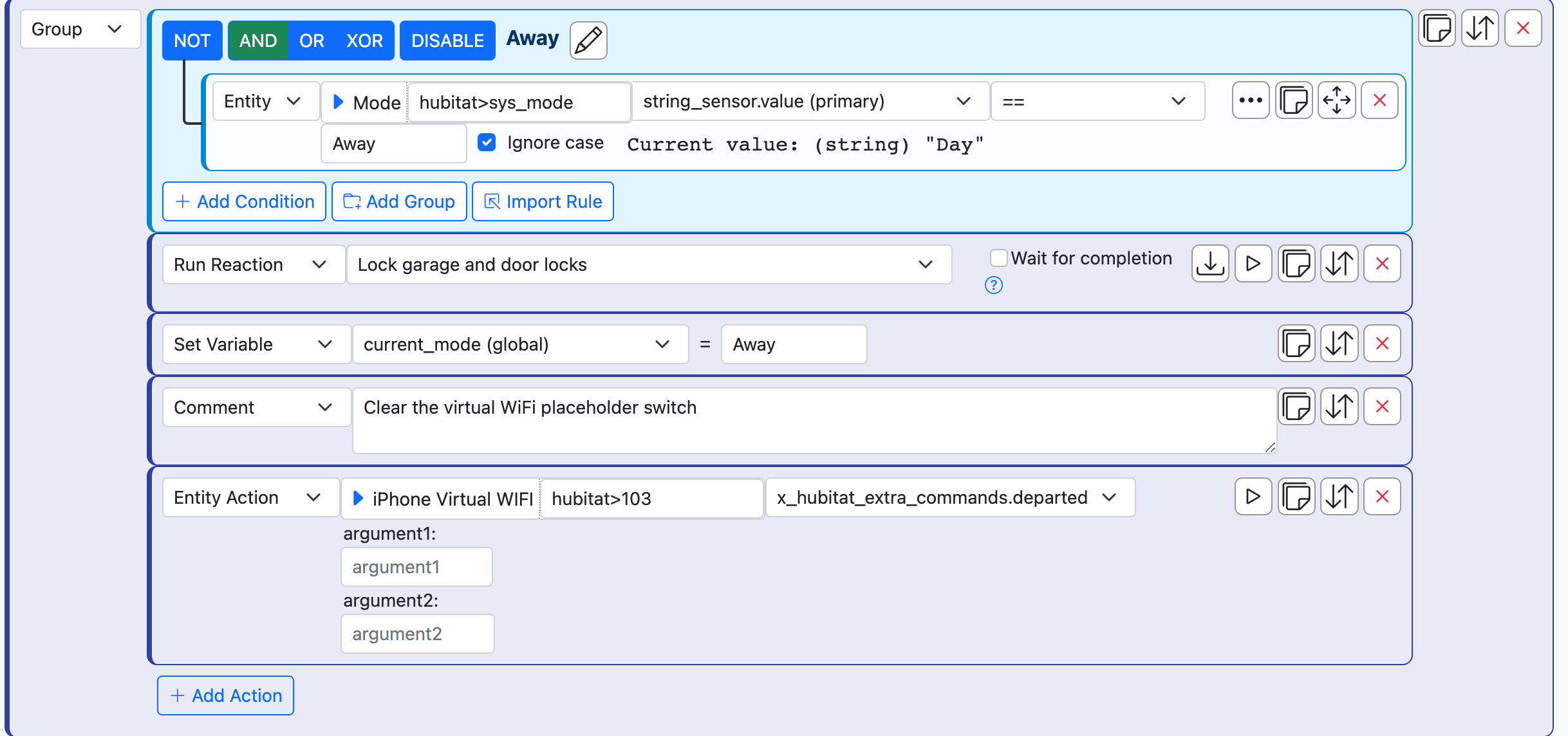

    When this rule goes false I'd like one of two options to happen. @toggledbits introduced me to the use of Group in Reset Reaction which has been fantastic. Attempting to create two groups this morning, however, nets me this:
    I keep staring at it but am plainly missing whatever I've done wrong. As such, it won't let me save the ruleset.
    I did look back, btw, at my others and noticed a spacing change between action and condition - probably completely unrelated but still "something different."
      You're not going anything wrong. It's a UI bug. I won't be able to get to it today, unfortunately. It may be a couple of days before it gets fixed.
        @toggledbits Appreciate the vote for "sane after all". No rush, this is tweaking some automations. Lived without it up to this point, a few days more is NBD. Thanks for this, sir!
          PR 0000336 is open for this.

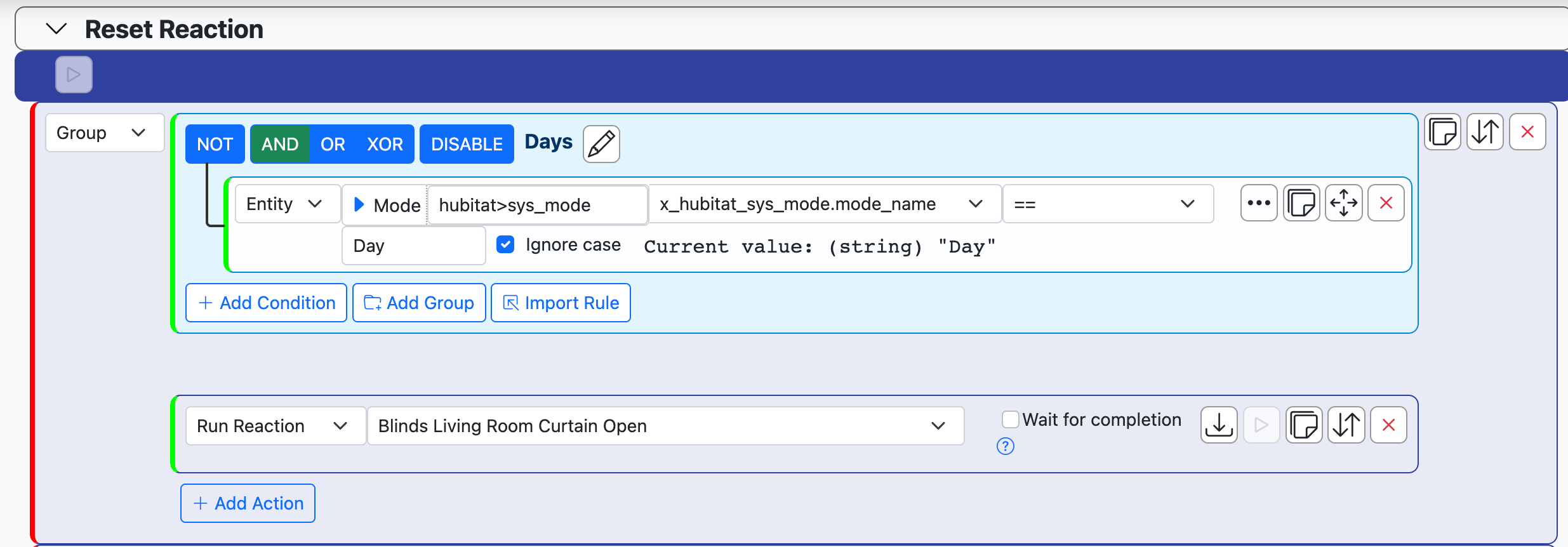

              @3rdstng it's great in some places, for sure. I've been using it to create multiple responses, ie "do this reset reaction if mode goes Away>Day" vs "do this reset reaction if mode goes Away>Evening" as groups under the original ruleset for lights/blinds/etc. Really nice functionality.
                Confirmed this issue is rectified. Thank you!
