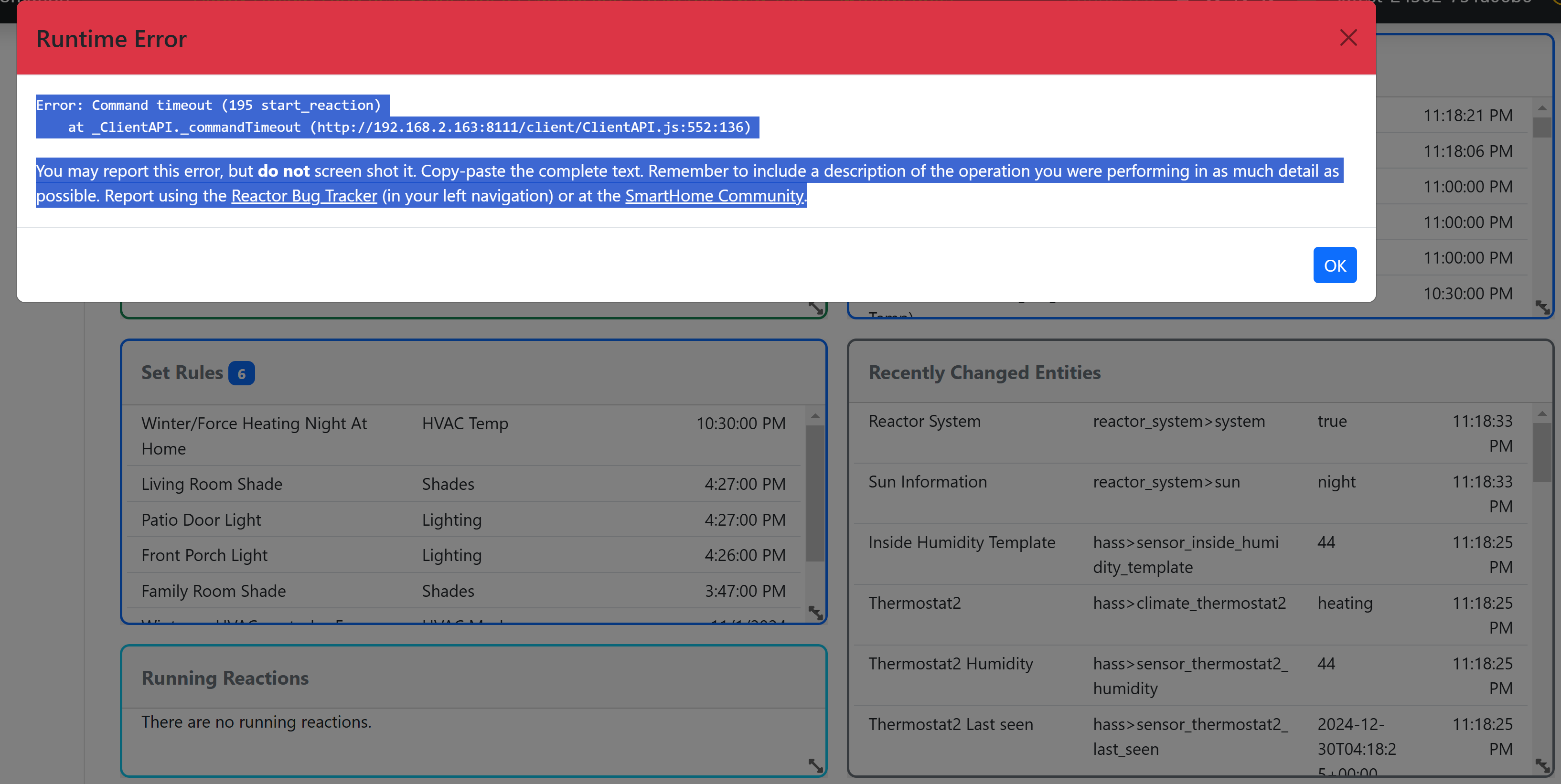

    Not sure that it is the same issue but just got this on built 24302 when running a reaction for testing purpose. Despite the error message, the reaction ran properly.
    Error: Command timeout (195 start_reaction)
    at _ClientAPI._commandTimeout (http://192.168.2.163:8111/client/ClientAPI.js:552:136)
    Using MSR 26177 on Docker, on a Raspberry Pi with Trixie. Home Assistant 2026.08, Z-Wave JS-UI 11.21.1
    • V vezinpi
      @vezinpi said in Reactor-Editor / Reactor-ui-Status Errors:
      That was fixed in 24343. The reaction apparently runs long (lots of delays?), so it was causing the API to time out waiting for the reaction to finish. All works differently in 24343 and beyond.
