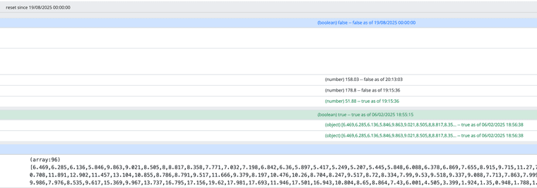

                @toggledbits I have tested the latest build (25278), and otherwise everything seems to work normally but having a strange variable issue with one rule.
                I'm using practically the same structure in two rules, where one works but the other doesn't. Details below.
                Rule 1: (ok)
                Rule 2: (not ok)
                Screenshot 2025-10-10 at 13.44.32.png (Timestamps for rules 1 & 2 are different as screenshots have been taken hours apart, so that can be ignored)
                Tried resetting rule 2 and restarting MSR—neither made a difference. "lastModified" variable clearly changes, but for some reason MSR does not detect that. I can send you logs if needed.

                  Can you confirm that you intend your condition group to be "NOT AND". This is a bit confusing, because you are just showing your logic without explanation as to what you intend to do (not how you think it works, how you want it to work).
                  Also confusing is that the expression and the condition are showing the same value (so the condition seems to be up to date), modulo the reset delay, but I have no reference for time passed there.
                  Edit:
                  Also, always look at the logs when something doesn't work as expected. There may be a logged error there that will tell the story without hours of back-and-forth and research.
                  At the moment, I'm not able to reproduce this.

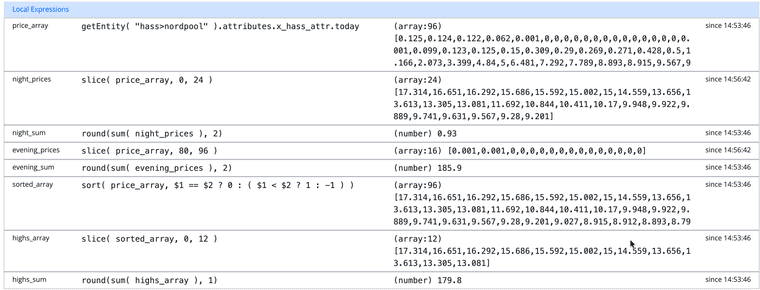

                            @toggledbits updated to this build, and can report one bug (although it might have been present earlier, but I only noticed this behaviour with this build).
                            I have a rule with following local variables:
                            If I click "play" (run) in edit mode on any of these local expressions, I get a runtime error "request failed" (with no other information). Also, if MSR is restarted and expressions get re-evaluated, some of these will be incorrect. E.g. "night_prices" should be first 24 entries of "price_array", but instead it contains first 24 entries of of "sorted_array". Likewise "evening_prices" contains last entries of "sorted_array" when it should have last entries of "price_array".
                            "highs_array" seems to be okay for some reason.

                              Wow. That error has been around a while, and I'm surprised nobody noticed and reported it. It's actually a bug in lexpjs, the parser/executor for expressions... it's sorting the array in place rather than sorting a copy that it then returns. That's not consistent with its spec, and I can easily fix that and get it into the next build. That bug causes other expression values to be modified when they should not be (the effect is pretty obvious in the image, for example, the first price is not 0, so the first night_price should not be 0 either).
                              If you need to work around it, clone your array before sorting it:
                              sorted_array = sort( clone( price_array ), $2 - $1 )
                              I also added a little shortcut there for the sorting function. You don't specifically need to return +/-1 or 0, the sort will look at anything positive, negative, or zero, so simple subtraction can take the place of the more complex conditional expression.
                              The clone() should not be necessary in future builds.
                              Here's what it looks like for me now with the lexpjs fix in place (no clone() needed):
                              Thank you for including a copy of the source array in text form. That was super-helpful and a big time-saver.
                              tunnusT 1 Reply Last reply
