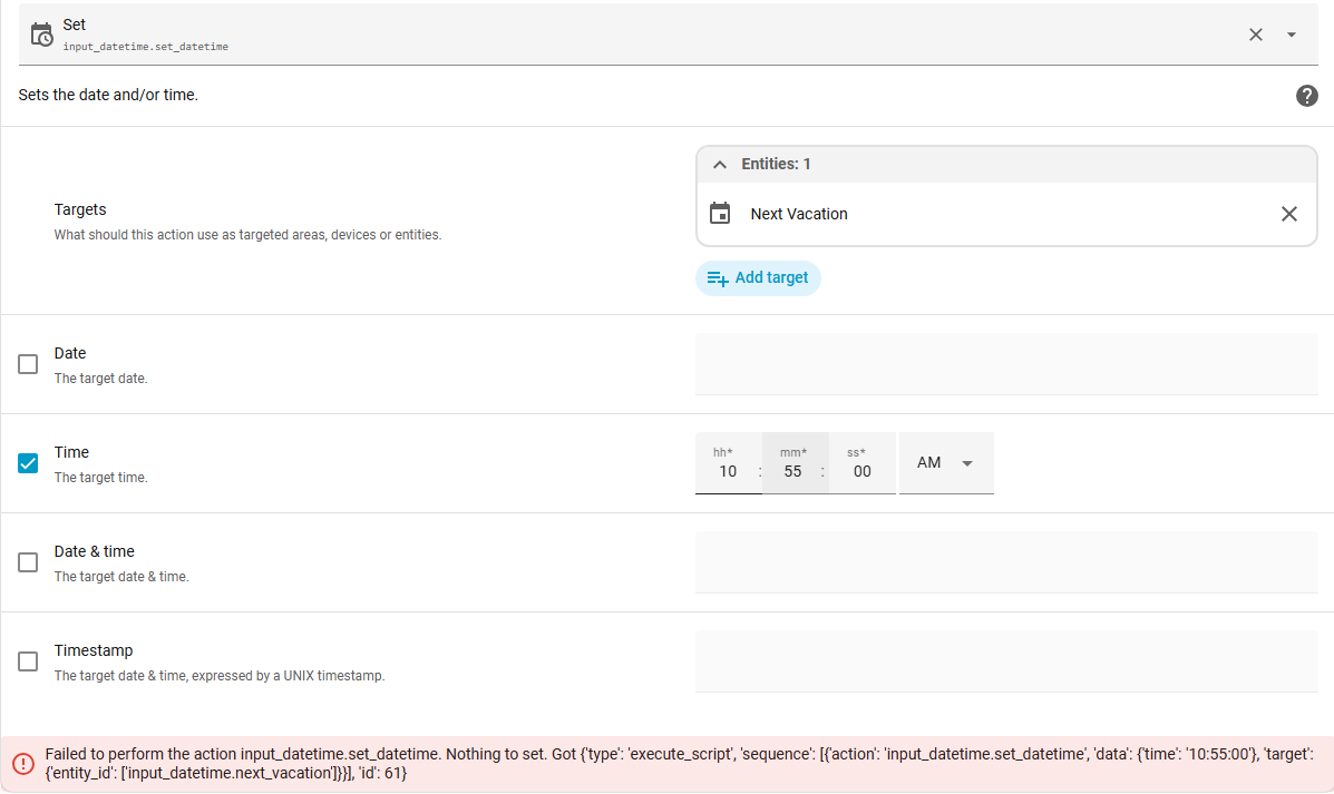

      Different. I'm looking into this. Using HA's own developer tools UI, this service fails as well when trying to set only the time component... 🤔
        OK, thanks. Strange because it works in developer tools for me...
          OK. So this is not the whole mystery, but it addresses one part... the service call looks like it depends on the configuration of the entity. The integration has two properties for its entities has_date and has_time, and if one is false and you attempt to set that field, you get an error. I just created another input_datetime with has_date: false and has_time: true and the service call works fine.
          HassController is still not happy, though... still looking...
            Got it. Multiple layers of this. It actually is related to the other PR, but again, that's also not the only issue. They also introduced a new selector type specifically for time and HassController is not handling it properly.
            I'll have a new full build out later today. No more respins on 25310.
