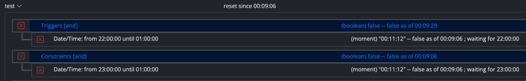

    We already had a brief discussion about this via DM, but here goes again. I'm using build 25325 on Docker and noticed that a date/time condition is not working properly when a time interval crosses midnight (e.g. "from 23:00 until 01:00").
      Tested. It's working and not. It looks like if the condition is evaluated (e.g. Reactor restart or rule edited) in the period between midnight and its end time, it's getting the wrong result (should be true but reporting false). That's a regression in 25315. I've already got a fix for that based on your DM.
