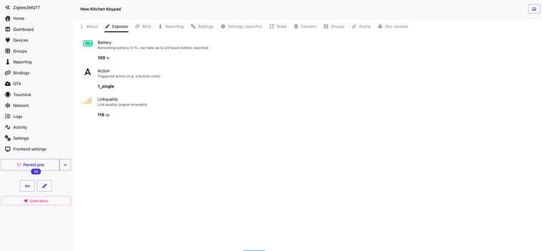

    Although it's immediately visible in Zigbee2mqtt with Battery, Action and Link Quality:

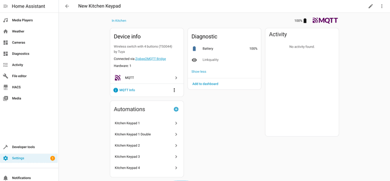

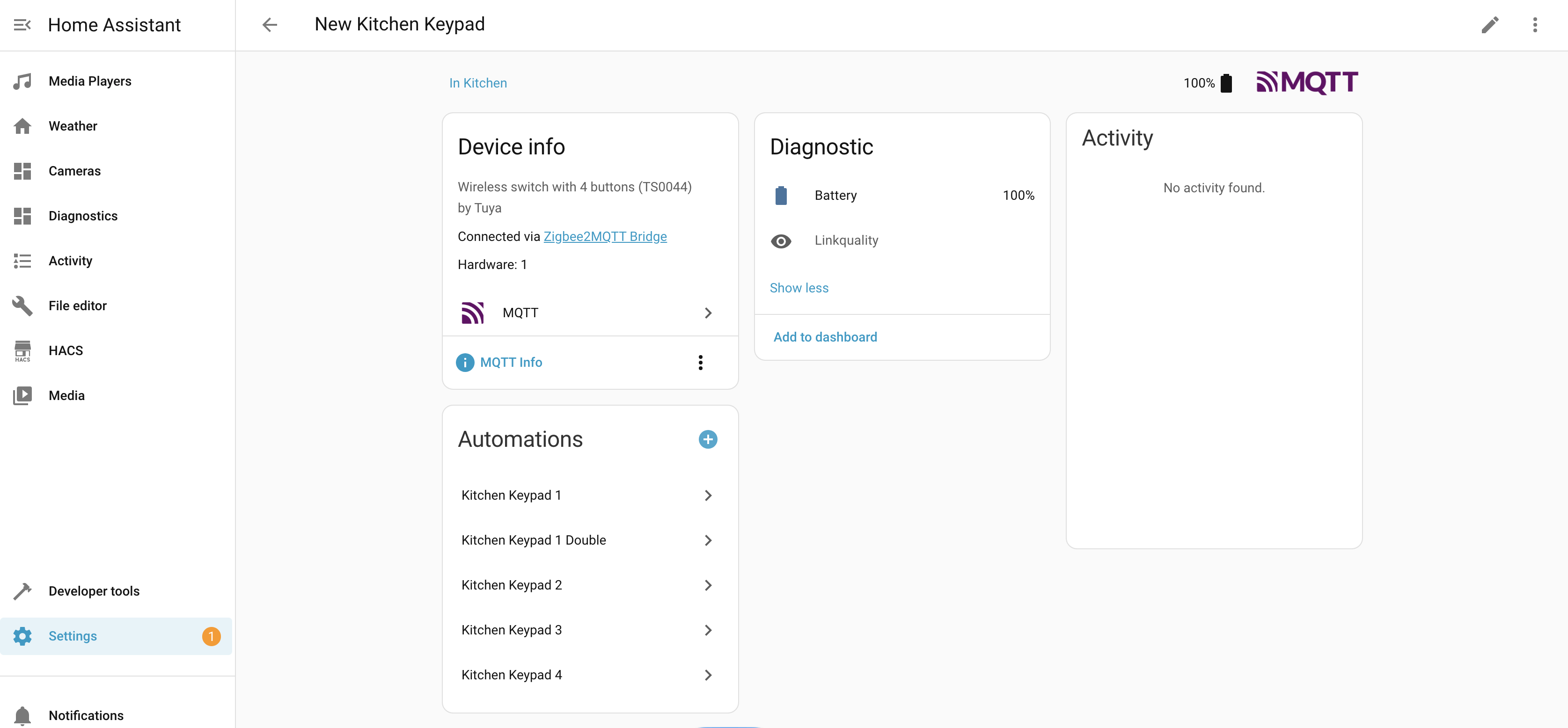

    And immediately pops up in HASS, HASS only exposes Battery and Link Quality:
    This strikes me as a bit perverse given that HASS can (pretty obviously) react to the keypresses.

      You may take a look at the Reactor docs for Handling Home Assistant Events or build/modify your own MQTT template where you need to map all published actions to standard actions e.g. 1_single to single.
