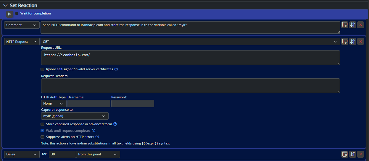

    I can't work out why this existing rule now no longer works? It was a rule to get my current WAN IP address, store it in a variable and then send that value to the Multi-String device in Vera. The trigger was just a time based trigger to run every so often.
    Set Reaction -
    2e9a6da9-095e-4372-89c0-76c0c134dd64-image.png 0527b8dd-2902-4962-89d7-f9af2b90ce1b-image.png
    Temp Local Expression - This is empty and it shouldn't be.

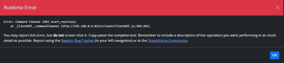

    The current IP value in the Global Expression "myIP" is also wrong and not up to date. If I press the Play button on the Set Reaction I get this error:

      @cw-kid The capture variable having a null value is a pretty indication that there was an error. You have the "Suppress alerts on HTTP errors" box checked, so you're silencing your first option for notification of an error on the request. But then, there could be another location... 🤔

        @toggledbits said in Existing Rule stopped working HTTP command fetching IP address from website:
        Sorry I didn't notice that, I unchecked it and saved the rule, now when I reset the rule the popup error box just says "The request failed" and I still don't get an actual alert in the status area of MSR with anymore detail.
        Or if instead I press the Play button on the Set Reaction it then says:
        Error: Command timeout (1782 start_reaction)
        at _ClientAPI._commandTimeout (http://192.168.0.4:8111/client/ClientAPI.js:546:201)

              The endpoint has 15 seconds to answer by default (i.e. default timeout)... that's a long time for such a simple request. https://icanhazip.com is a popular choice for this purpose, apparently, and may be more reliable. Its response is plain text rather than JSON, but based on your use, that's more direct.
              In any case, network errors are a fact of life, and requests will fail. If that's important to your process, error handling should be added (e.g. detect failed requests and skip changing the Vera variables).

                @toggledbits > https://icanhazip.com
                Thanks for the tip, I have changed the rule to use your suggested HTTP end point instead. Will see how I get on with that.

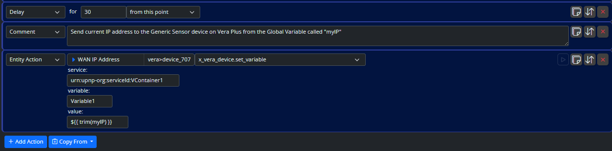

                    In your x_vera_device.set_variable action, where you have the substitution ${{ myIP }}, change it to ${{ trim(myIP) }}
                    Ref: String Functions
                    cw-kidC 1 Reply Last reply
                      ${{ trim(myIP) }}
                      OK done that. I am still getting an error with that new HTTP end point:
                      Reaction "GET My WAN IP Address<SET>" (rule-kmomxige:S) step 2 HTTP request failed
                      FetchError: request to https://icanhazip.com/ failed, reason:
                      Last 2:05:16 PM
                      My rule now looks like this:
                        Best add some error detection, then.
                          Here's another one that is very likely to not have significant downtime: https://checkip.amazonaws.com/
                          If you still get errors with this one, I suspect your local network or something off with the configuration of your host.
