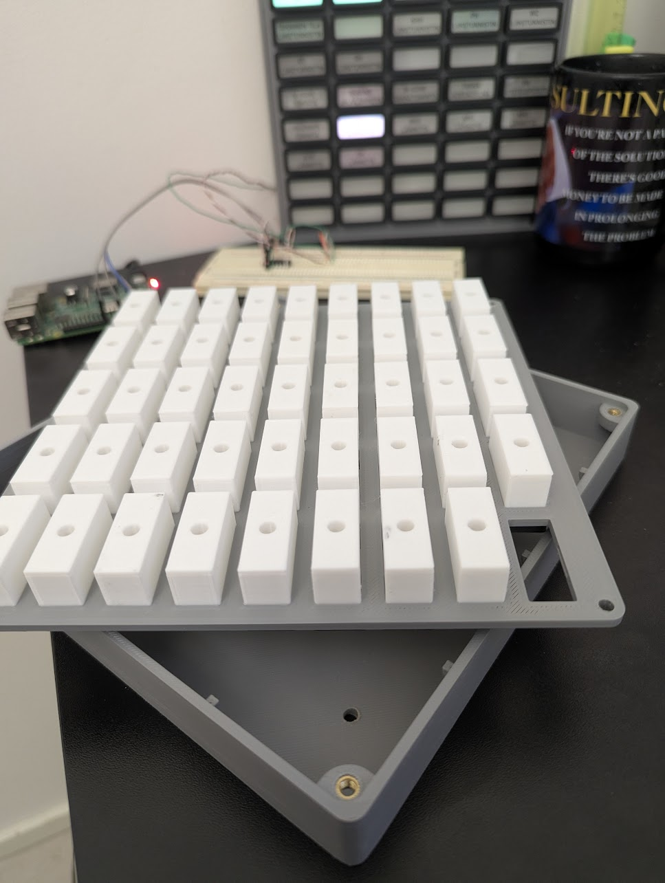

    I'm building a retro annunciator panel for my home automation’s "mission-critical" (and not so critical) statuses. Each 3D-printed panel consists of 45 RGB WS2812D 5mm LEDs. The plan is to introduce at least two panels, maybe even four if I totally lose it.
    Control is handled by a spare Raspberry Pi 3, which communicates with the MSR via MQTT. Each panel/LED follows this topic format:

    One might ask: "Who on earth needs dozens of indicator lights in a modern HA system?" Well, probably nobody, unless you get carried away with 1960s NASA ground control panels. I stumbled upon @toggledbits DSKY project and thought that since you’re clearly a fan of similar hardware, you might be interested in this "crazy" project of mine.
    This project was dormant for years but escalated quickly after I picked up a Creality K1C 3D printer. After the obligatory "calibration benchies," I remembered the annunciator panel, fired up Blender, and things got serious. Unlike the DSKY project, I’m not trying to replicate a specific device but rather capturing the era's aesthetic. The design is heavily inspired by the Master Specialties Company’s Roto-Tellite Series 1000 - those classic multicolor indicators found in the Titan II ICBM and NASA consoles.
    The Design:

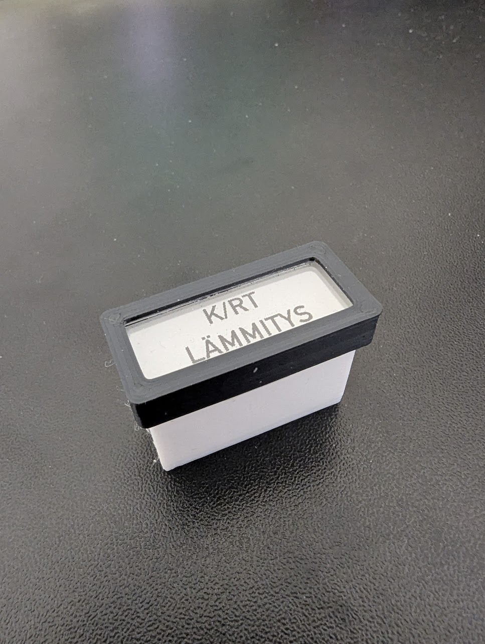

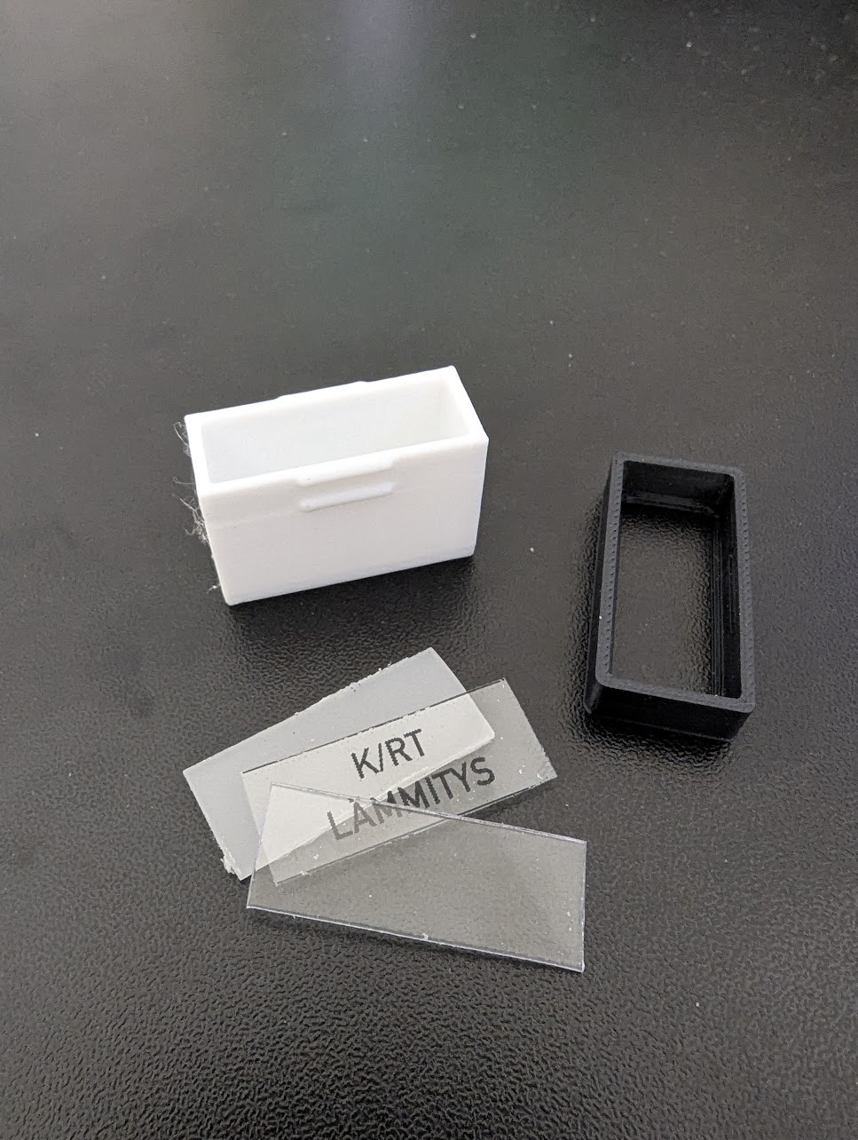

    The construction is straightforward. Each light module consists of a 20mm light well that snap-fits into the front panel. At the bottom, there’s a snug fit for the 5mm LED. The front face is a "sandwich" of a diffuser plate (reclaimed from an old LCD monitor), a label printed on transparent overhead film, and a 1mm acrylic plate. These are held together by a black frame/cap that snap-fits into the light well for toolless removal.
    The enclosure is roughly 200x200x26 mm - near the maximum size for the K1C build plate. The LEDs are daisy-chained and connected to the RPi via a 74AHCT125N level shifter.

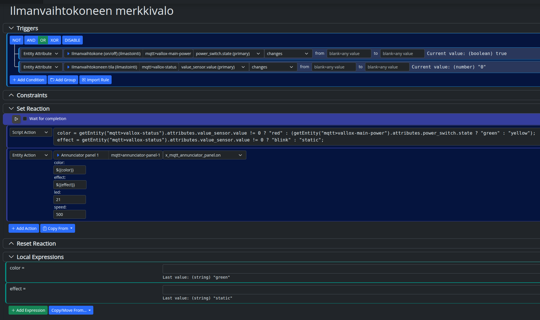

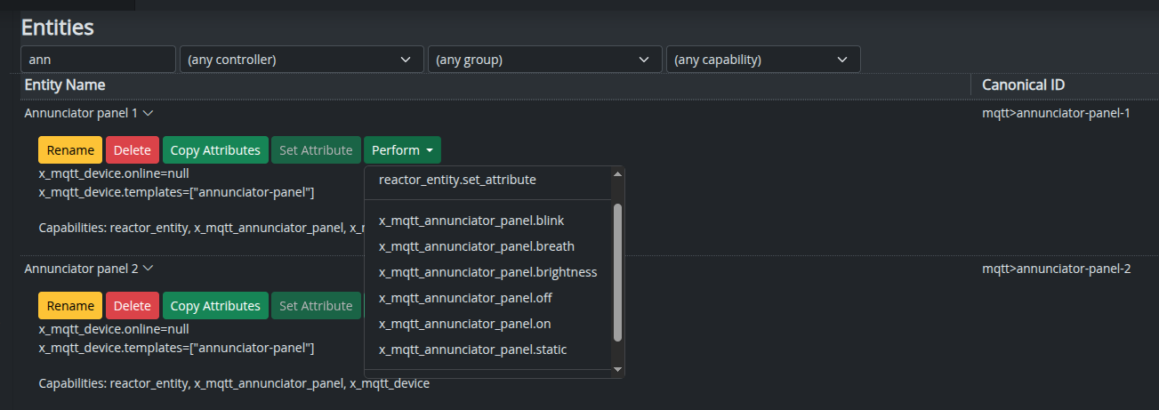

              I've installed the latest version 26059 and can confirm that the parameter substitution works perfectly!
              Thanks a lot for the quick fix and the feature update @toggledbits

              Below is the setup for the ventilation unit (AHU) indicator light:
              • Green: Running OK
              • Yellow: Switched off
              • Blinking Red: Error
              ba29ea20-cc5f-4998-abd7-c14456600fce-Screenshot from 2026-03-02 18-25-07.png
              And here are the panel operations:
              b8995409-8929-4c71-bba4-5ac7f8eae3f4-Screenshot from 2026-03-02 18-23-40.png
