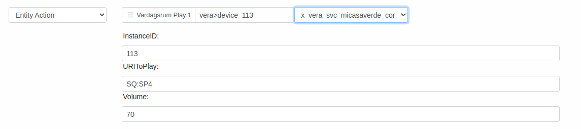

    I have not succeeded to play a playlist in Sonos from the MSR using the setting below. Am I doing something wrong? Should "InstanceID" be something else?
    EDIT: InstanceID should be set to 0
      I think it just wants "0"

        Yes, you are right. I figured it out. It should be InstanceID: 0
