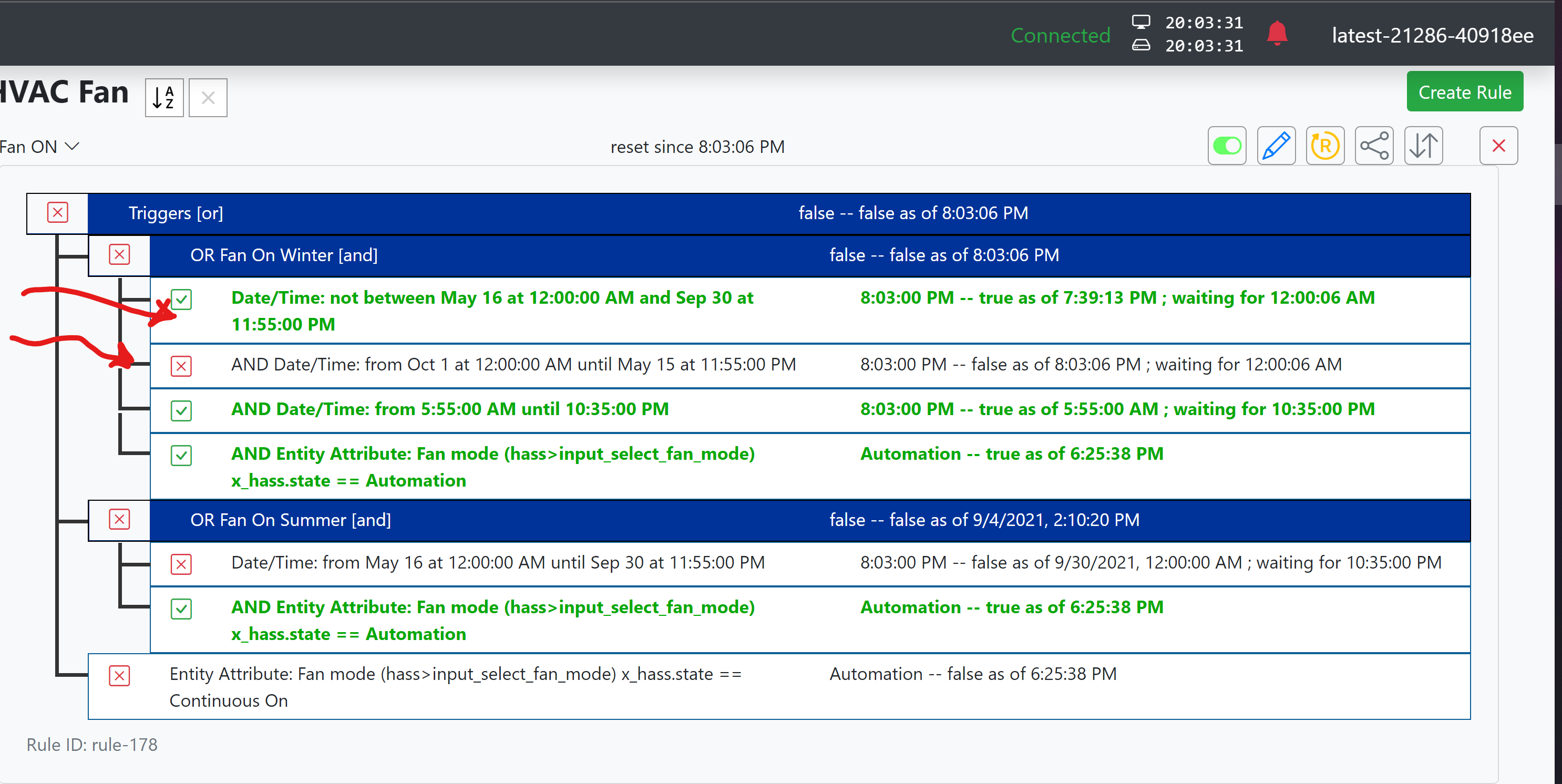

    I feel a bit stupid with this issue since I know it is working and that it worked before.
    I just can't seem to have a date range (between) going past dec 31 to work. In the interim, I manage to acheive what I want by using the "not between" equivalent.
    I am using MSR on a raspberry Pi and I do have the latest development version (21286).
    Here is a screen capture on which I have both the "between" and its equivalent "not Between" just so that you could see it.
    I is probably something stupid and apologise in advance.

      Hi. I'm no expert, but I would try this if I were you:
      1. The first condition in the first group don't add any value (the not between condition). Erase it.
      2. In the second condition in the first group, remove the time conditions (12:00:00 AM and 11:55:00 PM) and keep the dates.
        /Fanan
        I'd have to ask, first, what is the goal? What is it you're trying to get out of this ruleset?
          That's a bug. I found it. I opened PR 262 to track it. Build 21292 is now up for download/install with the fix.

            Install the new version and it is now working as expected.
            Thanks for looking into it.
