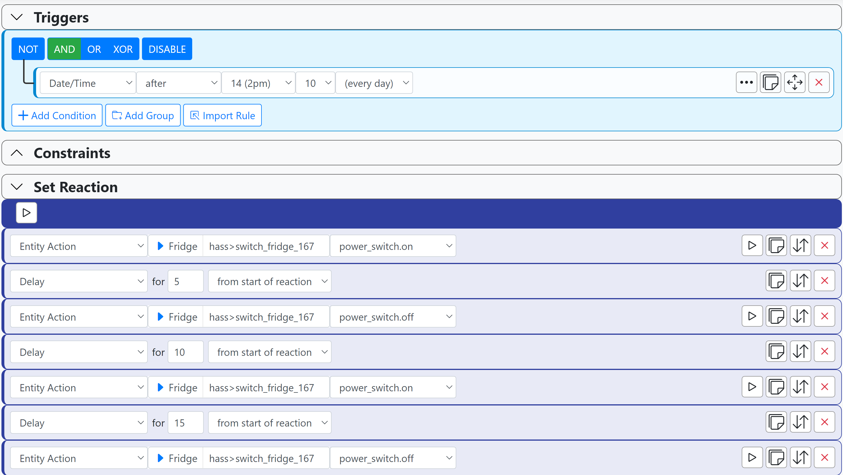

    MSR v22028 on Raspberry pi OS with Docker
    In the following small test (to show the issue), the delay "from start of reaction" behave as "from this point". When I look in Running Reaction widget, I can see that the delay are adding up counting 5 then 10 then 15 between each reaction.
    I was expecting a change to be every 5 sec since it is from the start of the reaction. Changed my delays and used "from this point" to avoid the issue for now.
    Using MSR 26177 on Docker, on a Raspberry Pi with Trixie. Home Assistant 2026.08, Z-Wave JS-UI 11.21.1
      OK. Opened PR0000302 for that, and fixed. I don't know when I'll next release a build, though. May be a few days yet.
