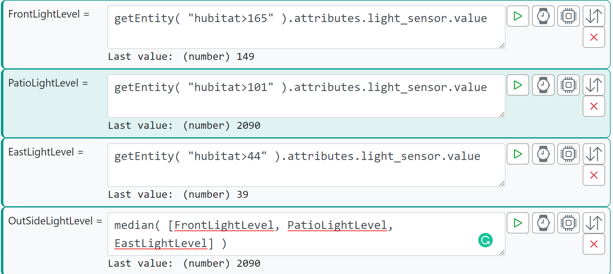

    I've noticed recently that the median function does not return the middle value sometimes,
    latest-25082-3c348de6

        Will be fixed for a release coming this weekend. Weird sorting issue.
