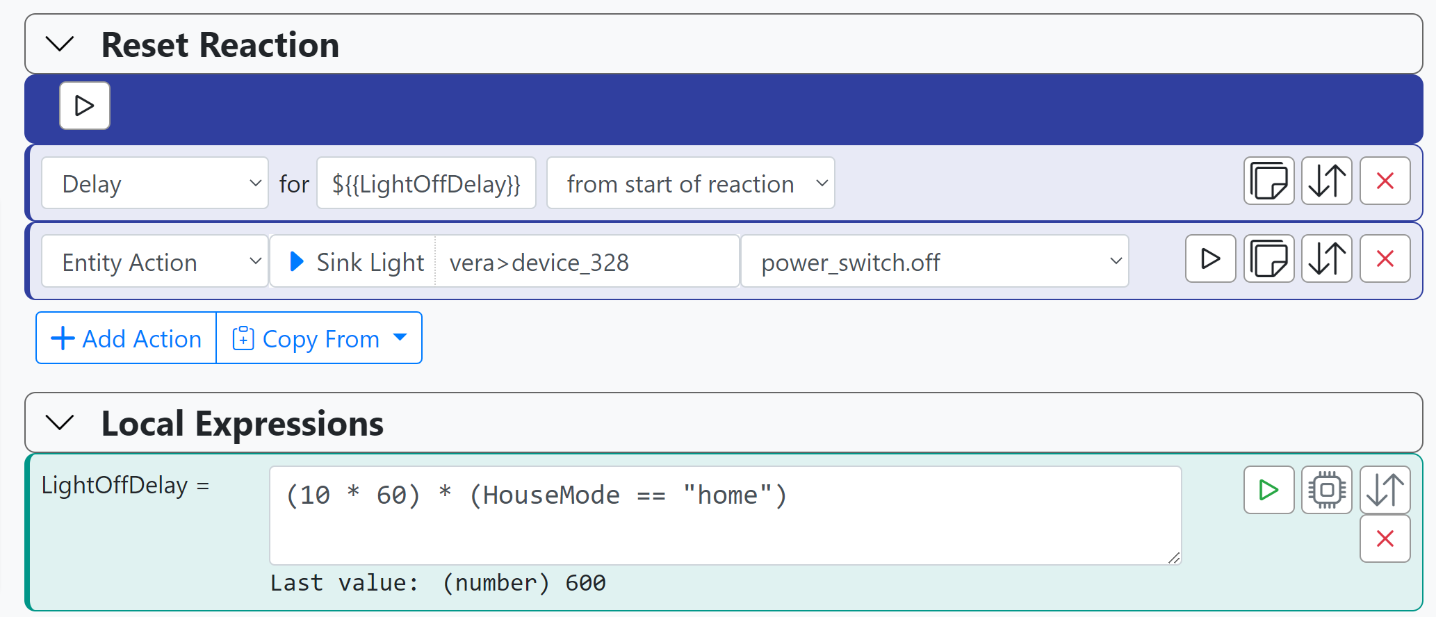

    I have noticed that when I use a local variable in the time for a delay it will change after some time to a fixed number.
    I enter this:
    And later it is this:
    I have noticed similar behavior when using local variables in other fields.
    latest-25082-3c348de6
      I've opened PR 0000308 for this; I can reproduce it.
