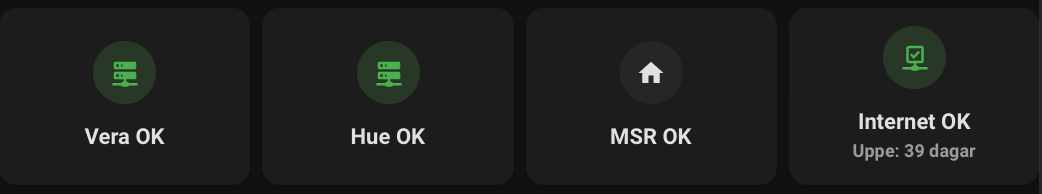

    Perhaps a dumb question. Can I check from Home Assistant that MSR is up and running? I would like to see that in a status page in HA. I can of course ping the other Pi but it doesn't say anything about the MSR status.
      Try requesting http://your-host-address:8111/api/v1/alive
