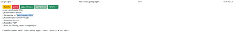

        @therealdb OK so I'm doing something wrong 🙂
        Testing on my Garage lights which I believe has canonical ID
        switch.garage_lights
        Which I don't think needs URL encoding. (Well the URL encoder I checked didn't make any changes)
        So I have this in my HA Bridge:
        http://192.168.70.249:8111/api/v1/entity/switch.garage_lights/perform/power_switch.on
        On testing HA bridge suggests all is well, but nada happens to the the switch
        Reactor logs the request
        [latest-25325]2026-01-05T10:48:19.404Z <httpapi:INFO> HTTPAPI(#1) API request from ::ffff:192.168.70.249: GET /api/v1/entity/switch.garage_lights/perform/power_switch.on
        I've set the type as HTTP in HA Bridge (and tried as Vera)
        Please forgive my idiocy...
                  @CatmanV2 said in [HowTo] Using HABridge with Reactor:
                  Nope, canonical IDs in HASS always require encoding. Ask me why I know this...
                  The request is failing otherwise. Trust me 😼
                    Ahh well I rather assumed that someone smart (like you two) would look at my URL in HA bridge and immediately spot the fault 🙂
                    As ever, appreciated and working 🙂
