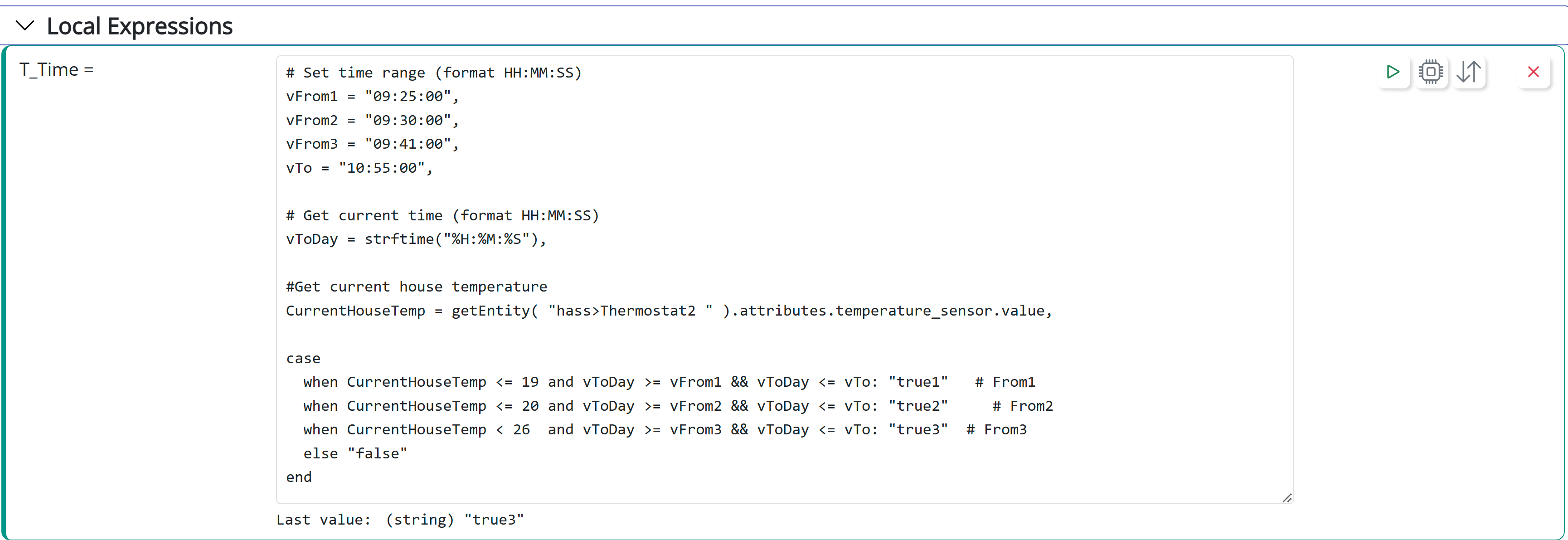

    Trying to understand what cause a local expresssion to be evaluated. I have read the manual but I am still not clear about it. Using the test rule below, I can see in the log that the rule is being automatically evaluated every time the temperature entity is changing. That is great...
    What I am trying to understand is why the expression is not evaluated based on time as well since the "case" statement has time dependencies.
    Any help would be appreciated
    I have the following test rule:
    Here is the expressioncode:
    vFrom1 = "09:25:00",
    vFrom2 = "09:30:00",
    vFrom3 = "09:41:00",
    vTo = "10:55:00",
    # Get current time (format HH:MM:SS)
    vToDay = strftime("%H:%M:%S"),
    #Get current house temperature
    CurrentHouseTemp = getEntity( "hass>Thermostat2 " ).attributes.temperature_sensor.value,
    case
      when CurrentHouseTemp <= 19 and vToDay >= vFrom1 && vToDay <= vTo: "true1"   # From1
      when CurrentHouseTemp <= 20 and vToDay >= vFrom2 && vToDay <= vTo: "true2"     # From2
      when CurrentHouseTemp < 26  and vToDay >= vFrom3 && vToDay <= vTo: "true3"  # From3
      else "false"
    end
    Using MSR 25139 on Docker, on a Raspberry Pi with Bookworm. Home Assistant 2025.07, Z-Wave JS-UI 10.6.1
    • toggledbitsT Online
      toggledbitsT Online
      Time is never a trigger for expressions. It would basically require re-evaluation every second. There's no way for the expression evaluator to determine your intent in the expressions and find an "edge" where it would know that your conditions are changing. This is unlike the Date/Time and related conditions in the triggers, where it is usually possible to determine when the next event will occur. You should probably be using Date/Time conditions rather than expressions for logic like this.
      TL;DR: that's by design. Time functions don't cause frequent re-evaluations.
      Tip: you can use an Interval condition to force your rule to re-evaluate on the given interval, at which time, your local expressions will also be re-evaluated (local expressions are updated before triggers are scanned when a rule evaluation takes place).
      Also: it's not correct to compare a time string to another time string. Basically, everything about this expression won't work.
      V 1 Reply Last reply

          @toggledbits said in [Solved] Local expression evaluation:
          I understand that, as you explained, expression cannot auto evaluate based on time. However when manually trigger, the expression do work as intended with time and all.
          I Know that your not in the business of teaching others how to code but does it means that, inside an expression, we should never attempt to perform actions based on time like:
          if strftime("%H:%M:%S") < "08:00:00" then
            If you use Unix epoch format, you can compare two values as they are numbers
            Using MSR on Docker (Synology NAS), having InfluxDB, Grafana & Home Assistant, Hubitat C-8, Zigbee2MQTT
              toggledbitsT Online
              At best, comparing numbers within strings is considered bad style. As @tunnus says, you're better off using epoch time format in many cases, which we could say more broadly as, there are numeric forms available that will work better (and show good programming discipline/style).
              Now, your particular tests can be done in epoch time, but that may not be the best approach, since epoch time is absolute from Jan 1 1970 UTC, and you are really just looking at particular daily events. Within Reactor itself, similar calculations are done in MSM form, or Minutes Since Midnight.
              Looking at your "edges" (the points in time where things change), you could set them in MSM form like this:
              vFrom1 = 09 * 60 + 25,
              vFrom2 = 09 * 60 + 30,
              vFrom3 = 09 * 60 + 41,
              vTo = 10 * 60 + 55,
              You can see I am multiplying the hour by 60 and then adding the minutes, which gives minutes since midnight for each event time.
              To get the current time in MSM, you can:
              p=dateparts(), vToDay= p.hour * 60 + p.minute,
              From there, the rest of your expression should work as you wrote it, but it will now be comparing numbers (MSM):
              CurrentHouseTemp = getEntity( "hass>Thermostat2" ).attributes.temperature_sensor.value,
              case
                else "false"
              end
              This doesn't change the fact that this expression won't be evaluated periodically on its own. You still need to use an Interval condition to stimulate its re-evaluation.
