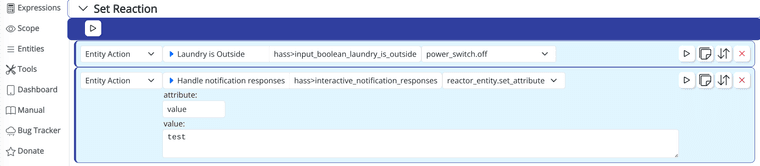

    My solution was to use an entity action and do a set_attribute to reset the value of the entity. But this does not seem to work.
    This is my set reaction part:
    Shouldn't this be working? And maybe there is a smarter way?

      Additional question:
      • The entity value is not changing, because the value doesn't change, right? Or is the event not even triggered? (I don't see the entity flashing in the entities section, when I try to trigger the event)
      • Can I add attribute metadata to the rule trigger to see if there was an update?
        That's right. Adding a check to see if since changes will address this.
        You could do that as well, but it's more complicated because right now, the metadata is only accessible in expressions, so you'd need to make a local variable in your rule to grab that metadata.

          @toggledbits Thanks, this is great. I will try it out!
          • R Offline
            R Offline
            RHCPNG
            Seems to be working perfectly. Thanks! Should have thought of that myself.
