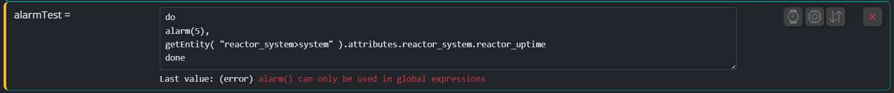

        I'm still having some (other) issues...

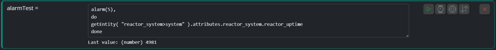

        First a question, is do...done in a Global expression considered out of scope to the function? because when alarm() is put in the statement block it shows error. When alarm() is put before the statement block it seems to be working a bit inconsistent, probably related to the observations further down.

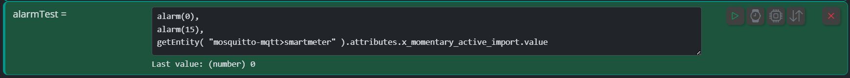

        Trying this, an entity that is updating faster than the tick. The GUI is flapping between error and OK value and the log goes crazy

            Testing with
            alarm(0),
            alarm(15),
            getEntity( "mosquitto-mqtt>smartmeter" ).attributes.x_momentary_active_import.value
            Same behavior in GUI, log:
            [latest-25310]2025-11-07T14:32:20.950Z <Engine:NOTICE> Engine#1 expression alarmTest has changed
            [latest-25310]2025-11-07T14:32:20.951Z <Engine:CRIT> Engine#1 alarm(0) -- cancelling alarmTest timer
            [latest-25310]2025-11-07T14:32:20.951Z <Engine:CRIT> Engine#1 alarm() scheduled alarmTest tick for 1762525955951<2025-11-07 15:32:35> = now 1762525940951<2025-11-07 15:32:20> + delay 15000
            [latest-25310]2025-11-07T14:32:21.782Z <Engine:ERR> Engine#1: error evaluating expression alarmTest: [ReferenceError] alarm() can only be used in global expressions [-]
            [latest-25310]2025-11-07T14:32:21.782Z <Engine:ERR> Engine#1: expression: alarm(0),
            alarm(15),getEntity( "mosquitto-mqtt>smartmeter" ).attributes.x_momentary_active_import.value
            [latest-25310]2025-11-07T14:32:21.783Z <Engine:CRIT> ReferenceError: alarm() can only be used in global expressions [-]

              Can you show me an alarm tick message?
                wrote last edited by
                Yes, if I lower the tick to 2000ms it's logged (different from before)
                [latest-25310]2025-11-07T14:42:21.833Z <Engine:CRIT> Engine#1 alarm() scheduled alarmTest tick for 1762526543833<2025-11-07 15:42:23> = now 1762526541833<2025-11-07 15:42:21> + delay 2000
                [latest-25310]2025-11-07T14:42:23.833Z <Engine:CRIT> Engine#1 alarmTest alarm() tick
                [latest-25310]2025-11-07T14:42:23.833Z <Engine:CRIT> Engine#1 alarm(0) -- cancelling alarmTest timer

                  Odd. I'm not able to duplicate this, and there's a message missing from the log that I would expect to see in conjunction with the other messages. Can you re-apply the build and restart, and try again?
                    I downloaded it again, re-applied and restarted.
                    Changed entity to eliminate any issues with my x_mqtt entity but same behavior and this is whats logged at Engine level 4
                    [latest-25310]2025-11-07T15:19:15.932Z <Engine:CRIT> ReferenceError: alarm() can only be used in global expressions [-]

                        at /home/homebridge/reactor/server/lib/Engine.js:1455:23
                        at _run (/home/homebridge/reactor/common/lexp.js:1704:34)
                        at /home/homebridge/reactor/common/lexp.js:1426:29
                        at _run (/home/homebridge/reactor/common/lexp.js:1425:28)
                        at Object.run (/home/homebridge/reactor/common/lexp.js:1855:24)
                        at Engine._eval_expr (/home/homebridge/reactor/server/lib/Engine.js:1170:141)
                        at Engine._expr_dependency (/home/homebridge/reactor/server/lib/Engine.js:1555:82)
                        at /home/homebridge/reactor/server/lib/MessageBus.js:114:195
                    [latest-25310]2025-11-07T15:19:21.823Z <Engine:ERR> Engine#1: error evaluating expression alarmTest: [ReferenceError] alarm() can only be used in global expressions [-]
                    [latest-25310]2025-11-07T15:19:21.823Z <Engine:ERR> Engine#1: expression: alarm(0),
                    alarm(15),
                    getEntity( "hass>sensor_momentary_active_import" ).attributes.string_sensor.value
                    [latest-25310]2025-11-07T15:19:21.824Z <Engine:CRIT> ReferenceError: alarm() can only be used in global expressions [-]
                    [latest-25310]2025-11-07T15:19:21.827Z <Engine:ERR> Engine#1: error evaluating expression alarmTest: [ReferenceError] alarm() can only be used in global expressions [-]
                    [latest-25310]2025-11-07T15:19:21.827Z <Engine:ERR> Engine#1: expression: alarm(0),
                    alarm(15)...
                    Tried Engine log level 5 but was to much for me to handle 🙂 I tested the same expression in a new variable but it produced the same error.
                    No related errors in the startup sequence of the log either.

                      Can you show the log starting with "expression alarmTest has changed" (context before the error message)?
                        Unfortunately that's long gone by testing level 5 but before that the expression was the simple string "hello" so there were only rule related log entries before it. I can reproduce it if you want though...
                          Yes, please reproduce. Level 4 is fine. You can also set gvar_debug: true in the engine config section -- that will be verbose but a lot less verbose than level 5.
                            [latest-25310]2025-11-07T16:16:41.926Z <Engine:INFO> Engine#1 expr alertElmatare result changed=false, was false now false
                            [latest-25310]2025-11-07T16:16:41.926Z <Engine:INFO> Engine#1 evaluating global poolHeat expression do
                              selling = getEntity( "virtual>time_series_selling" ).attributes.power_sensor.value,
                              buying = getEntity( "mosquitto-mqtt>smartmeter" ).attributes.x_momentary_active_import.value,
                              rule = isRuleSet("rule-l3wyah83"),
                            case
                              when selling >= 1.8 : bool(true)
                              when buying < 0.8 and rule : bool(true)
                              when poolHeatTrigger == "on" : bool(true)
                              else bool(false)
                            end
                            done source global
                            [latest-25310]2025-11-07T16:16:41.926Z <Engine:INFO> Engine#1 global expression poolHeat old value=false
                            [latest-25310]2025-11-07T16:16:41.926Z <Engine:INFO> Engine#1 evaluation context { "__lvar": { "MAXINT": 9007199254740991, "MININT": -9007199254740991, "MAXFLOAT": 1.7976931348623157e+308, "MINFLOAT": 5e-324, "testHere": "test", "chargeAmps": 16, "poolHeat": false, "poolHeatTrigger": "auto", "Växthuset": { "LYWSD03aa6def": { "x_mqtt_device": { "online": true, "templates": Array(1) ["tasmota_sensor_lyw"] }, "temperature_sensor": { "value": 7.3, "units": "C" }, "humidity_sensor": { "value": 96, "units": "%" }, "battery_power": { "level": 0.75, "since": 1762532173549, "alert_level": 0.5 }, "reactor_entity": {  } }, "Flora1": { "x_mqtt_device": { "online": true, "templates": Array(1) ["my_tasmota_sensor_flora"] }, "temperature_sensor": { "value": 10.3, "units": "C" }, "light_sensor": { "value": 0, "units": "lux" }, "humidity_sensor": { "value": 0, "units": "%" }, "value_sensor": { "value": 0, "units": (null) }, "reactor_entity": {  } }, "Flora1_Lux": 0.0001, "Flora2": { "x_mqtt_device": { "online": true, "templates": Array(1) ["my_tasmota_sensor_flora"] }, "temperature_sensor": { "value": 8.4, "units": "C" }, "light_sensor": { "value": 618, "units": "lux" }, "humidity_sensor": { "value": 0, "units": "%" }, "value_sensor": { "value": 0, "units": (null) }, "reactor_entity": {  } }, "Flora2_Lux": 618 }, "Medeltemp": 8.67, "Luftfuktighet": 1.1162790697674418, "EzloDevicesNotResponding": Array(0) [], "prevEzloDevicesNotResponding": Array(0) [], "VeraDevicesNotResponding": Array(0) [], "openLuupWasDown": "No", "Charging": false, "ReactorRestarted": false, "HumOutdoor": 86, "TempOutdoor": 8.82, "Självförsörjande": 0, "Elpris": 178.405, "restartCameraRTSP": false, "lovVecka": false, "VVBsellingHigh": false, "HassElpriser": { "buy_sek": 1.86, "sell_sek": 1.53 }, "chargeNow": false, "alertBLE": true, "ElpriserMedelMedian": "Idag:86/87, Imorgon:78/65", "ChargingPaused": false, "alertElmatare": false, "functions": "Global functions", "functionsDEV": "Global functions", "alarmTest": "hello" }, "__depth": 0, "__tag": "$global", "__func": { "_compare": [Function (anonymous) (?,?,?)], "fileRead": [Function (anonymous) (?,?,?)], "fileWrite": [Function (anonymous) (?,?,?,?)], "fileExists": [Function (anonymous) (?,?)], "dumpVars": [Function (anonymous) (?)], "strftime": [Function (anonymous) (?)], "format": [Function (anonymous) (?)], "geodist": [Function (anonymous) (?)], "_assign": [Function (anonymous) (?,?,?)], "getEntity": [Function _0x498020 (?,?)], "entity": [Function _0x498020 (?,?)], "$": [Function _0x498020 (?,?)], "matchEntities": [Function (anonymous) (?,?)], "groupMembers": [Function (anonymous) (?,?)], "performAction": [Function _0x498020 (?,?,?,?)], "perform": [Function _0x498020 (?,?,?,?)], "getRule": [Function (anonymous) (?,?)], "isRuleSet": [Function (anonymous) (?,?)], "isRuleEnabled": [Function (anonymous) (?,?)], "alarm": [Function (anonymous) (?)], "getPrices": [Function (anonymous) (?)], "getSlots": [Function (anonymous) (?)], "cheapestHours": [Function (anonymous) (?)], "VVBdayRange": [Function (anonymous) (?)], "getChargingTime": [Function (anonymous) (?)], "getPricesOLD": [Function (anonymous) (?)], "SlotsOLD": [Function (anonymous) (?)], "cheapestHoursOLD": [Function (anonymous) (?)], "getChargingTimeOLD": [Function (anonymous) (?)] }, "__global": { "__lvar": (seen=.__lvar), "__depth": 0, "__tag": "$global", "__func": (seen=.__func), "__global": (seen=.__global), "__tree": Array(1) ["poolHeat"], "__suppress_dependencies": true }, "__tree": (seen=.__global.__tree), "__suppress_dependencies": true }
                            [latest-25310]2025-11-07T16:16:41.926Z <Engine:INFO> Engine#1 expr poolHeat result changed=false, was false now false
                            [latest-25310]2025-11-07T16:16:42.411Z <Engine:INFO> Engine#1 evaluating global Självförsörjande expression int(getEntity( "vera>device_56" ).attributes.x_vera_svc_micasaverde_com_GenericSensor1.self_sufficient) source global
                            [latest-25310]2025-11-07T16:16:42.412Z <Engine:INFO> Engine#1 global expression Självförsörjande old value=0
                            [latest-25310]2025-11-07T16:16:42.412Z <Engine:INFO> Engine#1 evaluation context { "__lvar": { "MAXINT": 9007199254740991, "MININT": -9007199254740991, "MAXFLOAT": 1.7976931348623157e+308, "MINFLOAT": 5e-324, "testHere": "test", "chargeAmps": 16, "poolHeat": false, "poolHeatTrigger": "auto", "Växthuset": { "LYWSD03aa6def": { "x_mqtt_device": { "online": true, "templates": Array(1) ["tasmota_sensor_lyw"] }, "temperature_sensor": { "value": 7.3, "units": "C" }, "humidity_sensor": { "value": 96, "units": "%" }, "battery_power": { "level": 0.75, "since": 1762532173549, "alert_level": 0.5 }, "reactor_entity": {  } }, "Flora1": { "x_mqtt_device": { "online": true, "templates": Array(1) ["my_tasmota_sensor_flora"] }, "temperature_sensor": { "value": 10.3, "units": "C" }, "light_sensor": { "value": 0, "units": "lux" }, "humidity_sensor": { "value": 0, "units": "%" }, "value_sensor": { "value": 0, "units": (null) }, "reactor_entity": {  } }, "Flora1_Lux": 0.0001, "Flora2": { "x_mqtt_device": { "online": true, "templates": Array(1) ["my_tasmota_sensor_flora"] }, "temperature_sensor": { "value": 8.4, "units": "C" }, "light_sensor": { "value": 618, "units": "lux" }, "humidity_sensor": { "value": 0, "units": "%" }, "value_sensor": { "value": 0, "units": (null) }, "reactor_entity": {  } }, "Flora2_Lux": 618 }, "Medeltemp": 8.67, "Luftfuktighet": 1.1162790697674418, "EzloDevicesNotResponding": Array(0) [], "prevEzloDevicesNotResponding": Array(0) [], "VeraDevicesNotResponding": Array(0) [], "openLuupWasDown": "No", "Charging": false, "ReactorRestarted": false, "HumOutdoor": 86, "TempOutdoor": 8.82, "Självförsörjande": 0, "Elpris": 178.405, "restartCameraRTSP": false, "lovVecka": false, "VVBsellingHigh": false, "HassElpriser": { "buy_sek": 1.86, "sell_sek": 1.53 }, "chargeNow": false, "alertBLE": true, "ElpriserMedelMedian": "Idag:86/87, Imorgon:78/65", "ChargingPaused": false, "alertElmatare": false, "functions": "Global functions", "functionsDEV": "Global functions", "alarmTest": "hello" }, "__depth": 0, "__tag": "$global", "__func": { "_compare": [Function (anonymous) (?,?,?)], "fileRead": [Function (anonymous) (?,?,?)], "fileWrite": [Function (anonymous) (?,?,?,?)], "fileExists": [Function (anonymous) (?,?)], "dumpVars": [Function (anonymous) (?)], "strftime": [Function (anonymous) (?)], "format": [Function (anonymous) (?)], "geodist": [Function (anonymous) (?)], "_assign": [Function (anonymous) (?,?,?)], "getEntity": [Function _0x498020 (?,?)], "entity": [Function _0x498020 (?,?)], "$": [Function _0x498020 (?,?)], "matchEntities": [Function (anonymous) (?,?)], "groupMembers": [Function (anonymous) (?,?)], "performAction": [Function _0x498020 (?,?,?,?)], "perform": [Function _0x498020 (?,?,?,?)], "getRule": [Function (anonymous) (?,?)], "isRuleSet": [Function (anonymous) (?,?)], "isRuleEnabled": [Function (anonymous) (?,?)], "alarm": [Function (anonymous) (?)], "getPrices": [Function (anonymous) (?)], "getSlots": [Function (anonymous) (?)], "cheapestHours": [Function (anonymous) (?)], "VVBdayRange": [Function (anonymous) (?)], "getChargingTime": [Function (anonymous) (?)], "getPricesOLD": [Function (anonymous) (?)], "SlotsOLD": [Function (anonymous) (?)], "cheapestHoursOLD": [Function (anonymous) (?)], "getChargingTimeOLD": [Function (anonymous) (?)] }, "__global": { "__lvar": (seen=.__lvar), "__depth": 0, "__tag": "$global", "__func": (seen=.__func), "__global": (seen=.__global), "__tree": Array(1) ["Självförsörjande"], "__suppress_dependencies": true }, "__tree": (seen=.__global.__tree), "__suppress_dependencies": true }
                            [latest-25310]2025-11-07T16:16:42.412Z <Engine:INFO> Engine#1 expr Självförsörjande result changed=false, was 0 now 0
                            [latest-25310]2025-11-07T16:16:47.368Z <Engine:NOTICE> Engine#1 expression alarmTest has changed
                            [latest-25310]2025-11-07T16:16:47.369Z <Engine:INFO> Engine#1 _compile_global_expr alarmTest
                            [latest-25310]2025-11-07T16:16:47.369Z <Engine:INFO> Engine#1 global expression alarmTest refers to: Array(0) []
                            [latest-25310]2025-11-07T16:16:47.369Z <Engine:INFO> Engine#1 evaluating global alarmTest expression alarm(0),
                            alarm(15),
                            getEntity( "hass>sensor_momentary_active_import" ).attributes.string_sensor.value source global
                            [latest-25310]2025-11-07T16:16:47.369Z <Engine:INFO> Engine#1 global expression alarmTest old value=hello
                            [latest-25310]2025-11-07T16:16:47.369Z <Engine:INFO> Engine#1 evaluation context { "__lvar": { "MAXINT": 9007199254740991, "MININT": -9007199254740991, "MAXFLOAT": 1.7976931348623157e+308, "MINFLOAT": 5e-324, "testHere": "test", "chargeAmps": 16, "poolHeat": false, "poolHeatTrigger": "auto", "Växthuset": { "LYWSD03aa6def": { "x_mqtt_device": { "online": true, "templates": Array(1) ["tasmota_sensor_lyw"] }, "temperature_sensor": { "value": 7.3, "units": "C" }, "humidity_sensor": { "value": 96, "units": "%" }, "battery_power": { "level": 0.75, "since": 1762532173549, "alert_level": 0.5 }, "reactor_entity": {  } }, "Flora1": { "x_mqtt_device": { "online": true, "templates": Array(1) ["my_tasmota_sensor_flora"] }, "temperature_sensor": { "value": 10.3, "units": "C" }, "light_sensor": { "value": 0, "units": "lux" }, "humidity_sensor": { "value": 0, "units": "%" }, "value_sensor": { "value": 0, "units": (null) }, "reactor_entity": {  } }, "Flora1_Lux": 0.0001, "Flora2": { "x_mqtt_device": { "online": true, "templates": Array(1) ["my_tasmota_sensor_flora"] }, "temperature_sensor": { "value": 8.4, "units": "C" }, "light_sensor": { "value": 618, "units": "lux" }, "humidity_sensor": { "value": 0, "units": "%" }, "value_sensor": { "value": 0, "units": (null) }, "reactor_entity": {  } }, "Flora2_Lux": 618 }, "Medeltemp": 8.67, "Luftfuktighet": 1.1162790697674418, "EzloDevicesNotResponding": Array(0) [], "prevEzloDevicesNotResponding": Array(0) [], "VeraDevicesNotResponding": Array(0) [], "openLuupWasDown": "No", "Charging": false, "ReactorRestarted": false, "HumOutdoor": 86, "TempOutdoor": 8.82, "Självförsörjande": 0, "Elpris": 178.405, "restartCameraRTSP": false, "lovVecka": false, "VVBsellingHigh": false, "HassElpriser": { "buy_sek": 1.86, "sell_sek": 1.53 }, "chargeNow": false, "alertBLE": true, "ElpriserMedelMedian": "Idag:86/87, Imorgon:78/65", "ChargingPaused": false, "alertElmatare": false, "functions": "Global functions", "functionsDEV": "Global functions", "alarmTest": "hello" }, "__depth": 0, "__tag": "$global", "__func": { "_compare": [Function (anonymous) (?,?,?)], "fileRead": [Function (anonymous) (?,?,?)], "fileWrite": [Function (anonymous) (?,?,?,?)], "fileExists": [Function (anonymous) (?,?)], "dumpVars": [Function (anonymous) (?)], "strftime": [Function (anonymous) (?)], "format": [Function (anonymous) (?)], "geodist": [Function (anonymous) (?)], "_assign": [Function (anonymous) (?,?,?)], "getEntity": [Function _0x498020 (?,?)], "entity": [Function _0x498020 (?,?)], "$": [Function _0x498020 (?,?)], "matchEntities": [Function (anonymous) (?,?)], "groupMembers": [Function (anonymous) (?,?)], "performAction": [Function _0x498020 (?,?,?,?)], "perform": [Function _0x498020 (?,?,?,?)], "getRule": [Function (anonymous) (?,?)], "isRuleSet": [Function (anonymous) (?,?)], "isRuleEnabled": [Function (anonymous) (?,?)], "alarm": [Function (anonymous) (?)], "getPrices": [Function (anonymous) (?)], "getSlots": [Function (anonymous) (?)], "cheapestHours": [Function (anonymous) (?)], "VVBdayRange": [Function (anonymous) (?)], "getChargingTime": [Function (anonymous) (?)], "getPricesOLD": [Function (anonymous) (?)], "SlotsOLD": [Function (anonymous) (?)], "cheapestHoursOLD": [Function (anonymous) (?)], "getChargingTimeOLD": [Function (anonymous) (?)] }, "__global": { "__lvar": (seen=.__lvar), "__depth": 0, "__tag": "$global", "__func": (seen=.__func), "__global": (seen=.__global), "__tree": Array(1) ["alarmTest"] }, "__tree": (seen=.__global.__tree) }
                            [latest-25310]2025-11-07T16:16:47.371Z <Engine:CRIT> Engine#1 alarm(0) -- cancelling alarmTest timer
                            [latest-25310]2025-11-07T16:16:47.371Z <Engine:CRIT> Engine#1 alarm() scheduled alarmTest tick for 1762532222371<2025-11-07 17:17:02> = now 1762532207371<2025-11-07 17:16:47> + delay 15000
                            [latest-25310]2025-11-07T16:16:47.371Z <Engine:INFO> Engine#1 getEntity evaluating global alarmTest with ValueSensor#hass>sensor_momentary_active_import dependency
                            [latest-25310]2025-11-07T16:16:47.371Z <Engine:INFO> Engine#1 expr alarmTest result changed=true, was hello now "1.123"
                            [latest-25310]2025-11-07T16:16:47.372Z <Engine:INFO> Engine#1 notify() expression state change GlobalExpression#alarmTest
                            [latest-25310]2025-11-07T16:16:47.373Z <Engine:INFO> Engine#1 var alarmTest changed, evaluating dependents {  }
                            [latest-25310]2025-11-07T16:16:47.373Z <Engine:INFO> Engine#1 update dependencies for alarmTest, which are: Array(0) []
                            [latest-25310]2025-11-07T16:16:47.373Z <Engine:INFO> Engine#1 expr_tree is now {
                              testHere: {},
                              chargeAmps: {},
                              poolHeat: {},
                              poolHeatTrigger: { poolHeat: {} },
                              'Växthuset': {},
                              Medeltemp: {},
                              Luftfuktighet: {},
                              EzloDevicesNotResponding: {},
                              prevEzloDevicesNotResponding: {},
                              VeraDevicesNotResponding: {},
                              openLuupWasDown: {},
                              Charging: {},
                              ReactorRestarted: {},
                              HumOutdoor: {},
                              TempOutdoor: {},
                              'Självförsörjande': {},
                              Elpris: {},
                              restartCameraRTSP: {},
                              lovVecka: {},
                              VVBsellingHigh: {},
                              HassElpriser: {},
                              chargeNow: {},
                              alertBLE: {},
                              ElpriserMedelMedian: {},
                              ChargingPaused: {},
                              alertElmatare: {},
                              functions: {},
                              functionsDEV: {},
                              alarmTest: {}
                            [latest-25310]2025-11-07T16:16:51.916Z <Engine:INFO> Engine#1 evaluating global chargeAmps expression do
                            More?
                              No errors now?
                                Oops, sorry. There's a lot going on with other stuff then this is logged.
                                [latest-25310]2025-11-07T16:16:51.930Z <Engine:INFO> Engine#1 global expression poolHeat old value=false
                                [latest-25310]2025-11-07T16:16:51.930Z <Engine:INFO> Engine#1 evaluation context { "__lvar": { "MAXINT": 9007199254740991, "MININT": -9007199254740991, "MAXFLOAT": 1.7976931348623157e+308, "MINFLOAT": 5e-324, "testHere": "test", "chargeAmps": 16, "poolHeat": false, "poolHeatTrigger": "auto", "Växthuset": { "LYWSD03aa6def": { "x_mqtt_device": { "online": true, "templates": Array(1) ["tasmota_sensor_lyw"] }, "temperature_sensor": { "value": 7.3, "units": "C" }, "humidity_sensor": { "value": 96, "units": "%" }, "battery_power": { "level": 0.75, "since": 1762532173549, "alert_level": 0.5 }, "reactor_entity": {  } }, "Flora1": { "x_mqtt_device": { "online": true, "templates": Array(1) ["my_tasmota_sensor_flora"] }, "temperature_sensor": { "value": 10.3, "units": "C" }, "light_sensor": { "value": 0, "units": "lux" }, "humidity_sensor": { "value": 0, "units": "%" }, "value_sensor": { "value": 0, "units": (null) }, "reactor_entity": {  } }, "Flora1_Lux": 0.0001, "Flora2": { "x_mqtt_device": { "online": true, "templates": Array(1) ["my_tasmota_sensor_flora"] }, "temperature_sensor": { "value": 8.4, "units": "C" }, "light_sensor": { "value": 618, "units": "lux" }, "humidity_sensor": { "value": 0, "units": "%" }, "value_sensor": { "value": 0, "units": (null) }, "reactor_entity": {  } }, "Flora2_Lux": 618 }, "Medeltemp": 8.67, "Luftfuktighet": 1.1162790697674418, "EzloDevicesNotResponding": Array(0) [], "prevEzloDevicesNotResponding": Array(0) [], "VeraDevicesNotResponding": Array(0) [], "openLuupWasDown": "No", "Charging": false, "ReactorRestarted": false, "HumOutdoor": 86, "TempOutdoor": 8.82, "Självförsörjande": 0, "Elpris": 178.405, "restartCameraRTSP": false, "lovVecka": false, "VVBsellingHigh": false, "HassElpriser": { "buy_sek": 1.86, "sell_sek": 1.53 }, "chargeNow": false, "alertBLE": true, "ElpriserMedelMedian": "Idag:86/87, Imorgon:78/65", "ChargingPaused": false, "alertElmatare": false, "functions": "Global functions", "functionsDEV": "Global functions", "alarmTest": "1.123" }, "__depth": 0, "__tag": "$global", "__func": { "_compare": [Function (anonymous) (?,?,?)], "fileRead": [Function (anonymous) (?,?,?)], "fileWrite": [Function (anonymous) (?,?,?,?)], "fileExists": [Function (anonymous) (?,?)], "dumpVars": [Function (anonymous) (?)], "strftime": [Function (anonymous) (?)], "format": [Function (anonymous) (?)], "geodist": [Function (anonymous) (?)], "_assign": [Function (anonymous) (?,?,?)], "getEntity": [Function _0x498020 (?,?)], "entity": [Function _0x498020 (?,?)], "$": [Function _0x498020 (?,?)], "matchEntities": [Function (anonymous) (?,?)], "groupMembers": [Function (anonymous) (?,?)], "performAction": [Function _0x498020 (?,?,?,?)], "perform": [Function _0x498020 (?,?,?,?)], "getRule": [Function (anonymous) (?,?)], "isRuleSet": [Function (anonymous) (?,?)], "isRuleEnabled": [Function (anonymous) (?,?)], "alarm": [Function (anonymous) (?)], "getPrices": [Function (anonymous) (?)], "getSlots": [Function (anonymous) (?)], "cheapestHours": [Function (anonymous) (?)], "VVBdayRange": [Function (anonymous) (?)], "getChargingTime": [Function (anonymous) (?)], "getPricesOLD": [Function (anonymous) (?)], "SlotsOLD": [Function (anonymous) (?)], "cheapestHoursOLD": [Function (anonymous) (?)], "getChargingTimeOLD": [Function (anonymous) (?)] }, "__global": { "__lvar": (seen=.__lvar), "__depth": 0, "__tag": "$global", "__func": (seen=.__func), "__global": (seen=.__global), "__alarmhandle": { "alarmTest": Timer(Timer#alarm:alarmTest) }, "__suppress_dependencies": true, "__tree": Array(1) ["poolHeat"] }, "__alarmhandle": (seen=.__global.__alarmhandle), "__suppress_dependencies": true, "__tree": (seen=.__global.__tree) }
                                [latest-25310]2025-11-07T16:16:51.930Z <Engine:INFO> Engine#1 expr poolHeat result changed=false, was false now false
                                [latest-25310]2025-11-07T16:16:51.932Z <Engine:INFO> Engine#1 evaluating global alarmTest expression alarm(0),
                                alarm(15),
                                [latest-25310]2025-11-07T16:16:51.932Z <Engine:INFO> Engine#1 global expression alarmTest old value="1.123"
                                [latest-25310]2025-11-07T16:16:51.932Z <Engine:INFO> Engine#1 evaluation context { "__lvar": { "MAXINT": 9007199254740991, "MININT": -9007199254740991, "MAXFLOAT": 1.7976931348623157e+308, "MINFLOAT": 5e-324, "testHere": "test", "chargeAmps": 16, "poolHeat": false, "poolHeatTrigger": "auto", "Växthuset": { "LYWSD03aa6def": { "x_mqtt_device": { "online": true, "templates": Array(1) ["tasmota_sensor_lyw"] }, "temperature_sensor": { "value": 7.3, "units": "C" }, "humidity_sensor": { "value": 96, "units": "%" }, "battery_power": { "level": 0.75, "since": 1762532173549, "alert_level": 0.5 }, "reactor_entity": {  } }, "Flora1": { "x_mqtt_device": { "online": true, "templates": Array(1) ["my_tasmota_sensor_flora"] }, "temperature_sensor": { "value": 10.3, "units": "C" }, "light_sensor": { "value": 0, "units": "lux" }, "humidity_sensor": { "value": 0, "units": "%" }, "value_sensor": { "value": 0, "units": (null) }, "reactor_entity": {  } }, "Flora1_Lux": 0.0001, "Flora2": { "x_mqtt_device": { "online": true, "templates": Array(1) ["my_tasmota_sensor_flora"] }, "temperature_sensor": { "value": 8.4, "units": "C" }, "light_sensor": { "value": 618, "units": "lux" }, "humidity_sensor": { "value": 0, "units": "%" }, "value_sensor": { "value": 0, "units": (null) }, "reactor_entity": {  } }, "Flora2_Lux": 618 }, "Medeltemp": 8.67, "Luftfuktighet": 1.1162790697674418, "EzloDevicesNotResponding": Array(0) [], "prevEzloDevicesNotResponding": Array(0) [], "VeraDevicesNotResponding": Array(0) [], "openLuupWasDown": "No", "Charging": false, "ReactorRestarted": false, "HumOutdoor": 86, "TempOutdoor": 8.82, "Självförsörjande": 0, "Elpris": 178.405, "restartCameraRTSP": false, "lovVecka": false, "VVBsellingHigh": false, "HassElpriser": { "buy_sek": 1.86, "sell_sek": 1.53 }, "chargeNow": false, "alertBLE": true, "ElpriserMedelMedian": "Idag:86/87, Imorgon:78/65", "ChargingPaused": false, "alertElmatare": false, "functions": "Global functions", "functionsDEV": "Global functions", "alarmTest": "1.123" }, "__depth": 0, "__tag": "$global", "__func": { "_compare": [Function (anonymous) (?,?,?)], "fileRead": [Function (anonymous) (?,?,?)], "fileWrite": [Function (anonymous) (?,?,?,?)], "fileExists": [Function (anonymous) (?,?)], "dumpVars": [Function (anonymous) (?)], "strftime": [Function (anonymous) (?)], "format": [Function (anonymous) (?)], "geodist": [Function (anonymous) (?)], "_assign": [Function (anonymous) (?,?,?)], "getEntity": [Function _0x498020 (?,?)], "entity": [Function _0x498020 (?,?)], "$": [Function _0x498020 (?,?)], "matchEntities": [Function (anonymous) (?,?)], "groupMembers": [Function (anonymous) (?,?)], "performAction": [Function _0x498020 (?,?,?,?)], "perform": [Function _0x498020 (?,?,?,?)], "getRule": [Function (anonymous) (?,?)], "isRuleSet": [Function (anonymous) (?,?)], "isRuleEnabled": [Function (anonymous) (?,?)], "alarm": [Function (anonymous) (?)], "getPrices": [Function (anonymous) (?)], "getSlots": [Function (anonymous) (?)], "cheapestHours": [Function (anonymous) (?)], "VVBdayRange": [Function (anonymous) (?)], "getChargingTime": [Function (anonymous) (?)], "getPricesOLD": [Function (anonymous) (?)], "SlotsOLD": [Function (anonymous) (?)], "cheapestHoursOLD": [Function (anonymous) (?)], "getChargingTimeOLD": [Function (anonymous) (?)] }, "__global": { "__lvar": (seen=.__lvar), "__depth": 0, "__tag": "$global", "__func": (seen=.__func), "__global": (seen=.__global), "__alarmhandle": { "alarmTest": Timer(Timer#alarm:alarmTest) }, "__suppress_dependencies": true, "__tree": Array(1) ["alarmTest"] }, "__alarmhandle": (seen=.__global.__alarmhandle), "__suppress_dependencies": true, "__tree": (seen=.__global.__tree) }
                                [latest-25310]2025-11-07T16:16:51.932Z <Engine:ERR> Engine#1: error evaluating expression alarmTest: [ReferenceError] alarm() can only be used in global expressions [-]
                                [latest-25310]2025-11-07T16:16:51.933Z <Engine:ERR> Engine#1: expression: alarm(0),
                                alarm(15),
                                [latest-25310]2025-11-07T16:16:51.945Z <Engine:INFO> Engine#1: path alarmTest->alarmTest
                                [latest-25310]2025-11-07T16:16:51.945Z <Engine:CRIT> ReferenceError: alarm() can only be used in global expressions [-]
                                [latest-25310]2025-11-07T16:16:51.947Z <Engine:INFO> Engine#1 expr alarmTest result changed=true, was "1.123" now (null)
                                [latest-25310]2025-11-07T16:16:51.948Z <Engine:INFO> Engine#1 notify() expression state change GlobalExpression#alarmTest
                                [latest-25310]2025-11-07T16:16:51.949Z <Engine:INFO> Engine#1 var alarmTest changed, evaluating dependents {  }
                                [latest-25310]2025-11-07T16:16:51.949Z <Engine:INFO> Engine#1 update dependencies for alarmTest, which are: Array(0) []
                                [latest-25310]2025-11-07T16:16:51.959Z <Engine:INFO> Engine#1 evaluating global chargeAmps expression do
                                  Where else are you using that variable, and how?
                                    Nowhere, strictly to test the function before I put it in production
                                      #21
                                      It's not mentioned in a substitution somewhere?
                                        #22
                                        Sorry but no
                                          #23
                                          New variable, another entity but same error with alarm()
                                          There must be something off in my system then.
                                          [latest-25310]2025-11-07T17:14:14.037Z <Engine:NOTICE> Engine#1 creating global expression neverusedbeforevariable
                                          [latest-25310]2025-11-07T17:14:14.039Z <Engine:CRIT> Engine#1 alarm() scheduled neverusedbeforevariable tick for 1762535669039<2025-11-07 18:14:29> = now 1762535654039<2025-11-07 18:14:14> + delay 15000
                                          [latest-25310]2025-11-07T17:14:22.195Z <Engine:ERR> Engine#1: error evaluating expression neverusedbeforevariable: [ReferenceError] alarm() can only be used in global expressions [-]
                                          [latest-25310]2025-11-07T17:14:22.195Z <Engine:ERR> Engine#1: expression: alarm(15),
                                          getEntity( "vera>device_56" ).attributes.x_vera_svc_micasaverde_com_EnergyMetering1.momentary_active_import
                                          [latest-25310]2025-11-07T17:14:22.195Z <Engine:CRIT> ReferenceError: alarm() can only be used in global expressions [-]
                                          [latest-25310]2025-11-07T17:14:27.526Z <Rule:INFO> Notifiering - Auto off laddning poolrobot  (rule-md7japbd in Notifieringar) starting rule state evaluation; because entity-changed Switch#mosquitto-mqtt>laddning_poolrobot
                                          [latest-25310]2025-11-07T17:14:29.039Z <Engine:CRIT> Engine#1 neverusedbeforevariable alarm() tick
                                          [latest-25310]2025-11-07T17:14:29.039Z <Engine:CRIT> Engine#1 alarm() scheduled neverusedbeforevariable tick for 1762535684039<2025-11-07 18:14:44> = now 1762535669039<2025-11-07 18:14:29> + delay 15000
                                          [latest-25310]2025-11-07T17:14:30.681Z <Engine:ERR> Engine#1: error evaluating expression neverusedbeforevariable: [ReferenceError] alarm() can only be used in global expressions [-]
                                          [latest-25310]2025-11-07T17:14:30.681Z <Engine:ERR> Engine#1: expression: alarm(15),
                                          [latest-25310]2025-11-07T17:14:30.681Z <Engine:CRIT> ReferenceError: alarm() can only be used in global expressions [-]
