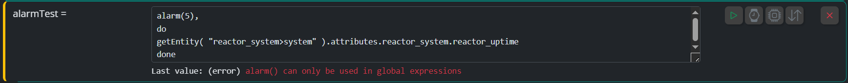

        First a question, is do...done in a Global expression considered out of scope to the function? because when alarm() is put in the statement block it shows error. When alarm() is put before the statement block it seems to be working a bit inconsistent, probably related to the observations further down.
        Another issue. I cleared the alarmTest, restarted Reactor, hard refreshed browser and put
        alarm(5),
        getEntity( "reactor_system>system" ).attributes.reactor_system.reactor_uptime
        All good and now there's no error (and no statement block) but when I changed alarm(5) to alarm(10) and saved, on first tick, an error is logged and a minor misleading tick at 5000ms lingers but the + delay says 10000ms as expected. This error happens every time I change anything in the expression.

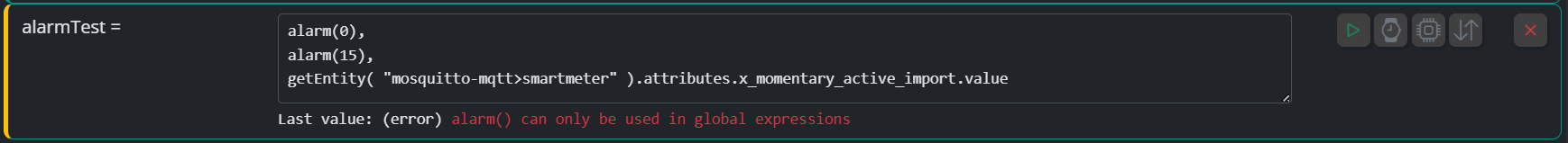

        Trying this, an entity that is updating faster than the tick. The GUI is flapping between error and OK value and the log goes crazy
        [latest-25310]2025-11-07T10:01:36.227Z <Engine:CRIT> Engine#1 alarmTest alarm() tick 5000ms
        [latest-25310]2025-11-07T10:01:36.227Z <Engine:CRIT> Engine#1 alarm(0) -- cancelling alarmTest timer
        [latest-25310]2025-11-07T10:01:36.227Z <Engine:CRIT> Engine#1 alarm() scheduled alarmTest tick for 1762509711227<2025-11-07 11:01:51> = now 1762509696227<2025-11-07 11:01:36> + delay 15000
        [latest-25310]2025-11-07T10:01:41.200Z <Engine:ERR> Engine#1: error evaluating expression alarmTest: [ReferenceError] alarm() can only be used in global expressions [-]
        [latest-25310]2025-11-07T10:01:41.200Z <Engine:ERR> Engine#1: expression: alarm(0),
        alarm(15),
        getEntity( "mosquitto-mqtt>smartmeter" ).attributes.x_momentary_active_import.value

            Testing with
            alarm(0),
            alarm(15),
            Same behavior in GUI, log:

            [latest-25310]2025-11-07T14:32:21.782Z <Engine:ERR> Engine#1: error evaluating expression alarmTest: [ReferenceError] alarm() can only be used in global expressions [-]
            [latest-25310]2025-11-07T14:32:21.782Z <Engine:ERR> Engine#1: expression: alarm(0),
            alarm(15),getEntity( "mosquitto-mqtt>smartmeter" ).attributes.x_momentary_active_import.value
            [latest-25310]2025-11-07T14:32:21.783Z <Engine:CRIT> ReferenceError: alarm() can only be used in global expressions [-]

              Can you show me an alarm tick message?
                Yes, if I lower the tick to 2000ms it's logged (different from before)
                [latest-25310]2025-11-07T14:42:21.833Z <Engine:CRIT> Engine#1 alarm() scheduled alarmTest tick for 1762526543833<2025-11-07 15:42:23> = now 1762526541833<2025-11-07 15:42:21> + delay 2000
                [latest-25310]2025-11-07T14:42:23.833Z <Engine:CRIT> Engine#1 alarmTest alarm() tick
                [latest-25310]2025-11-07T14:42:23.833Z <Engine:CRIT> Engine#1 alarm(0) -- cancelling alarmTest timer
                  Odd. I'm not able to duplicate this, and there's a message missing from the log that I would expect to see in conjunction with the other messages. Can you re-apply the build and restart, and try again?
                    I downloaded it again, re-applied and restarted.
                    Changed entity to eliminate any issues with my x_mqtt entity but same behavior and this is whats logged at Engine level 4

                            [latest-25310]2025-11-07T16:16:41.926Z <Engine:INFO> Engine#1 evaluating global poolHeat expression do
                              selling = getEntity( "virtual>time_series_selling" ).attributes.power_sensor.value,
                              buying = getEntity( "mosquitto-mqtt>smartmeter" ).attributes.x_momentary_active_import.value,
                              rule = isRuleSet("rule-l3wyah83"),
                            case
                              when selling >= 1.8 : bool(true)
                              when buying < 0.8 and rule : bool(true)
                              when poolHeatTrigger == "on" : bool(true)
                              else bool(false)
                            end
                            done source global

                            [latest-25310]2025-11-07T16:16:47.368Z <Engine:NOTICE> Engine#1 expression alarmTest has changed
                            [latest-25310]2025-11-07T16:16:47.369Z <Engine:INFO> Engine#1 _compile_global_expr alarmTest
                            [latest-25310]2025-11-07T16:16:47.369Z <Engine:INFO> Engine#1 global expression alarmTest refers to: Array(0) []
                            [latest-25310]2025-11-07T16:16:47.369Z <Engine:INFO> Engine#1 evaluating global alarmTest expression alarm(0),
                            alarm(15),
                            getEntity( "hass>sensor_momentary_active_import" ).attributes.string_sensor.value source global
                            [latest-25310]2025-11-07T16:16:47.369Z <Engine:INFO> Engine#1 global expression alarmTest old value=hello
                            [latest-25310]2025-11-07T16:16:47.369Z <Engine:INFO> Engine#1 evaluation context { "__lvar": { "MAXINT": 9007199254740991, "MININT": -9007199254740991, "MAXFLOAT": 1.7976931348623157e+308, "MINFLOAT": 5e-324, "testHere": "test", "chargeAmps": 16, "poolHeat": false, "poolHeatTrigger": "auto", "Växthuset": { "LYWSD03aa6def": { "x_mqtt_device": { "online": true, "templates": Array(1) ["tasmota_sensor_lyw"] }, "temperature_sensor": { "value": 7.3, "units": "C" }, "humidity_sensor": { "value": 96, "units": "%" }, "battery_power": { "level": 0.75, "since": 1762532173549, "alert_level": 0.5 }, "reactor_entity": {  } }, "Flora1": { "x_mqtt_device": { "online": true, "templates": Array(1) ["my_tasmota_sensor_flora"] }, "temperature_sensor": { "value": 10.3, "units": "C" }, "light_sensor": { "value": 0, "units": "lux" }, "humidity_sensor": { "value": 0, "units": "%" }, "value_sensor": { "value": 0, "units": (null) }, "reactor_entity": {  } }, "Flora1_Lux": 0.0001, "Flora2": { "x_mqtt_device": { "online": true, "templates": Array(1) ["my_tasmota_sensor_flora"] }, "temperature_sensor": { "value": 8.4, "units": "C" }, "light_sensor": { "value": 618, "units": "lux" }, "humidity_sensor": { "value": 0, "units": "%" }, "value_sensor": { "value": 0, "units": (null) }, "reactor_entity": {  } }, "Flora2_Lux": 618 }, "Medeltemp": 8.67, "Luftfuktighet": 1.1162790697674418, "EzloDevicesNotResponding": Array(0) [], "prevEzloDevicesNotResponding": Array(0) [], "VeraDevicesNotResponding": Array(0) [], "openLuupWasDown": "No", "Charging": false, "ReactorRestarted": false, "HumOutdoor": 86, "TempOutdoor": 8.82, "Självförsörjande": 0, "Elpris": 178.405, "restartCameraRTSP": false, "lovVecka": false, "VVBsellingHigh": false, "HassElpriser": { "buy_sek": 1.86, "sell_sek": 1.53 }, "chargeNow": false, "alertBLE": true, "ElpriserMedelMedian": "Idag:86/87, Imorgon:78/65", "ChargingPaused": false, "alertElmatare": false, "functions": "Global functions", "functionsDEV": "Global functions", "alarmTest": "hello" }, "__depth": 0, "__tag": "$global", "__func": { "_compare": [Function (anonymous) (?,?,?)], "fileRead": [Function (anonymous) (?,?,?)], "fileWrite": [Function (anonymous) (?,?,?,?)], "fileExists": [Function (anonymous) (?,?)], "dumpVars": [Function (anonymous) (?)], "strftime": [Function (anonymous) (?)], "format": [Function (anonymous) (?)], "geodist": [Function (anonymous) (?)], "_assign": [Function (anonymous) (?,?,?)], "getEntity": [Function _0x498020 (?,?)], "entity": [Function _0x498020 (?,?)], "$": [Function _0x498020 (?,?)], "matchEntities": [Function (anonymous) (?,?)], "groupMembers": [Function (anonymous) (?,?)], "performAction": [Function _0x498020 (?,?,?,?)], "perform": [Function _0x498020 (?,?,?,?)], "getRule": [Function (anonymous) (?,?)], "isRuleSet": [Function (anonymous) (?,?)], "isRuleEnabled": [Function (anonymous) (?,?)], "alarm": [Function (anonymous) (?)], "getPrices": [Function (anonymous) (?)], "getSlots": [Function (anonymous) (?)], "cheapestHours": [Function (anonymous) (?)], "VVBdayRange": [Function (anonymous) (?)], "getChargingTime": [Function (anonymous) (?)], "getPricesOLD": [Function (anonymous) (?)], "SlotsOLD": [Function (anonymous) (?)], "cheapestHoursOLD": [Function (anonymous) (?)], "getChargingTimeOLD": [Function (anonymous) (?)] }, "__global": { "__lvar": (seen=.__lvar), "__depth": 0, "__tag": "$global", "__func": (seen=.__func), "__global": (seen=.__global), "__tree": Array(1) ["alarmTest"] }, "__tree": (seen=.__global.__tree) }
                            [latest-25310]2025-11-07T16:16:47.371Z <Engine:CRIT> Engine#1 alarm(0) -- cancelling alarmTest timer
                            [latest-25310]2025-11-07T16:16:47.371Z <Engine:CRIT> Engine#1 alarm() scheduled alarmTest tick for 1762532222371<2025-11-07 17:17:02> = now 1762532207371<2025-11-07 17:16:47> + delay 15000
                            [latest-25310]2025-11-07T16:16:47.371Z <Engine:INFO> Engine#1 getEntity evaluating global alarmTest with ValueSensor#hass>sensor_momentary_active_import dependency
                            [latest-25310]2025-11-07T16:16:47.371Z <Engine:INFO> Engine#1 expr alarmTest result changed=true, was hello now "1.123"
                            [latest-25310]2025-11-07T16:16:47.372Z <Engine:INFO> Engine#1 notify() expression state change GlobalExpression#alarmTest
                            [latest-25310]2025-11-07T16:16:47.373Z <Engine:INFO> Engine#1 var alarmTest changed, evaluating dependents {  }

                                [latest-25310]2025-11-07T16:16:51.930Z <Engine:INFO> Engine#1 global expression poolHeat old value=false
                                [latest-25310]2025-11-07T16:16:51.930Z <Engine:INFO> Engine#1 evaluation context { "__lvar": { "MAXINT": 9007199254740991, "MININT": -9007199254740991, "MAXFLOAT": 1.7976931348623157e+308, "MINFLOAT": 5e-324, "testHere": "test", "chargeAmps": 16, "poolHeat": false, "poolHeatTrigger": "auto", "Växthuset": { "LYWSD03aa6def": { "x_mqtt_device": { "online": true, "templates": Array(1) ["tasmota_sensor_lyw"] }, "temperature_sensor": { "value": 7.3, "units": "C" }, "humidity_sensor": { "value": 96, "units": "%" }, "battery_power": { "level": 0.75, "since": 1762532173549, "alert_level": 0.5 }, "reactor_entity": {  } }, "Flora1": { "x_mqtt_device": { "online": true, "templates": Array(1) ["my_tasmota_sensor_flora"] }, "temperature_sensor": { "value": 10.3, "units": "C" }, "light_sensor": { "value": 0, "units": "lux" }, "humidity_sensor": { "value": 0, "units": "%" }, "value_sensor": { "value": 0, "units": (null) }, "reactor_entity": {  } }, "Flora1_Lux": 0.0001, "Flora2": { "x_mqtt_device": { "online": true, "templates": Array(1) ["my_tasmota_sensor_flora"] }, "temperature_sensor": { "value": 8.4, "units": "C" }, "light_sensor": { "value": 618, "units": "lux" }, "humidity_sensor": { "value": 0, "units": "%" }, "value_sensor": { "value": 0, "units": (null) }, "reactor_entity": {  } }, "Flora2_Lux": 618 }, "Medeltemp": 8.67, "Luftfuktighet": 1.1162790697674418, "EzloDevicesNotResponding": Array(0) [], "prevEzloDevicesNotResponding": Array(0) [], "VeraDevicesNotResponding": Array(0) [], "openLuupWasDown": "No", "Charging": false, "ReactorRestarted": false, "HumOutdoor": 86, "TempOutdoor": 8.82, "Självförsörjande": 0, "Elpris": 178.405, "restartCameraRTSP": false, "lovVecka": false, "VVBsellingHigh": false, "HassElpriser": { "buy_sek": 1.86, "sell_sek": 1.53 }, "chargeNow": false, "alertBLE": true, "ElpriserMedelMedian": "Idag:86/87, Imorgon:78/65", "ChargingPaused": false, "alertElmatare": false, "functions": "Global functions", "functionsDEV": "Global functions", "alarmTest": "1.123" }, "__depth": 0, "__tag": "$global", "__func": { "_compare": [Function (anonymous) (?,?,?)], "fileRead": [Function (anonymous) (?,?,?)], "fileWrite": [Function (anonymous) (?,?,?,?)], "fileExists": [Function (anonymous) (?,?)], "dumpVars": [Function (anonymous) (?)], "strftime": [Function (anonymous) (?)], "format": [Function (anonymous) (?)], "geodist": [Function (anonymous) (?)], "_assign": [Function (anonymous) (?,?,?)], "getEntity": [Function _0x498020 (?,?)], "entity": [Function _0x498020 (?,?)], "$": [Function _0x498020 (?,?)], "matchEntities": [Function (anonymous) (?,?)], "groupMembers": [Function (anonymous) (?,?)], "performAction": [Function _0x498020 (?,?,?,?)], "perform": [Function _0x498020 (?,?,?,?)], "getRule": [Function (anonymous) (?,?)], "isRuleSet": [Function (anonymous) (?,?)], "isRuleEnabled": [Function (anonymous) (?,?)], "alarm": [Function (anonymous) (?)], "getPrices": [Function (anonymous) (?)], "getSlots": [Function (anonymous) (?)], "cheapestHours": [Function (anonymous) (?)], "VVBdayRange": [Function (anonymous) (?)], "getChargingTime": [Function (anonymous) (?)], "getPricesOLD": [Function (anonymous) (?)], "SlotsOLD": [Function (anonymous) (?)], "cheapestHoursOLD": [Function (anonymous) (?)], "getChargingTimeOLD": [Function (anonymous) (?)] }, "__global": { "__lvar": (seen=.__lvar), "__depth": 0, "__tag": "$global", "__func": (seen=.__func), "__global": (seen=.__global), "__alarmhandle": { "alarmTest": Timer(Timer#alarm:alarmTest) }, "__suppress_dependencies": true, "__tree": Array(1) ["poolHeat"] }, "__alarmhandle": (seen=.__global.__alarmhandle), "__suppress_dependencies": true, "__tree": (seen=.__global.__tree) }
                                [latest-25310]2025-11-07T16:16:51.930Z <Engine:INFO> Engine#1 expr poolHeat result changed=false, was false now false
                                [latest-25310]2025-11-07T16:16:51.932Z <Engine:INFO> Engine#1 evaluating global alarmTest expression alarm(0),
                                alarm(15),
                                [latest-25310]2025-11-07T16:16:51.932Z <Engine:INFO> Engine#1 global expression alarmTest old value="1.123"
                                [latest-25310]2025-11-07T16:16:51.932Z <Engine:INFO> Engine#1 evaluation context { "__lvar": { "MAXINT": 9007199254740991, "MININT": -9007199254740991, "MAXFLOAT": 1.7976931348623157e+308, "MINFLOAT": 5e-324, "testHere": "test", "chargeAmps": 16, "poolHeat": false, "poolHeatTrigger": "auto", "Växthuset": { "LYWSD03aa6def": { "x_mqtt_device": { "online": true, "templates": Array(1) ["tasmota_sensor_lyw"] }, "temperature_sensor": { "value": 7.3, "units": "C" }, "humidity_sensor": { "value": 96, "units": "%" }, "battery_power": { "level": 0.75, "since": 1762532173549, "alert_level": 0.5 }, "reactor_entity": {  } }, "Flora1": { "x_mqtt_device": { "online": true, "templates": Array(1) ["my_tasmota_sensor_flora"] }, "temperature_sensor": { "value": 10.3, "units": "C" }, "light_sensor": { "value": 0, "units": "lux" }, "humidity_sensor": { "value": 0, "units": "%" }, "value_sensor": { "value": 0, "units": (null) }, "reactor_entity": {  } }, "Flora1_Lux": 0.0001, "Flora2": { "x_mqtt_device": { "online": true, "templates": Array(1) ["my_tasmota_sensor_flora"] }, "temperature_sensor": { "value": 8.4, "units": "C" }, "light_sensor": { "value": 618, "units": "lux" }, "humidity_sensor": { "value": 0, "units": "%" }, "value_sensor": { "value": 0, "units": (null) }, "reactor_entity": {  } }, "Flora2_Lux": 618 }, "Medeltemp": 8.67, "Luftfuktighet": 1.1162790697674418, "EzloDevicesNotResponding": Array(0) [], "prevEzloDevicesNotResponding": Array(0) [], "VeraDevicesNotResponding": Array(0) [], "openLuupWasDown": "No", "Charging": false, "ReactorRestarted": false, "HumOutdoor": 86, "TempOutdoor": 8.82, "Självförsörjande": 0, "Elpris": 178.405, "restartCameraRTSP": false, "lovVecka": false, "VVBsellingHigh": false, "HassElpriser": { "buy_sek": 1.86, "sell_sek": 1.53 }, "chargeNow": false, "alertBLE": true, "ElpriserMedelMedian": "Idag:86/87, Imorgon:78/65", "ChargingPaused": false, "alertElmatare": false, "functions": "Global functions", "functionsDEV": "Global functions", "alarmTest": "1.123" }, "__depth": 0, "__tag": "$global", "__func": { "_compare": [Function (anonymous) (?,?,?)], "fileRead": [Function (anonymous) (?,?,?)], "fileWrite": [Function (anonymous) (?,?,?,?)], "fileExists": [Function (anonymous) (?,?)], "dumpVars": [Function (anonymous) (?)], "strftime": [Function (anonymous) (?)], "format": [Function (anonymous) (?)], "geodist": [Function (anonymous) (?)], "_assign": [Function (anonymous) (?,?,?)], "getEntity": [Function _0x498020 (?,?)], "entity": [Function _0x498020 (?,?)], "$": [Function _0x498020 (?,?)], "matchEntities": [Function (anonymous) (?,?)], "groupMembers": [Function (anonymous) (?,?)], "performAction": [Function _0x498020 (?,?,?,?)], "perform": [Function _0x498020 (?,?,?,?)], "getRule": [Function (anonymous) (?,?)], "isRuleSet": [Function (anonymous) (?,?)], "isRuleEnabled": [Function (anonymous) (?,?)], "alarm": [Function (anonymous) (?)], "getPrices": [Function (anonymous) (?)], "getSlots": [Function (anonymous) (?)], "cheapestHours": [Function (anonymous) (?)], "VVBdayRange": [Function (anonymous) (?)], "getChargingTime": [Function (anonymous) (?)], "getPricesOLD": [Function (anonymous) (?)], "SlotsOLD": [Function (anonymous) (?)], "cheapestHoursOLD": [Function (anonymous) (?)], "getChargingTimeOLD": [Function (anonymous) (?)] }, "__global": { "__lvar": (seen=.__lvar), "__depth": 0, "__tag": "$global", "__func": (seen=.__func), "__global": (seen=.__global), "__alarmhandle": { "alarmTest": Timer(Timer#alarm:alarmTest) }, "__suppress_dependencies": true, "__tree": Array(1) ["alarmTest"] }, "__alarmhandle": (seen=.__global.__alarmhandle), "__suppress_dependencies": true, "__tree": (seen=.__global.__tree) }
                                [latest-25310]2025-11-07T16:16:51.932Z <Engine:ERR> Engine#1: error evaluating expression alarmTest: [ReferenceError] alarm() can only be used in global expressions [-]
                                [latest-25310]2025-11-07T16:16:51.933Z <Engine:ERR> Engine#1: expression: alarm(0),
                                alarm(15),
                                [latest-25310]2025-11-07T16:16:51.945Z <Engine:INFO> Engine#1: path alarmTest->alarmTest
                                [latest-25310]2025-11-07T16:16:51.945Z <Engine:CRIT> ReferenceError: alarm() can only be used in global expressions [-]
                                    at /home/homebridge/reactor/server/lib/Engine.js:1455:23
                                    at _run (/home/homebridge/reactor/common/lexp.js:1704:34)

                                  Where else are you using that variable, and how?
                                    Nowhere, strictly to test the function before I put it in production
                                      #21
                                      It's not mentioned in a substitution somewhere?
                                        #22
                                        Sorry but no
                                          #23
                                          New variable, another entity but same error with alarm()
                                          There must be something off in my system then.
