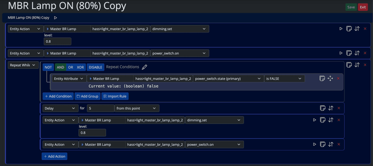

                This is the rule that was working:
                My other LIFX outdoor floods still work fine! I also noted that @Pmccraw is having this with another brand. My guess is that HA changed something because it started immediately after deployment of 11.0 (and I seem to recall some notes around dimming or some such but I just haven't been able to track it back).
                Here's a quick grab from the log file, best I can do atm.

                  I need to see device attributes for those devices (from the Entities list -- use Copy Attributes and paste as fenced code block, no screenshots please). Also would be helpful to see the hass_states.json and hass_services.json from the logs directory, but these are larger. If any of you are willing to upload them, let me know and I will provide you a link.
                  Edit: it looks like HA 2025.11.0 breaks the homeassistant domain commands (turn_on, turn_off). I'm digging more into that, to see if it's a change to their required parameter structure, or just brokeness, but HA does not reply with an error when those services are attempted, and that's usually what happens when parameters/service definition changes.
                  Edit 2: ...and a little more info. The service data published by the API in 2025.11.0 now omits the target data detail. That's odd. Maybe they are assuming that when target data is empty, just supply an entity? I need to dig through the release notes. But, easy to work around.
                    @toggledbits I was able to grab this between meetings lol
                    dimming.maximum=1
                    dimming.minimum=0
                    dimming.step=0.03
                    light_effect.current=null
                    light_effect.speed=null
                    power_switch.state=false
                    x_hass.domain="light"
                    x_hass.entity_id="light.master_br_lamp_lamp_2"
                    x_hass.services=["light","lifx"]
                    x_hass.source="lifx"
                    x_hass_attr.brightness=null
                    x_hass_attr.color_mode=null
                    x_hass_attr.effect=null
                    x_hass_attr.effect_list=["effect_pulse","effect_stop"]
                    x_hass_attr.friendly_name="Master BR Lamp"
                    x_hass_attr.supported_color_modes=["brightness"]
                    x_hass_attr.supported_features=36
                    *Hubitat C-7 2.5.1.142
                    Core 2026.7.4
                    MSR: latest-26193-8dd8f854
                      OK. I'm on this. See my previous post above yours. HA changes the way the definition of some services is published -- there's now no data/detail where there used to be data/detail. I'm not sure if that's an error they'll correct later, or if that's a new way of saying "just use the default behavior" (which in this case is pretty easy to guess). I will have a workaround update published shortly.
