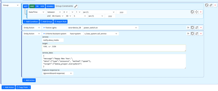

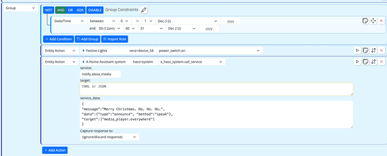

      @retireditguy Hmm, not sure if it's much help, or a parallel use case, but I have a couple of reactions that only work during the festive period. More explicitly there are additional actions which are constrained
      Here's one of my constraint groups which has been working fine this year and untouched since last year.
      And the second

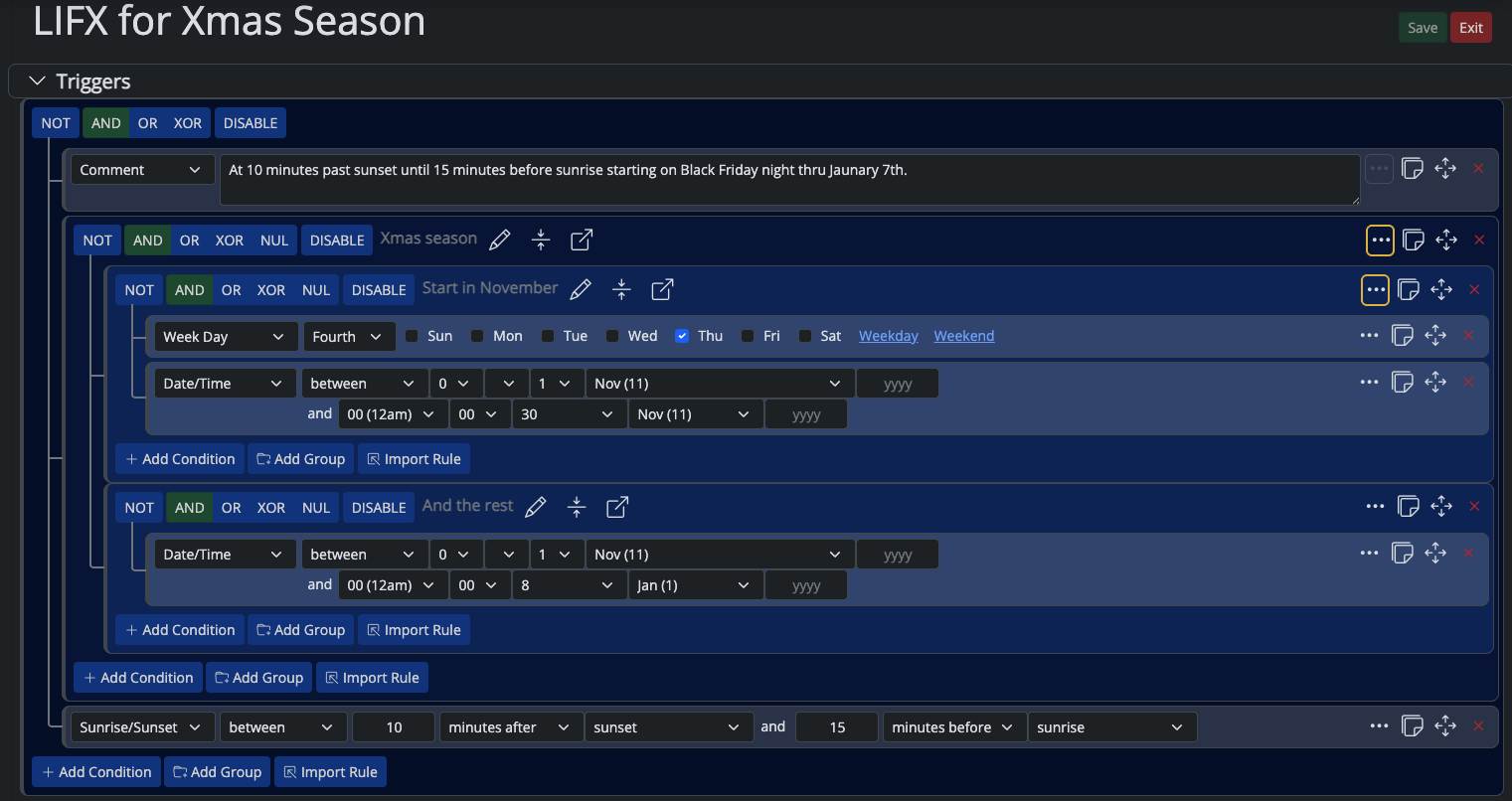

            @retireditguy here's my xmas which is tricky because it moves year-to-year based on starting the day after Thanksgiving:

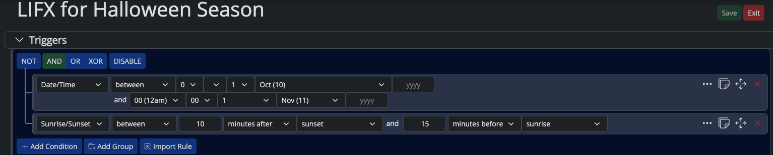

            And here's a more "traditional" one for a set date:
