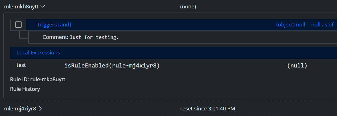

    Edit: Rule id needs to be quoted, e.g. isRuleEnabled( 'rule_id' )
    Bare metal 25325.
    I'm getting null in both global and local expressions for the function isRuleEnabled(). It doesn't matter if the rule is enabled or disabled. Let me know if you can't replicate and need logs at higher level or I'm doing something wrong.

      Please post a readable screen shot. I don't know what or how this one got posted, but it's tiny and low resolution and I can't see clearly what's in it.
        wrote on last edited by Crille
        Wow, those were in fact really bad! Sorry for that.
        Rule id rule-mj4xiyr8 is in this case Enabled
        Rule expression:
        rule_expr.PNG Global expression:
          Never mind. I found the issue, this works as expected isRuleEnabled('rule-mj4xiyr8') where the rule id needs to be quoted with ' or ".
          Not obvious in the docs, my bad for not testing that first.
