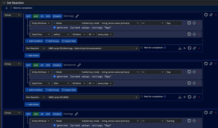

          @toggledbits how does this pertain to rulesets that have Groups in Set Reaction for different "scenarios", if you will.
          Example:
          I'm asking because this ruleset stopped working with 26116 and I'm so strapped on personal time atm that I just broke it out into three sep rulesets and each works correctly.
            Example:
            @gwp1 unrelated.
              @gwp1 unrelated.

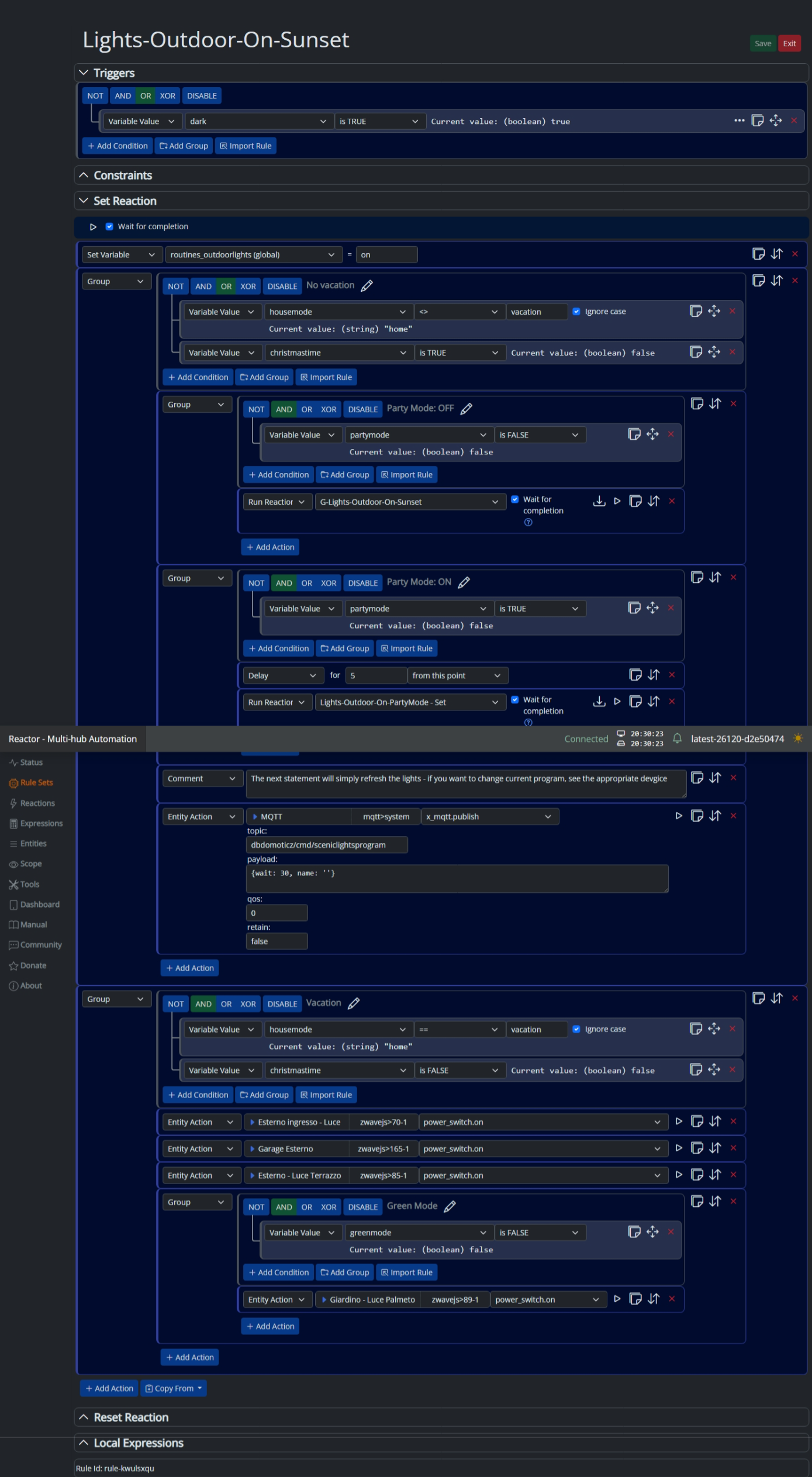

                                @toggledbits maybe it's related, but right now I have a similar problem.
                                Given these groups:
                                in this case, all are called.

                                this rule group is inside another rule group.
                                  Build 26127 just posted has a small change that hit the issue responsible for the misbehavior. If not, there's additional logging that may help point me in the right direction.
                                    @toggledbits unfortunately, this is still occurring with the new build. here's the log:

                                      OK. Please turn on log level 5 for that rule only. Run the rule to show the issue, and upload the entire Rule log file as well as reactor.log, the rule storage files (dval and json). Link for upload in your DMs
