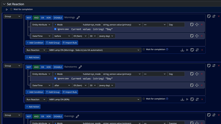

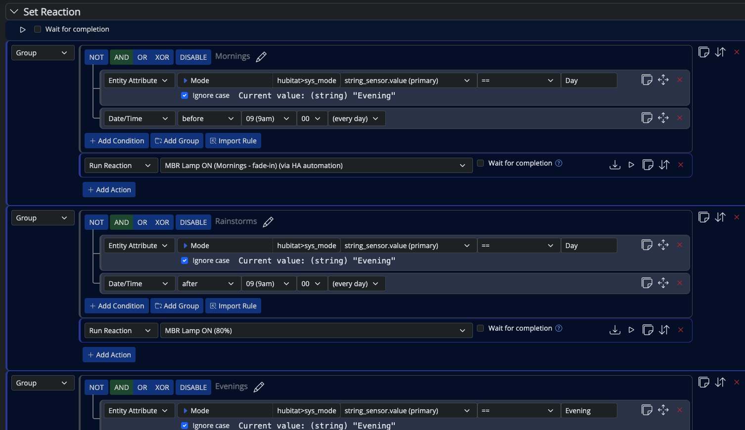

    I have some rules that have multiple Groups as the Set Reaction based on different scenarios. In one instance, it's a bedroom light that has three possible "outcomes": morning, evening, and rainstormers. If I break out the ruleset into three unique rulesets each works fine.

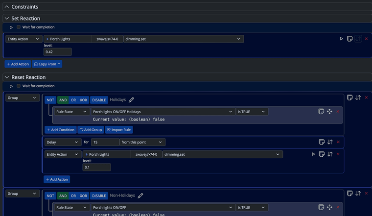

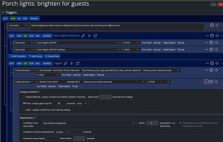

    Here's another instance that I caught tonight: porch lights that are supposed to react differently - but this time it's the Reset Reaction that's being ignored:
    Here are the log entries directly tied to this but I will upload the entire log to you @toggledbits
    [latest-26120]2026-05-02T01:17:35.641Z <Rule:INFO> Porch lights:  brighten for guests (rule-grpvl9oypg in Outdoor Lighting, Nightly) evaluated; rule state transition from SET to 'RESET'
    [latest-26120]2026-05-02T01:17:35.644Z <Engine:INFO> Enqueueing "Porch lights:  brighten for guests<RESET>" (rule-grpvl9oypg:R)
    [latest-26120]2026-05-02T01:17:35.655Z <Engine:NOTICE> Starting reaction Porch lights:  brighten for guests<RESET> (rule-grpvl9oypg:R)
    [latest-26120]2026-05-02T01:17:35.655Z <Engine:INFO> Porch lights:  brighten for guests<RESET> all actions completed.

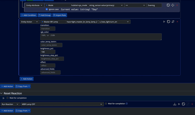

    The Set Reaction for the bedroom light looks like this:

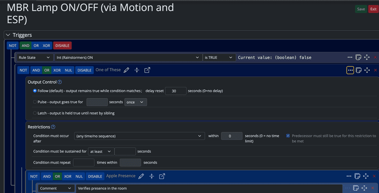

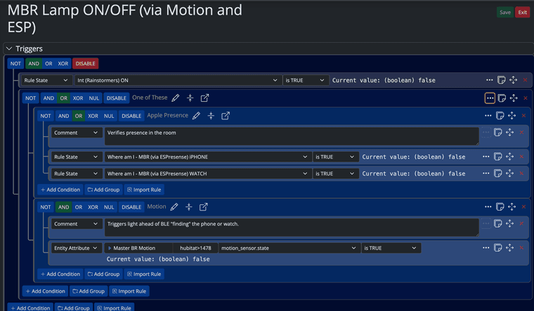

        These are two different rules. Here they are in full:
        Porch lights (logs provided last night)
        ef9ee6a2-76d8-4d3d-9c6b-5dcfee2202ce-image.png 121cc44a-044b-4a53-9afb-7dcf1ed0b4f3-image.png 661a73ac-720c-491c-9ba0-3bce4ad7a650-image.png
        Bedroom lamp (no logs yet)
        68e76156-884e-4b7e-b02a-15821c270c48-image.png aff1cdea-c532-4859-a4ee-cb82e443073f-image.png b31043fc-f69e-49ea-a62f-08fff3534bc1-image.png f94bd100-5ba2-455b-a638-d6c0cba9e595-image.png
        I'll try to grab logs on the second one today and put in the same Dropbox folder.

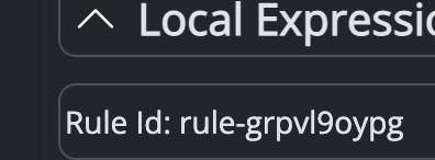

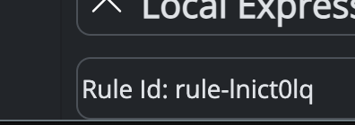

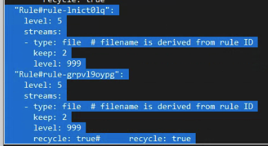

              @toggledbits Is this not correct?
              "Rule#rule-lnict0lq":
                  level: 5
                  streams:
                  - type: file  # filename is derived from rule ID
                    keep: 2
                    level: 999
                "Rule#rule-grpvl9oypg":
                  level: 5
                  streams:
                    keep: 2
                    level: 999
                    recycle: true#      recycle: true
              (It is in line...)

                wrote last edited by
                Looks OK. Check your IDs if you are not getting logs. The files will be named Logger#Rule#<ruleid>.log.
                  I copy-pasted the ruleID... restarted MSR. I know this worked previously, I had older rule-specific logs in my logs directory that I've since deleted and in fairness to me, I'd just commented out the prior entry from logging.yaml and reused it lol
                  What obvious thing am I missing here?
                    At this point I would need to see the entire config file. You could also run it through yamllint.com to make sure it's all OK (and remember, no tabs -- always spaces for indenting -- that's a common trap with some editors that "help" you during copy/paste).

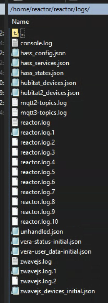

                          it fixed a couple for me, so definitely working! thanks!
                          PS: is it safe to delete the json files in the folder?
                          G toggledbitsT 2 Replies Last reply
                              @therealdb said in Rulesets with multiple groups in Set Reaction not working post-26116:
                              Which folder?
                                @toggledbits the one with the rules.
                                  @therealdb Yes!
