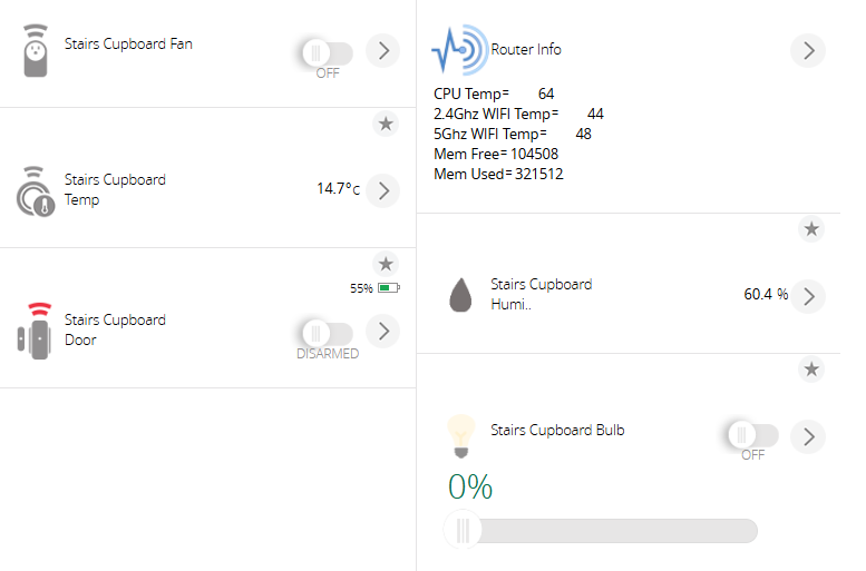

Edit: Fixed in re-spun 26328. (I just gave my old Ezlo Plus a new chance so it's running my z-wave devices in my garage, for evaluation, as my even older Vera Secure had issues reaching that far when some router nodes gave up). Bare metal latest-26328 Issue 1: Nodes don't update in Reactor after update from 26318. Issue 2: Also present in earlier builds, rooms don't add to DGC and throws error at start. Notice: No device mapping matches Intrusion Sensor. I don't know if you still support EzloController but seems like an easy fix? Let me know if you need more info! [latest-26328]2026-11-25T11:18:31.310Z <Controller:NOTICE> Controller HassController#hass is now online. [latest-26328]2026-11-25T11:18:31.313Z <EzloController:ERR> [TypeError] Cannot read properties of undefined (reading 'clear') [-] failed to process rooms: [undefined2] [latest-26328]2026-11-25T11:18:31.313Z <EzloController:CRIT> TypeError: Cannot read properties of undefined (reading 'clear') [-] TypeError: Cannot read properties of undefined (reading 'clear') at EzloController._process_hub_rooms (/home/homebridge/reactor/server/lib/EzloController.js:1558:153) at /home/homebridge/reactor/server/lib/EzloController.js:1388:48 at process.processTicksAndRejections (node:internal/process/task_queues:104:5) [latest-26328]2026-11-25T11:18:31.314Z <wsapi:INFO> wsapi: connection from "192.168.1.2" [latest-26328]2026-11-25T11:18:31.452Z <wsapi:INFO> wsapi: connection from "192.168.1.2" [latest-26328]2026-11-25T11:18:31.585Z <EzloController:ERR> EzloController#ezlo error creating entity Switch#ezlo>device_6b02d1d9129e0715b720f005: [TypeError] _0xf38820[_0x376e98(...)].update is not a function [-] [latest-26328]2026-11-25T11:18:31.585Z <EzloController:CRIT> TypeError: _0xf38820[_0x376e98(...)].update is not a function [-] TypeError: _0xf38820[_0x376e98(...)].update is not a function at /home/homebridge/reactor/server/lib/EzloController.js:1649:58 at Array.forEach (<anonymous>) at EzloController._process_hub_devices (/home/homebridge/reactor/server/lib/EzloController.js:1597:226) at /home/homebridge/reactor/server/lib/EzloController.js:1418:54 at process.processTicksAndRejections (node:internal/process/task_queues:104:5) [latest-26328]2026-11-25T11:18:31.588Z <EzloController:ERR> EzloController#ezlo error creating entity SecuritySensor#ezlo>device_6b02d41d129e0715b720f012: [TypeError] _0xf38820[_0x376e98(...)].update is not a function [-] [latest-26328]2026-11-25T11:18:31.588Z <EzloController:CRIT> TypeError: _0xf38820[_0x376e98(...)].update is not a function [-] TypeError: _0xf38820[_0x376e98(...)].update is not a function at /home/homebridge/reactor/server/lib/EzloController.js:1649:58 at Array.forEach (<anonymous>) at EzloController._process_hub_devices (/home/homebridge/reactor/server/lib/EzloController.js:1597:226) at /home/homebridge/reactor/server/lib/EzloController.js:1418:54 at process.processTicksAndRejections (node:internal/process/task_queues:104:5) [latest-26328]2026-11-25T11:18:31.590Z <EzloController:ERR> EzloController#ezlo no device mapping matches Intrusion Sensor ("6b02d41e129e0715b720f01c") -- skipped [latest-26328]2026-11-25T11:18:31.591Z <EzloController:ERR> EzloController#ezlo error creating entity SecuritySensor#ezlo>device_6b02d9d9129e0715b720f01f: [TypeError] _0xf38820[_0x376e98(...)].update is not a function [-] [latest-26328]2026-11-25T11:18:31.591Z <EzloController:CRIT> TypeError: _0xf38820[_0x376e98(...)].update is not a function [-] TypeError: _0xf38820[_0x376e98(...)].update is not a function at /home/homebridge/reactor/server/lib/EzloController.js:1649:58 at Array.forEach (<anonymous>) at EzloController._process_hub_devices (/home/homebridge/reactor/server/lib/EzloController.js:1597:226) at /home/homebridge/reactor/server/lib/EzloController.js:1418:54 at process.processTicksAndRejections (node:internal/process/task_queues:104:5) [latest-26328]2026-11-25T11:18:31.591Z <EzloController:ERR> EzloController#ezlo no device mapping matches Intrusion Sensor ("6b02d9da129e0715b720f029") -- skipped [latest-26328]2026-11-25T11:18:31.682Z <EzloController:INFO> EzloController#ezlo hub inventory complete/successful; 2159ms [latest-26328]2026-11-25T11:18:31.684Z <Controller:NOTICE> Controller EzloController#ezlo is now online.
Edit: Fixed in 26328. Bare metal latest-26318. I tried to add the group "ArmedSensors" but it would not show in UI. "ArmedSensors": name: Armed Sensors select: - include_capability: arming filter_expression: entity.attributes.arming.state The log: [latest-26318]2026-11-24T14:15:20.412Z <DynamicGroupController:ERR> DynamicGroupController#groups error updating dynamic group ArmedSensors: [TypeError] Cannot read properties of undefined (reading 'extendCapability') [-] [latest-26318]2026-11-24T14:15:20.412Z <DynamicGroupController:CRIT> TypeError: Cannot read properties of undefined (reading 'extendCapability') [-] TypeError: Cannot read properties of undefined (reading 'extendCapability') at DynamicGroupController._update_group (/home/homebridge/reactor/server/lib/DynamicGroupController.js:128:18) at DynamicGroupController._update (/home/homebridge/reactor/server/lib/DynamicGroupController.js:483:43) at process.processTicksAndRejections (node:internal/process/task_queues:104:5) at async DynamicGroupController.start (/home/homebridge/reactor/server/lib/DynamicGroupController.js:60:13) at async Promise.allSettled (index 3) Nothing related before or after that I could find. I then copied an existing group to exclude type errors in the new group. "OKforLarm": name: OK för Larm select: - include_capability: door_sensor filter_expression: entity.attributes.door_sensor.state "OKforLarm2": name: "OK för Larm 2" select: - include_capability: door_sensor filter_expression: entity.attributes.door_sensor.state Same error in log. [latest-26318]2026-11-24T14:18:29.793Z <DynamicGroupController:ERR> DynamicGroupController#groups error updating dynamic group OKforLarm2: [TypeError] Cannot read properties of undefined (reading 'extendCapability') [-] [latest-26318]2026-11-24T14:18:29.793Z <DynamicGroupController:CRIT> TypeError: Cannot read properties of undefined (reading 'extendCapability') [-] TypeError: Cannot read properties of undefined (reading 'extendCapability') at DynamicGroupController._update_group (/home/homebridge/reactor/server/lib/DynamicGroupController.js:128:18) at DynamicGroupController._update (/home/homebridge/reactor/server/lib/DynamicGroupController.js:483:43) at process.processTicksAndRejections (node:internal/process/task_queues:104:5) at async DynamicGroupController.start (/home/homebridge/reactor/server/lib/DynamicGroupController.js:60:13) at async Promise.allSettled (index 3) [latest-26318]2026-11-24T14:18:29.806Z <DynamicGroupController:ERR> DynamicGroupController#groups error updating dynamic group ArmedSensors: [TypeError] Cannot read properties of undefined (reading 'extendCapability') [-] [latest-26318]2026-11-24T14:18:29.806Z <DynamicGroupController:CRIT> TypeError: Cannot read properties of undefined (reading 'extendCapability') [-] TypeError: Cannot read properties of undefined (reading 'extendCapability') at DynamicGroupController._update_group (/home/homebridge/reactor/server/lib/DynamicGroupController.js:128:18) at DynamicGroupController._update (/home/homebridge/reactor/server/lib/DynamicGroupController.js:483:43) at process.processTicksAndRejections (node:internal/process/task_queues:104:5) at async DynamicGroupController.start (/home/homebridge/reactor/server/lib/DynamicGroupController.js:60:13) at async Promise.allSettled (index 3) Let me know if I missed something or you need more info.

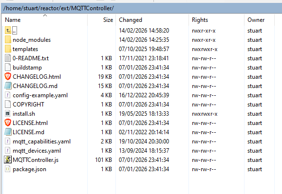

    In my file system it looks like this:
    I am not sure what I am missing?

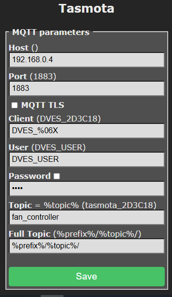

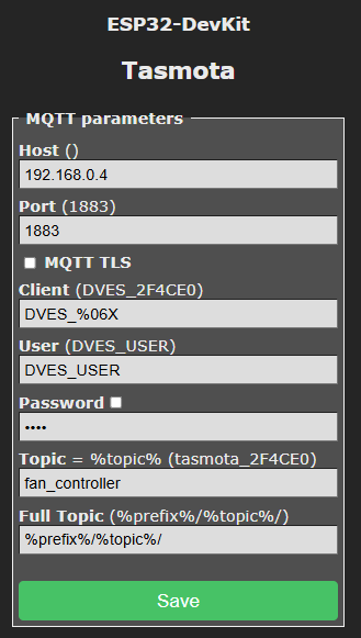

        Please show more of the Tasmota device configuration (screen shots), so we can help you with that.
        Some more details:
        Hardware:
        ESP32-WROOM-32
        Chip Information -
        XX5R69
        Silabs CP2102
        DCL00X
        2108+
        Computer Fan is 12V with external DC power supply
        Relay (SRD-05VDC-SL-C) (Single Channel)
        TTP223B Touch Sensor
        DHT22 Temperature Humidity Sensor
        I used one of these expansion boards what the ESP32 board sits into, as it gives you more pins to connect multiple sensor etc. Like it gives you more pins for the 3.3V and 5V for example.
        Pinout:
        TTP223B Touch Sensor (Signal Wire) -> GPIO_IN:4 (Input)
        Relay (SRD-05VDC-SL-C) (Signal Wire) -> GPIO_OUT:27 (Output)
        DHT22 Temperature Humidity Sensor (Signal Wire) -> GPIO:5
        There is an "Information" button in the Tasmota device webpage that also shows a lot of device info if you want that also?

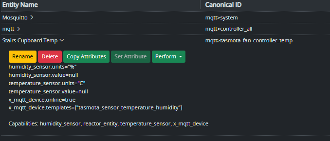

                  Thanks, now MSR reads the reactor.yaml file as it shows me the Vera controllers etc. But I am seeing this alert now:
                  "controller "Mosquitto" (undefined mqtt) could not be loaded at startup due to error. See the log."
                  I looked in the reactor.log and all its rotations but could not see any mention of MQTT.
                  I also checked the reactor.yaml file on that website and it says its valid.
                  i then changed this "interface: MQTTController" to this "implementation: MQTTController" and restarted and now I can see the MQTT Controller again under Entities.
                  I then waited like 10 minutes to see if any new "fan_controller" devices would appear ? And nothing does. Searching the logs again for "mqtt" there are no search matches. Also cannot see a mqtt-topics.log file in the logs folder.

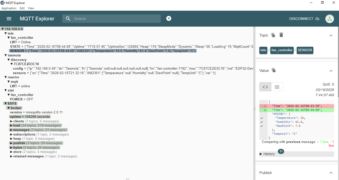

                    MQTT Explorer is good for troubleshooting to make sure your data is actually getting to the broker IME
                    cw-kidC Offline
                    cw-kidC Offline
                    @CatmanV2 said in Struggling to setup my first Tasmota device and MQTT:
                    Thanks I will check that out.

                            name: "Tasmota Fan Controller"
                            topic: fan_controller  # matches topic configured in Tasmota
                            unit: 1  # relay number on the device
                            include:
                                - tasmota_generic_relay
                                - tasmota_sensor_temperature_humidity
                            channel: 10
                      Didn't help however adding Channel still no new entities appearing.
                      Just seen this also:
                      "notably Tasmota, do not have MQTT retain on by default (a poor choice for IoT devices, IMO). On Tasmota devices, you can turn it on by using the PowerRetain on, SwitchRetain on, SensorRetain on and StateRetain on commands in the Tasmota console."
                      I will run those commands now.

                          In you case, as per the post, topic: "tasmota-dehum" should be topic: "fan_controller", while sourceshould beAM2301`.

                              I could then finally see an Entity for it in MSR for the Temp sensor. But with no data values as yet its null.
                              That obviously only imported the DHT22 (AM230) Temp sensor part.
                              I then tried to add this to also include the 1 channel Relay part.

                              So just not sure why I have no data from the Temp sensor currently.
                                @cw-kid post some screenshots from mqtt explorer. It’s easier to follow, if you want my advice.
                                • cw-kidC Offline
                                  cw-kidC Offline
                                  Its working now, a wire came off the ESP board for the DHT22 which is why it was null. I connected the wire again and now I see data in MSR.

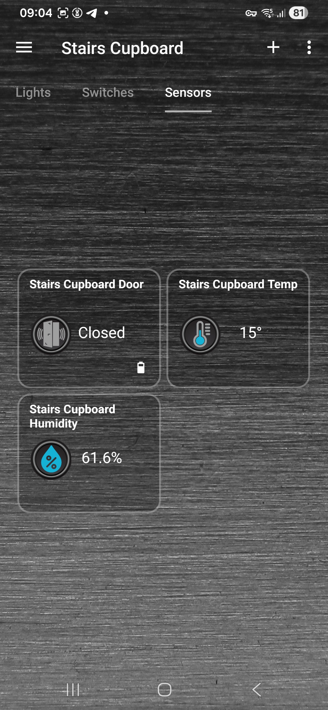

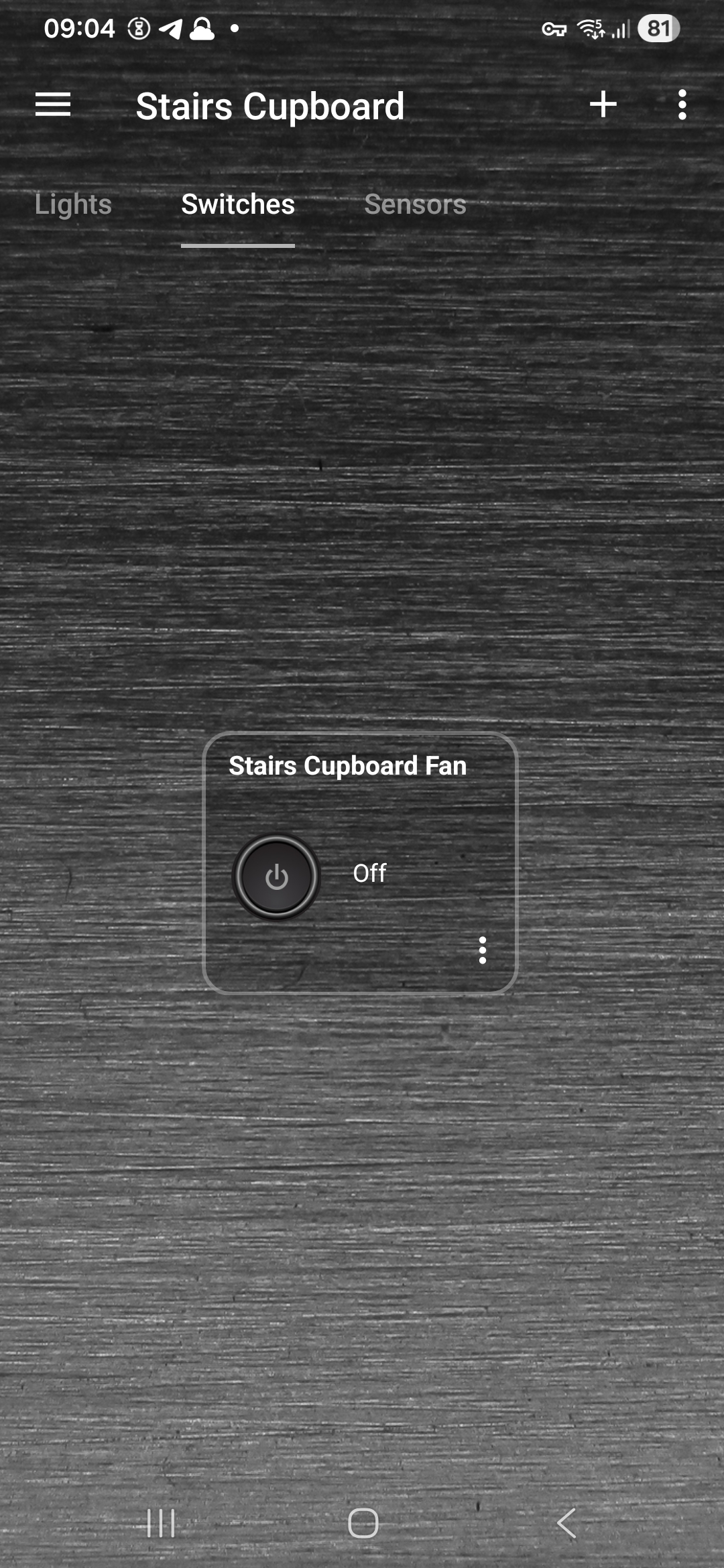

                                      Sweet everything appears to be working now, I created some virtual devices in Vera for the Temp and Humidity and some new MSR rules to push those values to them in Vera if they change.
                                      Updated my Home Remote dashboard and I can see them on my phone now and also have a switch to turn the Fan on and off..
                                      1000000328.jpg !
                                      1000000330.jpg !

                                          Actually I do have one issue: power_switch.state=null
                                          It seems MSR is not seeing what the state of the relay currently is? Which is causing me an issue now in a rule I am trying to create.
                                          If I run this command in terminal on the MSR / MQTT broker box
                                          :~mosquitto_sub -v -t 'tele/fan_controller/#' -t 'stat/fan_controller/#'
                                          I see this:
                                          tele/fan_controller/LWT Online
                                          tele/fan_controller/STATE {"Time":"2026-02-16T18:38:48","Uptime":"0T03:13:09","UptimeSec":11589,"Heap":113,"SleepMode":"Dynamic","Sleep":50,"LoadAvg":19,"MqttCount":1,"Berry":{"HeapUsed":4,"Objects":50},"POWER":"OFF","Wifi":{"AP":1,"SSId":"ASUS_86_2G","BSSId":"04:D9:F5:74:C5:E0","Channel":3,"Mode":"HT40","RSSI":100,"Signal":-20,"LinkCount":1,"Downtime":"0T00:00:04"},"Hostname":"Stairs-Cupboard-Fan-ESP32","IPAddress":"192.168.0.49"}
                                          tele/fan_controller/SENSOR {"Time":"2026-02-16T18:38:48","AM2301":{"Temperature":21.2,"Humidity":47.9,"DewPoint":9.7},"TempUnit":"C"}
                                          stat/fan_controller/POWER OFF
                                          Which is correct, the fan is currently off.
                                          So maybe the yaml code is not quite right if its not seeing the state of the relay.
                                          I can turn on / off the relay however via MSR so it is talking to it somewhat.
