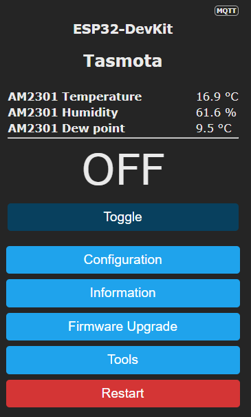

Some more details:
Hardware:
ESP32-WROOM-32
Chip Information -
XX5R69
Silabs CP2102
DCL00X
2108+Computer Fan is 12V with external DC power supply
Relay (SRD-05VDC-SL-C) (Single Channel)
TTP223B Touch Sensor
DHT22 Temperature Humidity SensorI used one of these expansion boards what the ESP32 board sits into, as it gives you more pins to connect multiple sensor etc. Like it gives you more pins for the 3.3V and 5V for example.
Pinout:
TTP223B Touch Sensor (Signal Wire) -> GPIO_IN:4 (Input)
Relay (SRD-05VDC-SL-C) (Signal Wire) -> GPIO_OUT:27 (Output)
DHT22 Temperature Humidity Sensor (Signal Wire) -> GPIO:5There is an "Information" button in the Tasmota device webpage that also shows a lot of device info if you want that also?
