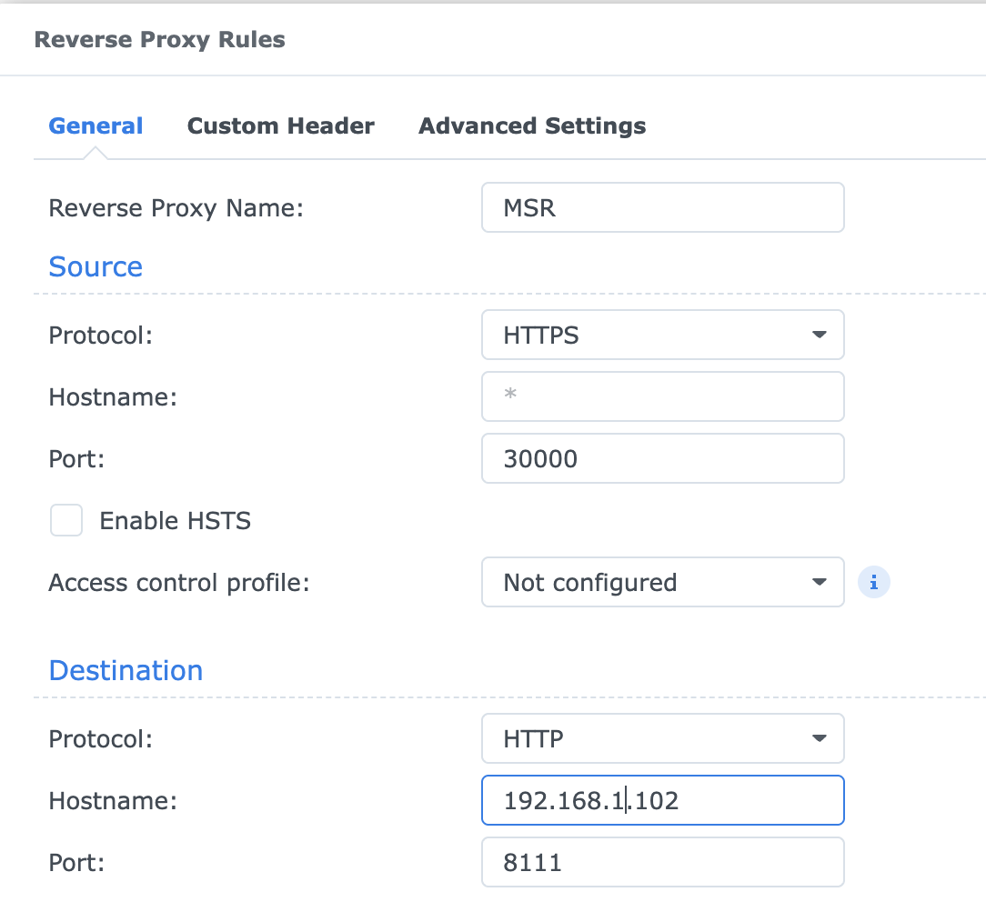

                  @therealdb although I used only IP addresses and not dns names, I wasn't able to get UI to load. In my setup I'm using MSR in a docker container network and not host networking, so that might cause some additional headaches.
                  So could you share your configuration (e.g Synology reverse proxy conf, baseurl ...)? Obviously no need to use real IPs. I'm also wondering if https configuration in MSR can be avoided (not using that at the moment), but using let's encrypt cert in DSM. Port forwardings & firewall settings shouldn't be an issue, as /api/v1/log page works fine.

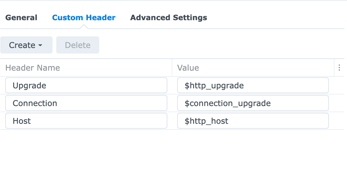

                    sorry, I'm on a tour right now. I have a similar config, but I configured a specific host name and I'm on the standard HTTPs port.
                    maybe this is useful
