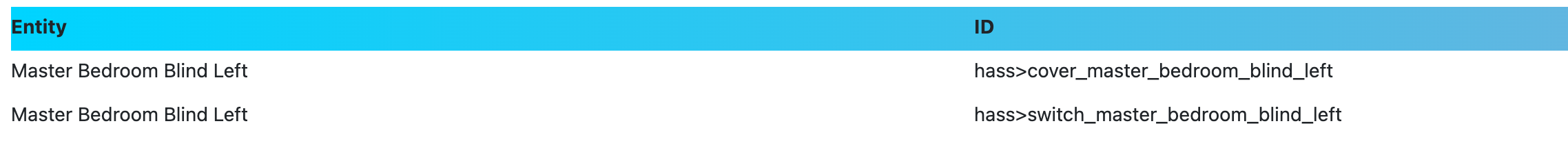

    I've run across a quirk with my iBlinds motors in Home Assistant. Each iBlinds zwave motor has two controls that I can use. One is a switch, and one is a cover control.
    ee654e5d-d191-4082-a7f2-6b161923de75-image.png cid:A1190F3F-FB02-4332-93DE-9A15A490D9AB
    The switch control is a binary on/off switch. On, the blind goes to the "open" position (v2 controllers, 50%, v3 controllers user definable parameter)
    If you click on the cover icon, it moves between two positions. Essentially, it's closed in both positions, just 180 degrees apart. The cover control does give you the granularity to move to any position between 0 and 100, which is sometimes useful, when you just don't want it open or closed, such as letting some light in, but closing it enough when the sun is shining directly into the window and blinding everyone.

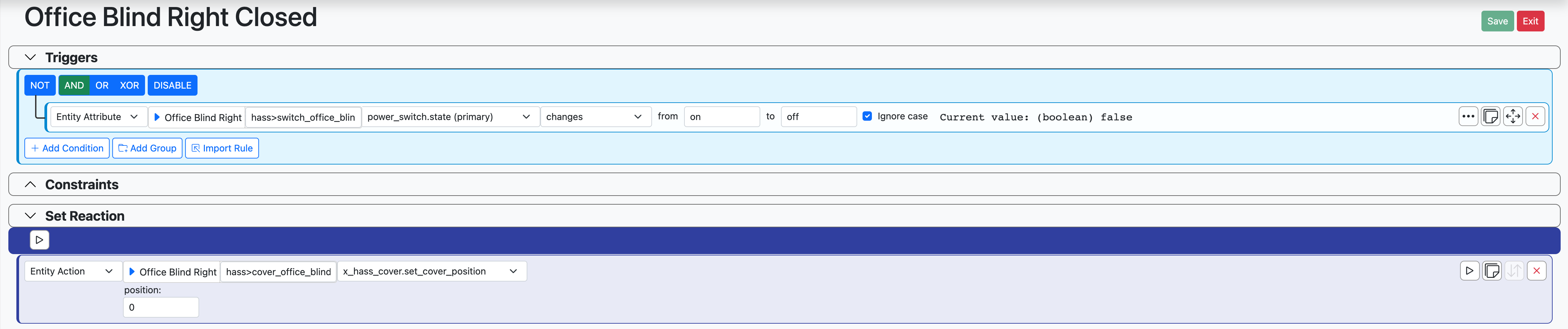

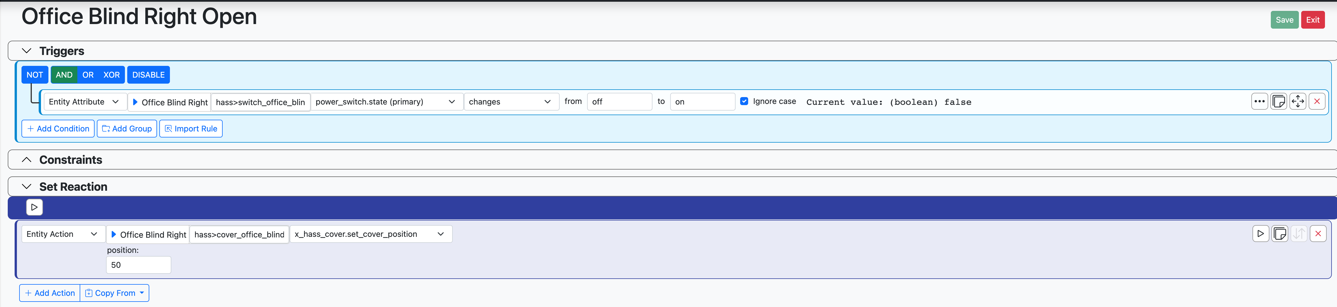

    I've come up with a Reactor work around which sort of forces the controls to update. If anyone knows of a better way, please tell me. I have two rules set up that monitor for changes in the switch state, that then performs a x_haas_cover.set_cover_position to either 0 or 50 for either to off or to on respectively.
    This is sort of a one way street at the moment. I don't have a reverse rule set up to change the switch value, but the current rule seems more of an issue.
    All that being said. I have 14 iBlinds motors in my home. That would mean 28 rules in Reactor. I know how to set up a Dynamic Group Control for Triggers. I put all 14 switches in the reactor.yaml file, and I can use those for triggers. How would I go about using 14 corresponding cover controls for the reactions?
    It may be a simple matter, but I'm not sure. One thing i can say is the name of the switch and cover entities are the same, except for the control type:

                    The rule I'm trying to set up is to look for any change on those switches (on to off or off to on), and then set a reaction to refresh the cover (zwave_device.refresh)
                    In the set reaction, it doesn't appear to let my dig down any further once I put the group in. What do I need to do to make this work, if it's even possible.
