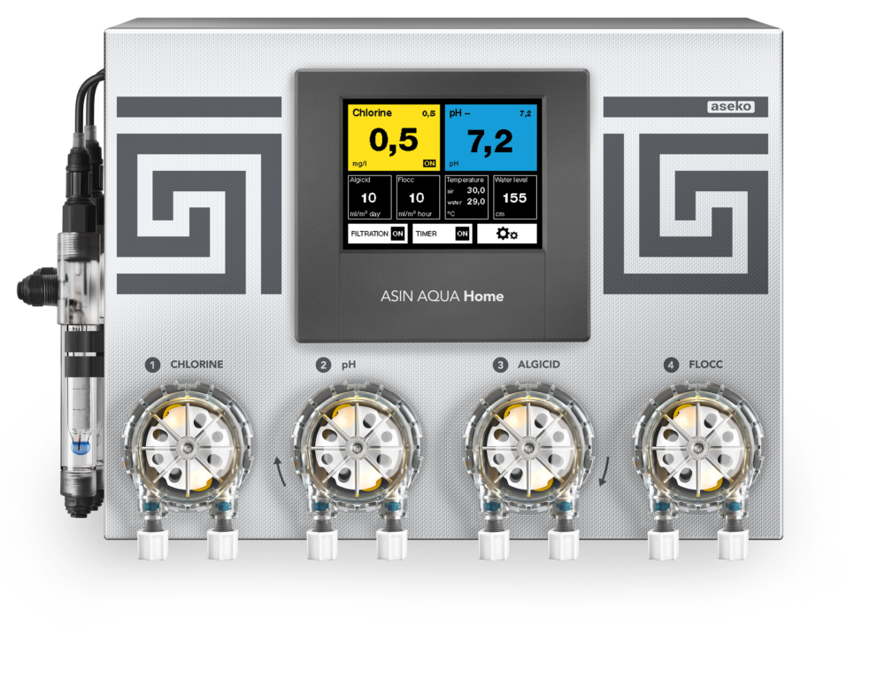

          I am building a infinityppool to a customer and I use a Pressure-type level sensor #12086 https://www.youtube.com/watch?v=DCe_wYQ_BC0
          admin
          ASIN AQUA Home en - Aseko Pool Technology
          DOSING Systems CONTROL Systems Aseko PROBES DOSING Pumps ASIN AQUA Home POOL WATER TREATMENT & POOL TECHNOLOGY MANAGEMENT ASIN AQUA Home The luxury unit with most advanced water treatment features and intelligent system control functions. Exclusive stainless-steel case with peristaltic pumps....
