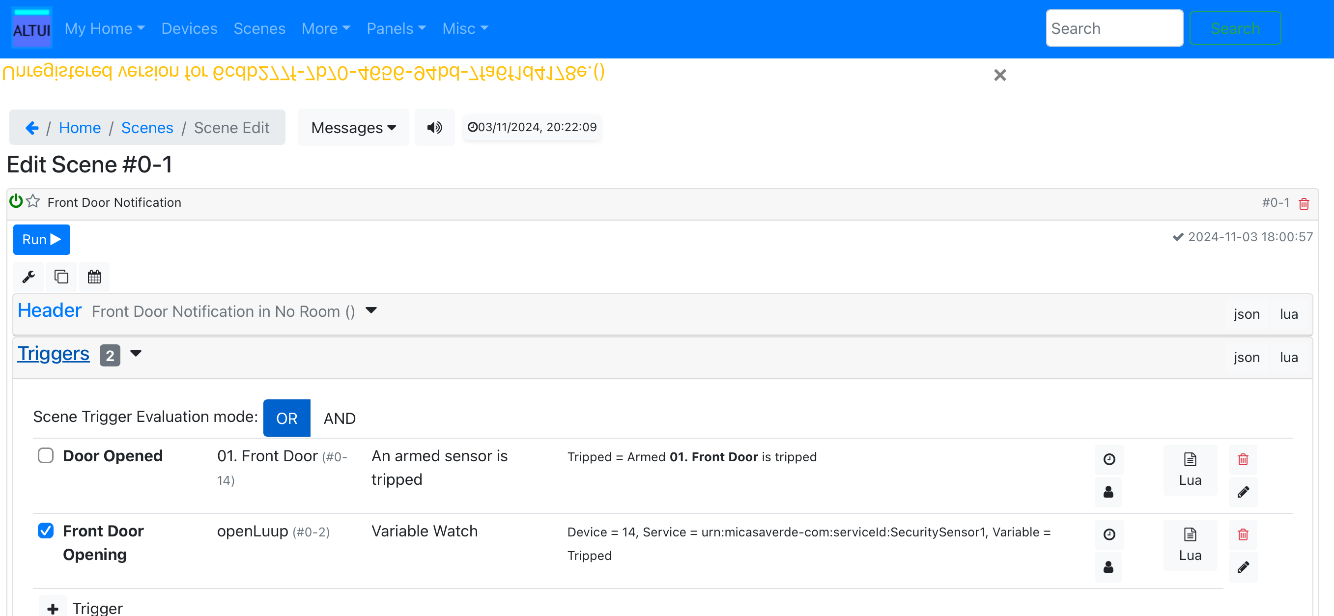

    Sorry if this has been covered before, just curious why triggers in openluup are not consistent..
    I looked at a scene i’d created a while back via ALTUI using the Console view and noticed it didn’t show any Triggers, which was strange as it was my main front door event 🙂 . So I added the door tripped trigger again, but I’ve just noticed I now how two tiggers using this view.
    In ALTUI it shows this.

      FYI, if I go back via the console screen to edit the same scene, it actually still doesn’t show the trigger(s). A bug ?
        wrote on last edited by akbooer
        You’ll note from your first attached image that there are three types of trigger recognised by openLuup:
        1. openLuup Variable watches
        2. AltUI variable watches
        3. Luup UPnP
        #3, as noted in that image, are all ignored by openLuup. This system was hopelessly flawed, which prompted @amg0 to create variable watches (#2).
        When I removed all AltUI dependencies from openLuup (my operational system doesn’t even have AltUI installed) I needed a replacement for those variable watches, hence #1.
        The openLuup watches are recognised by AltUI as a form of #3, because the Vera-compatible data structures are used, in a very limited way, to implement them, and save them in the JSON file.
        So with AltUI installed, both will work (if enabled.)
