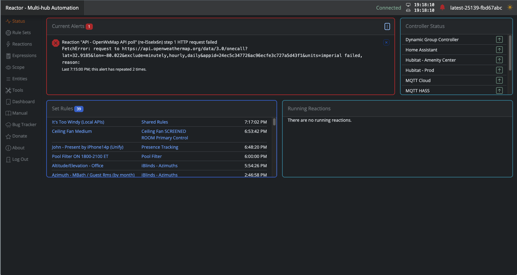

    I foolishly let my system wipe all cookies this morning and with it my settings for my MSR home page.
    Once logged back in I can no longer remove errant panes nor is the + available to add new ones.

                Yeah, that won't do it. Do you see a line that reads "Placing widget at" or "Moving widget-adder to" anywhere?
                  @toggledbits I see the "Placing widget at"
                  UI TIME CHECK: Browser 2025-07-20T22:50:33.935Z offset -240 ; host 2025-07-20T22:50:33.933Z offset(mins) -240 ; diff(ms) 2
                  reactor-ui-status.js:226 Placing widget-adder at 8
                  reactor-ui-status.js:913 saveGridLayout()
                  reactor-ui-status.js:924 SAVE DATA Array(4)
                  reactor-ui-status.js:928 Fixup widget widget3 at x/y 0 0 w/h 8 2
                  reactor-ui-status.js:928 Fixup widget widget0 at x/y 8 0 w/h 3 2
                  reactor-ui-status.js:928 Fixup widget widget1 at x/y 0 2 w/h 6 2
                  reactor-ui-status.js:928 Fixup widget widget2 at x/y 6 2 w/h 6 2
                  Would a .har contain all of this?
                  Just to show I'm not entirely crazy here...
                  *Hubitat C-7 2.4.3.177
                  Core 2026.1.1
                  MSR: latest-26011-c621bbc7
