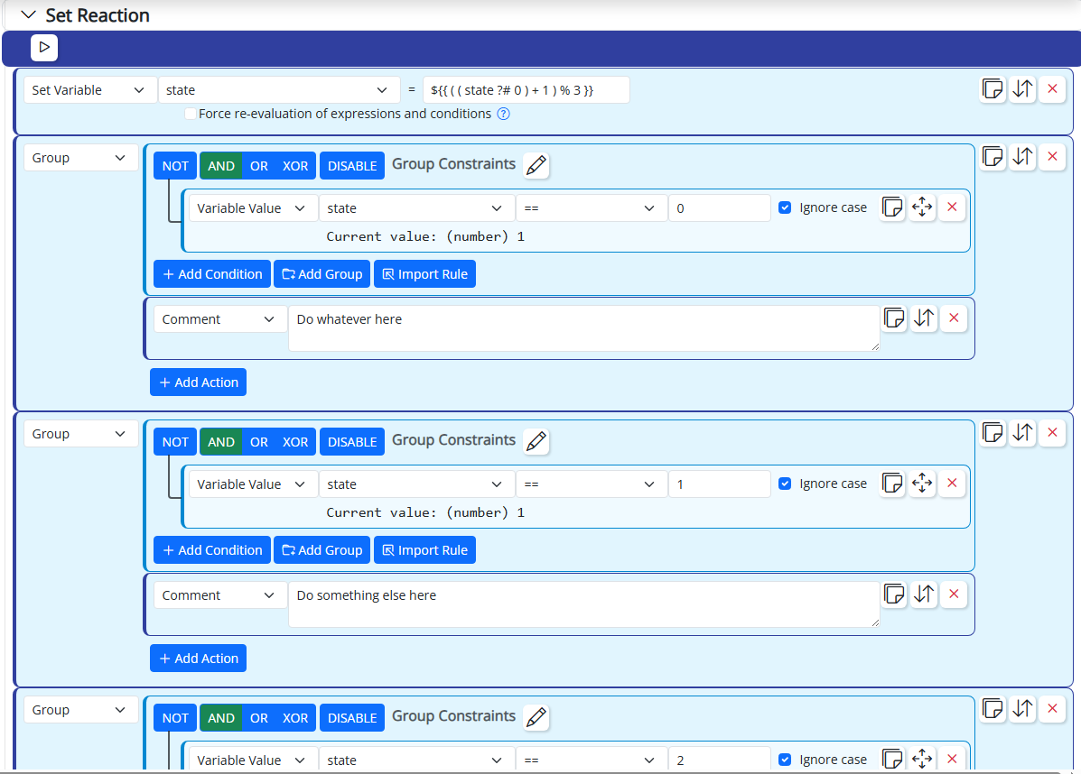

            This looks like a job for a finite state machine.
            An alternate way to tackle this may be to have a state local variable that's just a number/counter that increments when the scene controller button is pushed... Set Variable state = ${{ ( ( state ?#0 } + 1 ) % 3 }}. This will make state cycle through the values 0, 1, 2, 0, 1, 2...
            Then the reaction has these groups:
            • When state == 0: turn both fans off
            • When state == 1: turn 1 on, 2 off
            • When state == 2: turn 1 off, 2 on
            It's easy to add a fourth state if you want the option of having both fans on at the same time. I'll leave the changes as an exercise for readers. DM if you need a hint.
