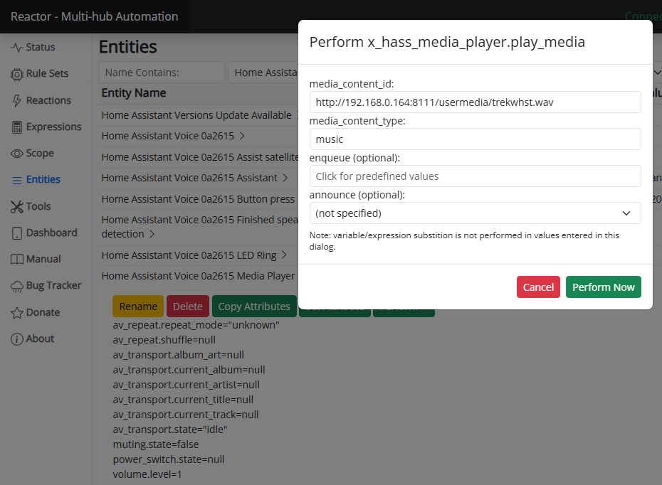

    Starting with the basics...
    Via the Home Assistant Developer Tools UI:
    Select the HAV device on which to play the media. Specify the URL to the media as the media_id. For most media played on HAV units, you'll want to select music as the media_type.
    Via Reactor:
    There will be an entity specifically for the HAV unit's media player. On that entity, run the x_hass_media_player.play_media action. Parameters are the same as those described above. The image below shows a direct run of the action from the Entities list; in a Reaction the action and parameters would be the same.
