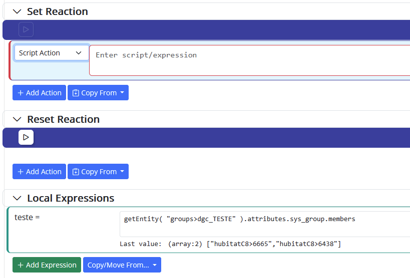

    Use case: possibility of using a script instead of setting up an action in this way.
    If I have a variable that contains the device IDs within the array, could I use a script to execute the powe_switch.on command for the devices in this list?
    I tried to understand in the manual (https://reactor.toggledbits.com/docs/Script-Action/) how to use this script feature, but I was unsuccessful. Are there any examples here in the forum of how to use it so I can continue my development?

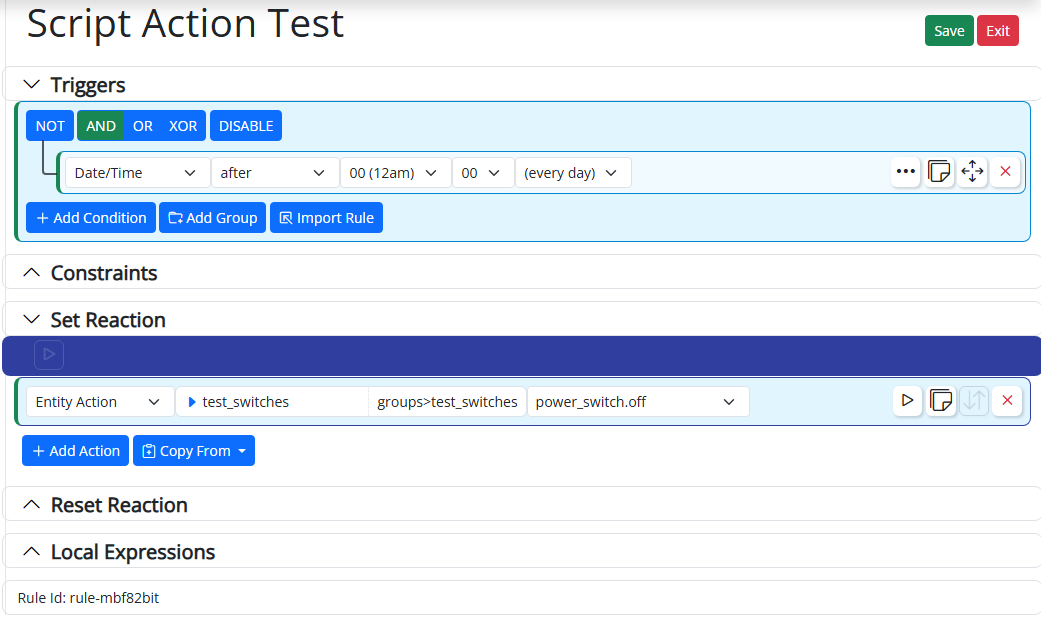

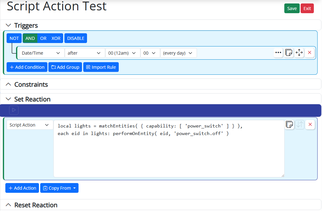

          @wmarcolin said in Set Reaction > Script Action:
          Thank you for your comment, but I need this to be executed by an action already within the routines I program in Reactor.
          @crille is spot on. That's exactly what his suggestion does. Here's a trivial example of what he's saying:
          In this case, I'm not using the contents of a dynamic group, I'm just building a list on the fly using matchEntities(), but the effect is the same. At midnight every night, this rule turns all things that have the power_switch capability off.
          If your listed switches are in a group, either created using DynamicGroupController, or an expression of some grouping the underlying controller has (Vera and Hubitat have groups and Reactor expresses those as group entities you can use), then you can easily modify this example.
          And in fact, you don't even need to do that, because Reactor understands how to do actions on groups, so you can just do one action on the group entity (in a regular Entity Action or by calling performAction() in a Script Action) and Reactor will perform that action on all members of the group (so, you don't even need the each expression construction).

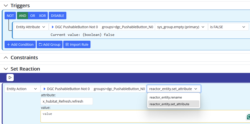

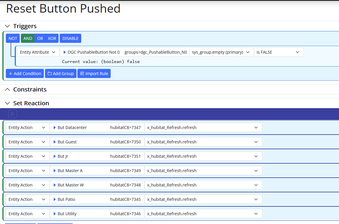

                Now you could help me with this one. I need to know if the button is stuck, i.e., if it hasn't returned to zero, and force a refresh.
                The selection rule is already correct, but now I can't understand how to define the Group Action to apply x_hubitatRefresh.refresh.
                        "dgc_PushableButton_N0":
                          name: DGC PushableButton Not 0
                            - include_capability:
                              - x_hubitat_PushableButton
                            - exclude_entity:
                              - "hubitatC8>2672"  # Alarm Sirene
                              - "hubitatC8>2100"  # Remote Adriane
                              - "hubitatC8>420"   # Remote Quad
                          group_actions: x_hubitat_Refresh
                          filter_expression: >
                            entity.attributes.x_hubitat_PushableButton.pushed != 0 and
                            entity.attributes.x_hubitat_PushableButton.pushed != null
                Could you help me with your experience?
                This is what I want to change.
                Only apply refresh, to the button selected by the DynamicGroup.
                Or in this case is Script that I need to create?
                  Just send the refresh command to the group.
