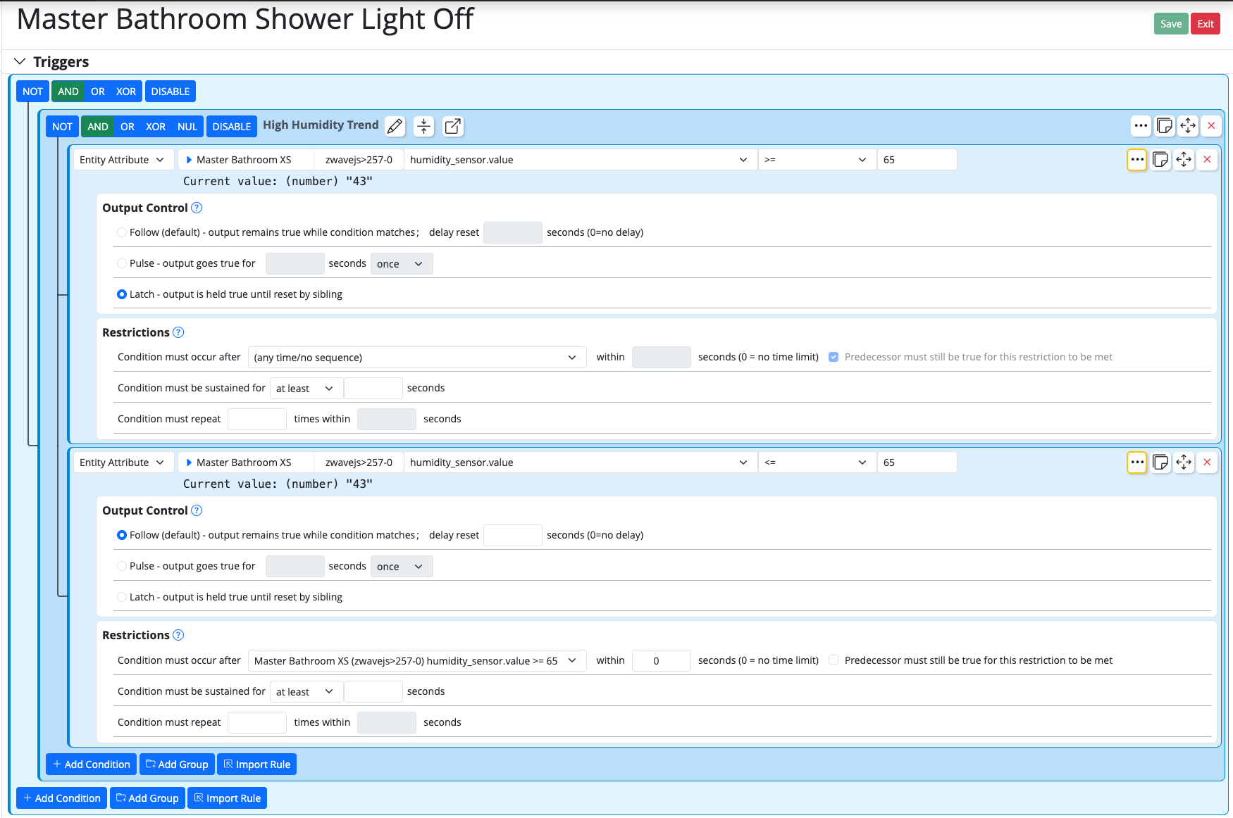

    Is there a way to set a condition for a trending number? I just installed a Zooz ZSE44 Temp/Humidity sensor in one of my bathrooms. I wanted to set a condition based upon how quickly the Humidity sensor reports the humidity level trending down (say after a shower).
    If you look at the graph below from the device, you can see the humidity spiking at 5 am, then dropping, then spiking again, then dropping. I'm trying to set up a condition when the level trends up or down quickly.
      I think I may have figured out a way...
      If I use a Latch condition when the Humidity goes above 60, and then another condition when it goes below 45 (dependent on the first condition being true first), that should give me the result I'm looking for; that being the shower isn't being used anymore, and the shower light can be turned off. Am I correct in my understanding of how Latch works, in that that condition will stay true until the Set Reaction triggers?

            So, for some reason, my Latch method isn't working. I see the humidity go above 70, and I see the first condition go true. When I'm done showering, and fan evacuates the excess humidity, it drops back down and goes below 65, and that condition becomes true.
            The second condition has the restriction that it must occur after the first condition is met.
            I guess the second condition resets the Latched condition, so both conditions aren't true at the same time?
            Is there another way to do a first condition, then the second condition that I'm missing?

                Okay, so maybe I'm missing something or not explaining my train of though here....
                First, I'm not trying to control an exhaust fan, I'm trying to control the shower light. The exhaust fan has it's own built in sensor and . I'm using the humidity to determine that someone is taking a shower, so the light should remain on. When someone stops taking a shower, the humidity will drop (due to the automatic exhaust fan), and then the light can be turned off. I can't easily put a motion sensor in the shower, so the humidity sensor is the logical sensor. I've observed the values before, during, and after taking a shower, and generally, the humidity in that room is 30's or 40's, and when a shower is in play, it jumps up to the 70's or 80's.
                I tried doing it with just one rule, but there really isn't a operand to change below a number. There is Changes from x to y, and then < or <=. If I just have a simple rule to say below 65%, then the light will go off before the humidity level rises. This is why I was trying to latch aspect, because generally when I step into the bathroom, I manually turn on the shower light, turn on the shower, finish, and inevitably the shower light get's left on, whether it's me or my wife.
                I initially thought about the trend/time aspect, but I thought that for this purpose, that is actually over complicating things. All I really need to know is a) did the humidity level rise above point A, and b) did it drop below point B, in that sequence.

                  @tamorgen said in Condition for trend:
                  Important detail.
                  So, from my understanding, you are saying I just need to change the value fo the first condition to >= 65, and the second condition can stay at <= 65?
                  No. Both conditions >=, and you should have a deadband between them. And since you turn the light on manually, the Set Reaction in that rule can do nothing, and the Reset Reaction turns the light off.
                  Your image is now mixing concepts and adding condition options not discussed, not needed. Based on your graph and descriptions, I would go with exactly this (do not add any other features) and see how it goes:
                  1. Condition #1: humidity >= 65, latching output
                  2. Condition #2: humidity >= 50, default (follow) output
                  3. Set Reaction: empty
                  4. Reset Reaction: turn light off.
                  Note that both conditions are >=. This is the way.
                    Okay, thank you. That makes sense…. Other than deadband. What do you mean by that?
                      Deadband... a range of the measurement where nothing happens; but there is usually action at the extremes of the deadband (the low and high values).
                      With the configuration I gave you, it's the range of humidity between 50% and 65%... if the humidity goes only from 40% to 55%, that 55% is in the "deadband" and the rule won't turn the light off if the humidity then falls below 50% (the low end of the deadband) because the humidity never exceeded the high end (65%) of the deadband. But the way the rule is set up, if the humidity does reach 65%, then the rule becomes "sensitive" and watches for the humidity to drop below 50%, and then it will turn the light off.
                      Deadband is also commonly used to refer to thermostats, for example, where it's commonly the small differential enforced between a heating setpoint and a cooling setpoint so that the thermostat won't try to do both at the same time, or bang back and forth between the two rapidly when the temperature is in a small range between those setpoints.
                        Okay, I understand. For a minute I thought it there was a setting I needed to enable. I've set it up and I'll know if it works in the morning. Thanks for all the help.
                        • T tamorgen
                          Update. Worked perfectly. Thanks for setting me striaght!
