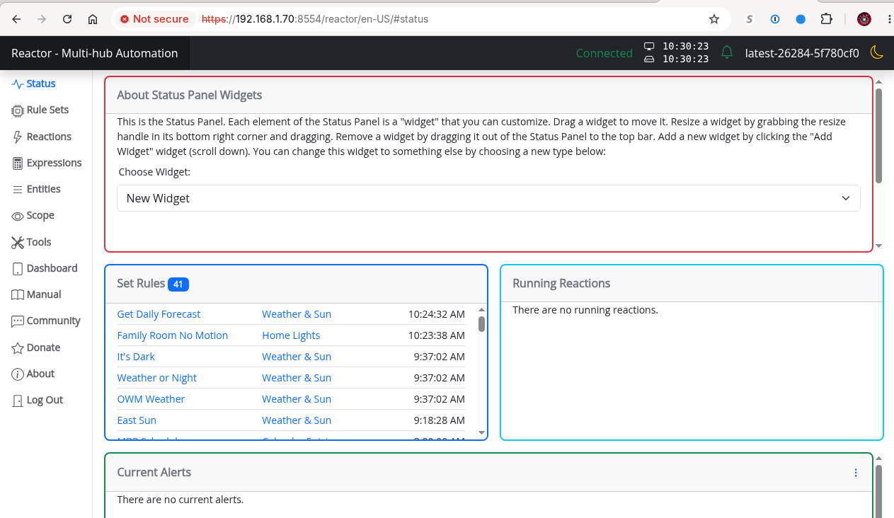

    Good morning all,
    I'm having an issue with the latest version of MSR. I'm unable to get past "Loading Reactor UI..."
    I run a MSR image in Portainer on Proxmox as a Docker VM. This has served me well for about the past 18 months. Previously I ran MSR as a bare metal install.
    To secure and access my local images, I run a Cloudflared LXC and run a Cloudflare tunnel. The Cloudflare tunnel for MSR points to my Proxmox server's local IP port 8554. I've used username/password since it became an option for MSR.
    I've read the notes about new Access control and reverse proxies. I'm not sure that this new feature is what is causing my issue, but this is the only thing I can think of at the moment.
    I also want to point out that if I access the site locally via IP, the site does load properly, albeit with a Not Secure warning:
    Thanks in advance for any advice.

      Okay, I determined the issue. I looked in the logs, and MSR is actually seeing the IP of the source host and denying the entry. I've added the assigned IP of from my ISP, as well as my work network to the allowed IP list. I can now access MSR from my workstation at work, as well as my iPhone with VPN to my home network turned on, and my local network as before. What I don't know about, is if my ISP reassigns my IP address, what I can do about it, as this could cause me to have to manually add that IP address every time it's changed. Historically, they haven't changed it often, but I may have to figure a way out to automatically update the config.

                              It still appears to be seeing the my public facing IP, but it does say "via" the IP of my Cloudflared VM, which is covered in the allowed IP's via the 192.168.1.0/24.
                              Uncommenting the hard coded public IP does work. Unless you can think of another work around, I see one of two options.

                              • T tamorgen
                                @toggledbits said in Reactor Build 26284 stuck at Loading Reactor UI:
                                Restart Reactor. Launch a request from the remote side of the tunnel. There should be messages logged in httpapi.log for that request that say either httpapi#1 starting request from <ip> for... or httpapi#1 starting proxied request from <ip> via <ip> for....
                                If the logged message is the first form, or it's the second form and the two IP addresses logged ("from" and "via") are identical, there is no stable internal (CloudFlare) address seen on the request from your tunnel. This means you can't use allowed_ips (at all) unless your external request address is stable and can be listed in it.
                                If the logged message is the second form (<ip> via <ip>), and the two IP addresses are different, then the second address is the (detectable) inside address of the tunnel. In that case, you would replace the 127.0.0.2 in trusted_proxy with that ("via") IP address, and add pass_all_proxy: true to config/reactor.yaml.
                                Since your tunnel is not a reverse proxy, I suspect you're going to be in the former situation. I'm just hoping to be surprised.

                                I just reread that last part about the different addresses. I changed the local 127.0.0.2 to 192.168.1.73 and restarted the service.
                                # See the Reactor documentation at https://reactor.toggledbits.com/docs/
                                # Template version 22127
                                # Try this browser-based YAML editor: https://onlineyamltools.com/edit-yaml
                                # Here's a quick YAML checker: https://www.yamlchecker.com/
                                reactor:
                                  # baseurl - The base URL to access the Reactor system. If you want to use
                                  #           HTTPS, please see the How-To section of the docs.
                                  baseurl: "https://192.168.1.70:8554"
                                  trusted_proxy: "192.168.1.73"
                                  proxy_baseurl: "https://reactor.xyz.org:443"
                                  pki_certfile: reactor1.crt
                                  pki_keyfile: reactor1.key
                                  # allowed_ips - List (array) of IP addresses/prefixes allowed access.
                                  #               if empty (default, commented out), all IPs are allowed. If
                                  #               you wish to filter (recommended), uncomment the lines below
                                  #               and edit the addresses as needed to match your network.
                                  allowed_ips:
                                  #  - "127.0.0.1"
                                  #  - "192.168.0."  # or whatever your local trusted subnet
                                    - "192.168.1.0/24"
                                  #  - "174.172.AAA.BB" # MY_DYNAMIC_IP
                                    - "169.252.4.16/29"
                                    - "169.253.162.0/29"
                                I am still getting access denied:

                                  SOVLED: I forgot the pass_all_proxy: true line!
                                  Thank you much Patrick!
