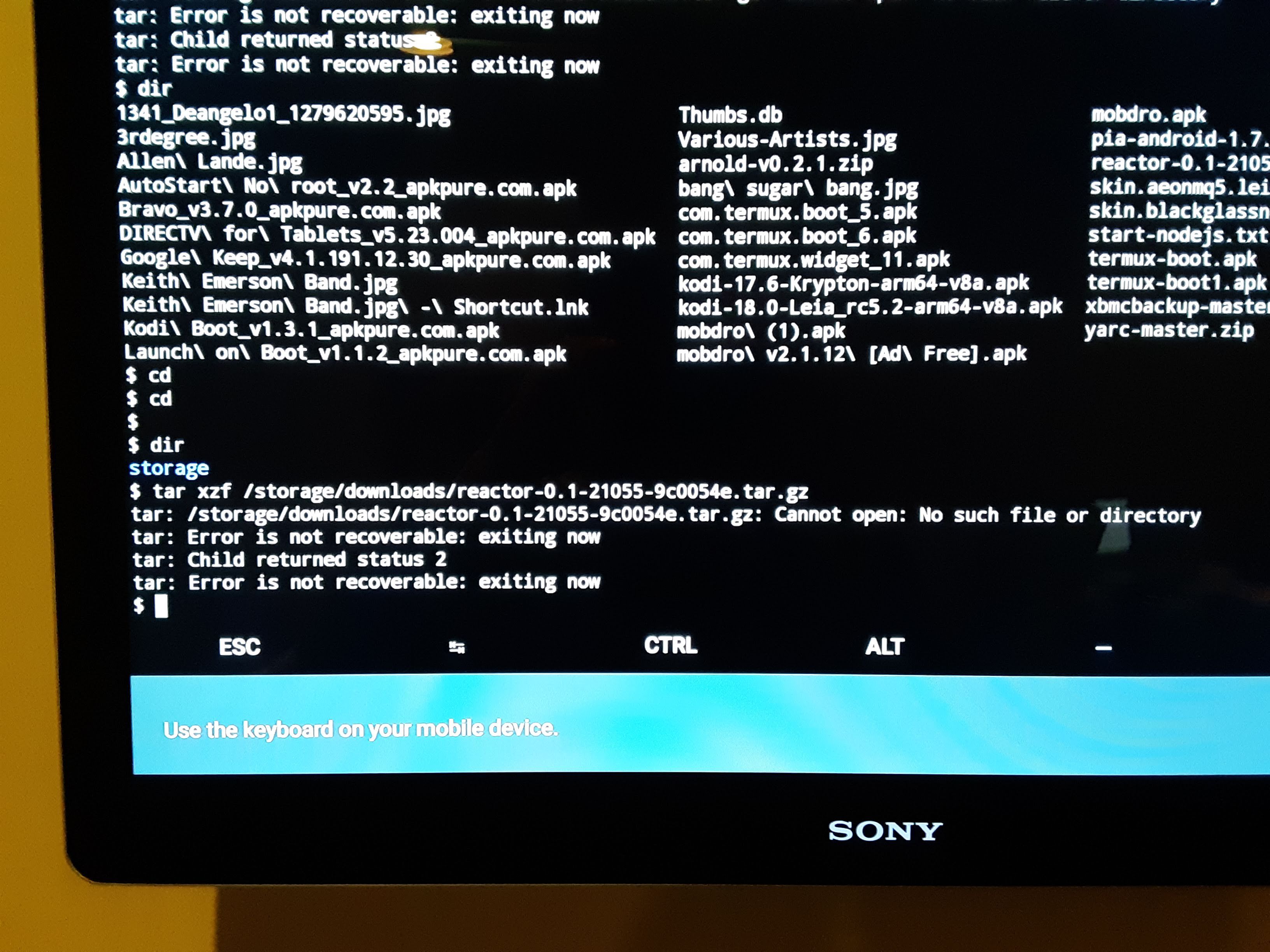

    Trying to install under termux on my nvidia shield. Having a problem unpacking. See attached picture.
      You sure the file name (extension) has not changed? When downloading it, macOS for example decided to take out the gz layer of compression so I was only left with a tar file. Your attachment is not showing the extension.
        Tarkus
        The file name does end with .gz
          Not sure then. tar is just not finding the reactor file. Is the directory correct? I can see storage/ but then downloads? look for case sensitivity also?

            Are you sure that's the correct location?
            mine is /storage/emulated/0/Download/reactor-0.1-21055-9c0054e.tar.gz
            I use x-plore file manager which will copy file location to clipboard

                Tarkus
                @elcid said in Installation trouble:
                Yes while i was able to navigate to storage/downloads under Termux the correct path to unpack was
