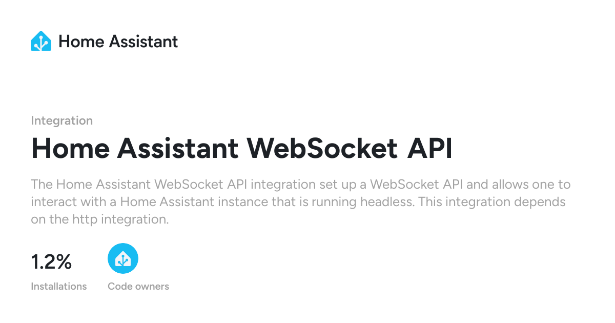

      Make sure you have the websocket API enabled in your Hass configuration.
      Home Assistant WebSocket API
      Instructions on how to set up the WebSocket API within Home Assistant.

              Ref: https://www.home-assistant.io/integrations/websocket_api/
