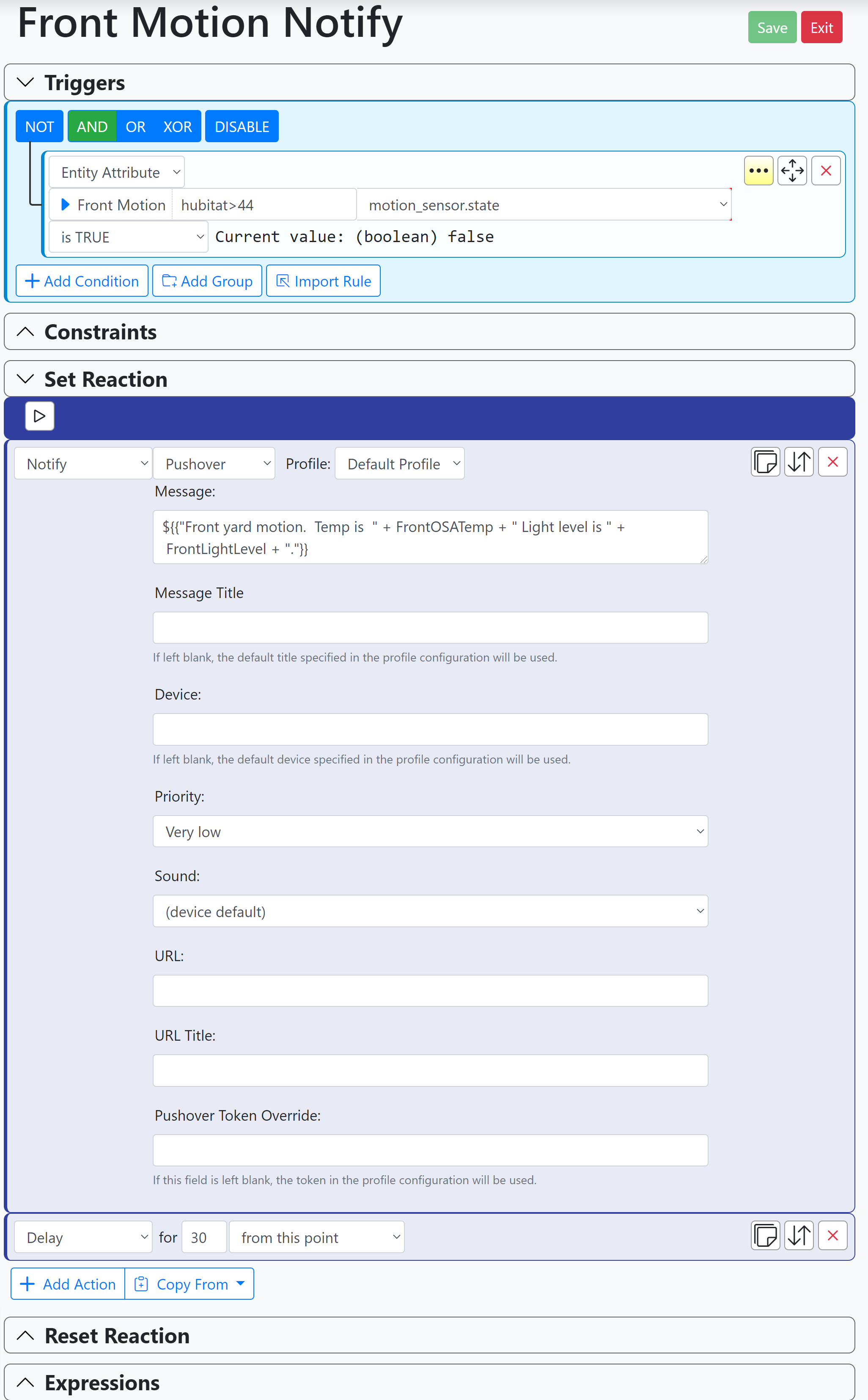

    A sample rule that send the pushover message is:

      @tom_d What is your trigger condition behind the three dots highlighted in yellow?

        in this rule it is:
        Condition must be sustained for at least 2 seconds
        All my Pushover messages are duplicated, not just for this rule.

          Ah, ok. That sure is odd. I have several profiles and don’t use the default in any rule set. Never had any duplicates. Have you tried adding another profile to test with to rule out a bug using the default?

                @toggledbits Today I created a rule with default profile to see if I could reproduce @tom_d 's issue. I was not able to so I deleted the rule.
                Later this evening I got duplicate messages from one of my unedited previously working notifications. My logs have already rotated so I can't find any info there. Have you noticed this issue yourself? I don't know if I have enough info for a PR so just poking this thread again.
                  wrote on last edited by Crille
                  It's really an intermittent problem. All my notifications were duplicated until I today switched to run MSR as systemd. I did not edit any rules/reactions or the notification.yaml and now I only get one per rule as expected. Could be the restart itself that solved it...
