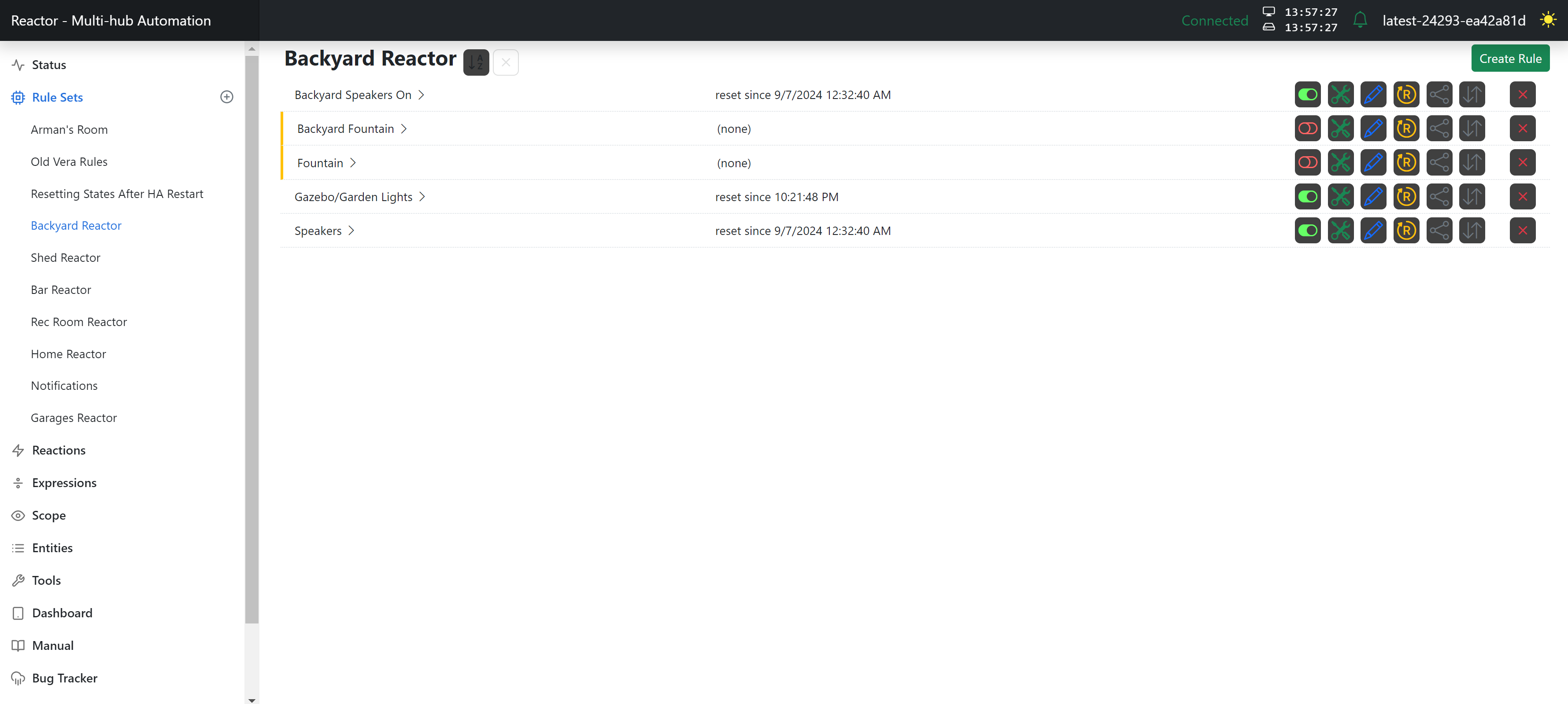

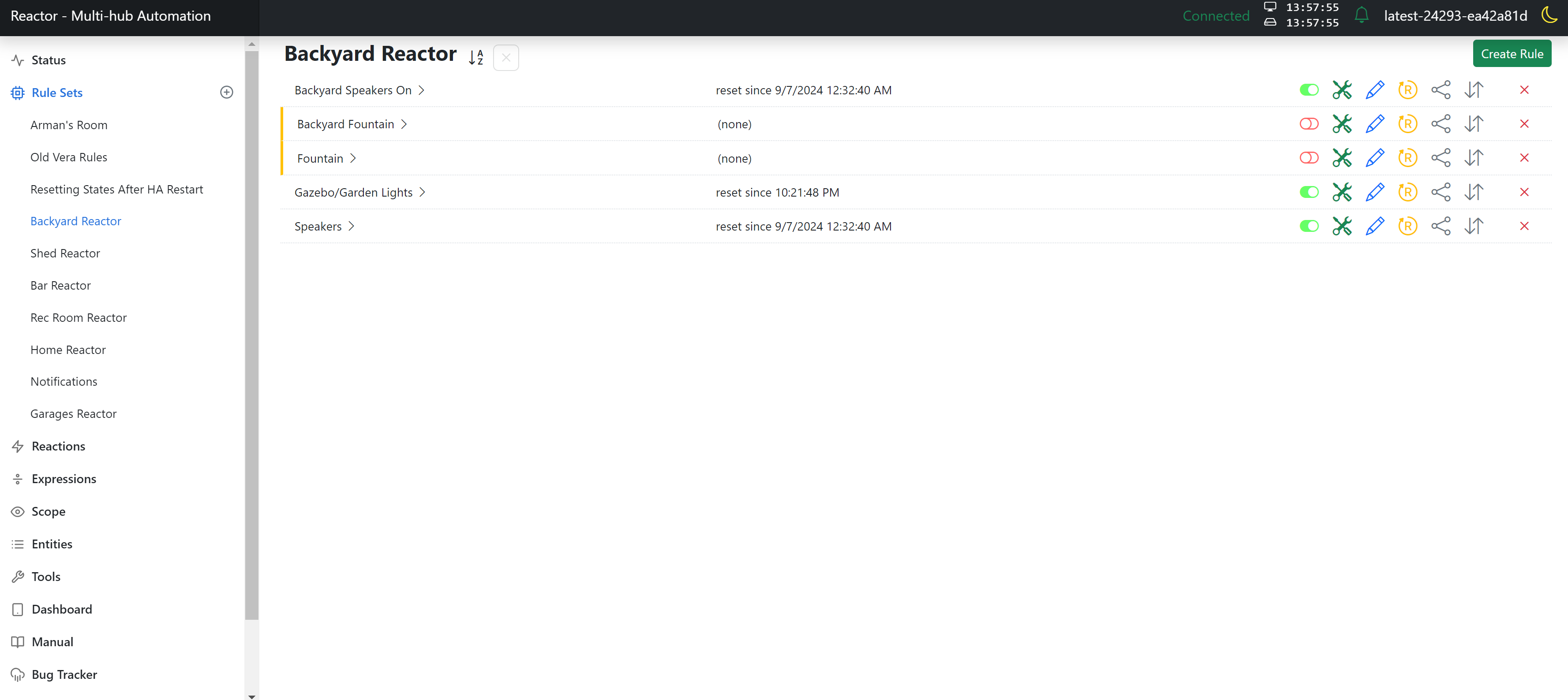

    Seems like switching the UI to the newly added dark mode (thank you for this) does nothing. The UI stays in light mode and only a few buttons turn into dark mode (see screenshot)

    3df2806f-9146-485b-9ec1-d056e91cefe5-image.png Dark mode enabled
    ff823023-c079-4684-b01f-d6ac6527d31a-image.png Light mode enabled
      OK. Check to make sure you've done all the npm updates/installed (see the warning in the release notes).
      Second issue is that dark mode on Ubuntu 24.04 is known to have issues (it's a platform issue, not a Reactor issue). Check from a browser running on another platform. This works for me on every browser I'm able to test, but Ubuntu Desktop isn't part of that. I can also see that at least one other user is successfully using dark mode.
