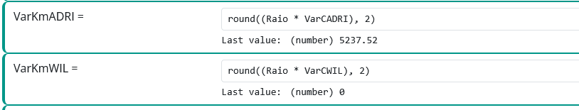

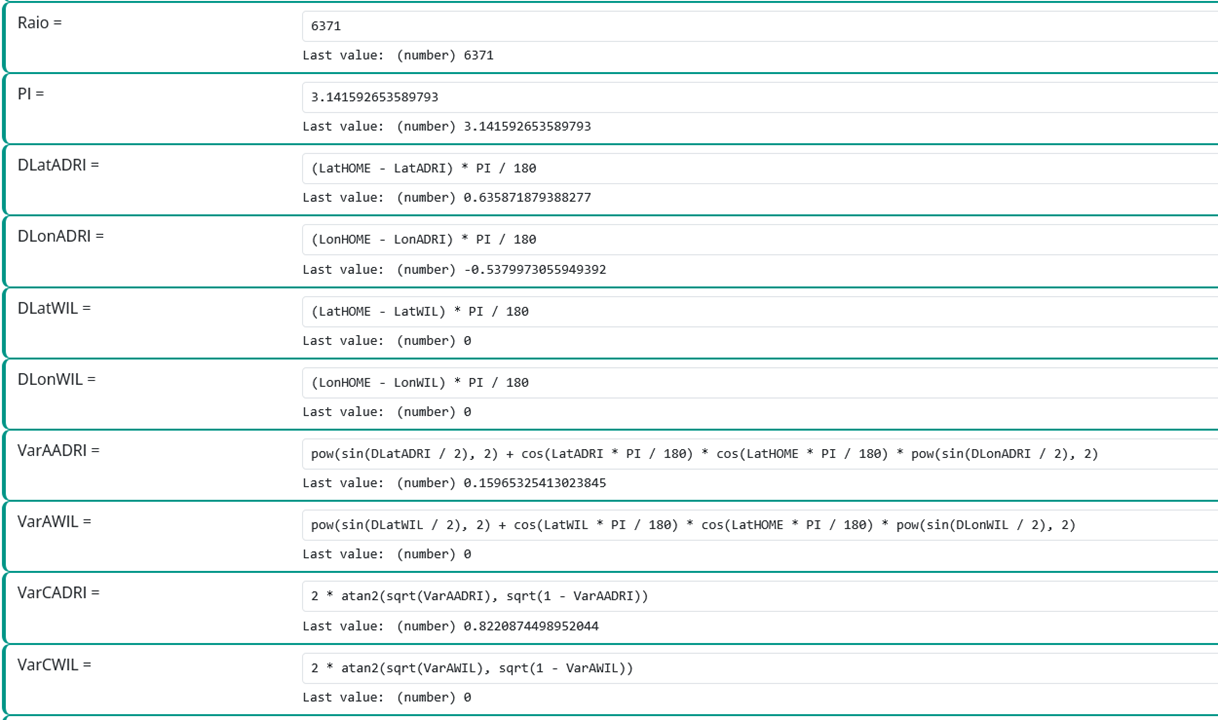

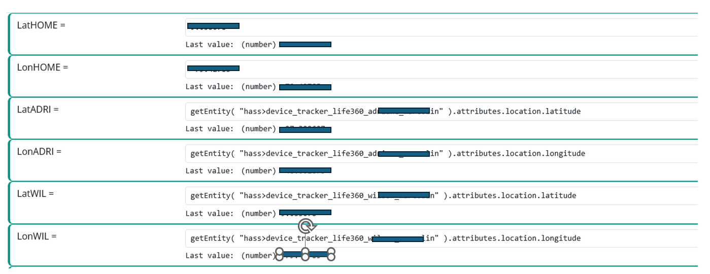

                While you're at it, could you add to Santa's list a request for a function that, when given two coordinates, returns the distance between them?
                I'll explain the use case: when Life360 worked on Hubitat, one of the variables was precisely the distance between the device and the point determined as the home. However, as I said, it hasn't worked for a long time.
                This was one of the reasons for installing Home Assistance, which works perfectly, but it doesn't have this information, so I had to do the calculation.
                I know, you're going to say what a horrible thing, what a mess, but it's working.
                I prepared a series of calculations, using the coordinates of my home as a reference, for my phone WIL and my wife's phone ADRI. The phone coordinates come from Life360.
                Next, I have the calculations.
                So, I have the result.
                I used this formula Python.
                from math import radians, sin, cos, sqrt, atan2
                def haversine(lat1, lon1, lat2, lon2):
                    R = 6371  # raio da Terra em km
                    dlat = radians(lat2 - lat1)
                    dlon = radians(lon2 - lon1)
                    lat1 = radians(lat1)
                    lat2 = radians(lat2)
                    a = sin(dlat/2)**2 + cos(lat1) * cos(lat2) * sin(dlon/2)**2
                    c = 2 * atan2(sqrt(a), sqrt(1 - a))
                    return R * c  # distância em km
